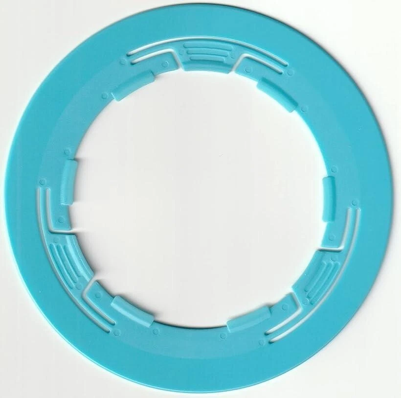

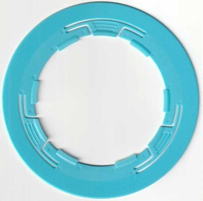

ive seen these mini cd to standard size cd adapters, maybe i can bundle that in too if i ever reach the finish line.
View attachment 548138https://www.ebay.com/itm/145647101089
I haven't seen an adapter like that since I was using one to play old 45's on a regular 33 LP vinyl record player!

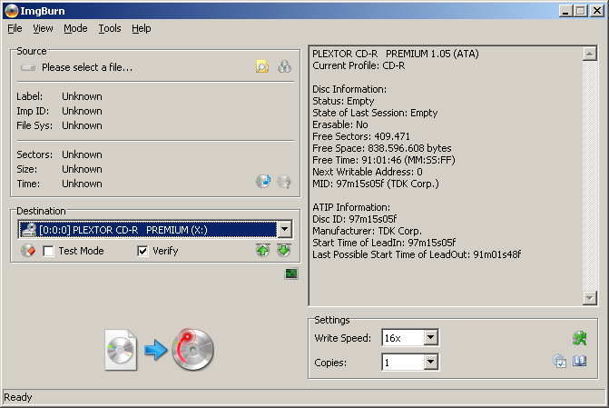

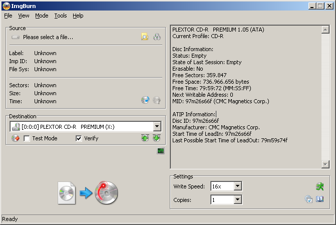

Welcome to another lengthy Sinchen post. I just can't resist doing some tests again…
I have to correct my previous statement: At least a PlayStation 1 with good condition drive is able to read relatively reliable from high capacity CD-R. After trying a 90 minute CD-R in my SCPH-9002 for some minutes, including randomly selecting titles and fast forwarding, I searched for a music CD with about 100 min.
The result surprised me. I noticed one single instance of (wrong/bad) interpolation indicating a read error as well as very brief pauses between some titles. Listening for almost 100minutes with full concentration is out of my range, so I might have missed some tiny errors. The one interpolation error I noticed was very subtle. Either the PS1 read the disc almost perfectly or the audio interpolation is outstanding.
For a worn PS1 drive the results are less convincing. My SCPH-1002 – which requires maintenance – detects and starts playing the disc. But it skips just because walking next to the console. Selecting titles near the end resulted in strange noise and the disc stopped.
The limited test shows that a PS1 is able to follow the narrow track and can address sectors above 89:59.74. I can’t test beyond the magical limit of 99:59.74 which crashes many devices. My custom Beatles “1967-1970 / Blue Album” on one CD-R has under 99min.
What the limited test does not show: if a game disc with narrow track would be readable in reliable manner. For game loading and video playback the drive goes to 2x speed and games require frequent random searches. Read errors for program data are fatal. They requiring retries opposed to merrily continuing after an audio glitch the listener might or might not notice.
I will burn a backup of a game with voice acting and full motion video on 100min CD to test if it is acceptable, but obviously I can’t test access beyond 71 minutes since there are – by design – no bigger discs allowed officially.
What we would need is a homebrew app implementing a subset of Nero DiscSpeed for testing sequential reading and access times for random searches on inserted CDs. That would be helpful not only for non-standard discs, but also for more objective quality/compatibility control of various CD-R.

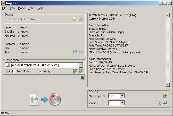

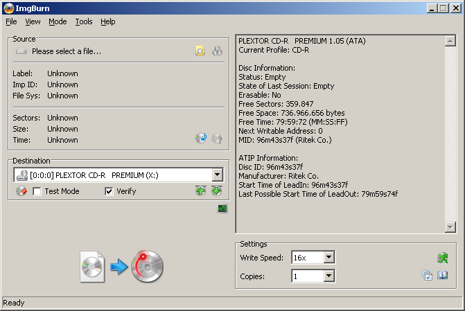

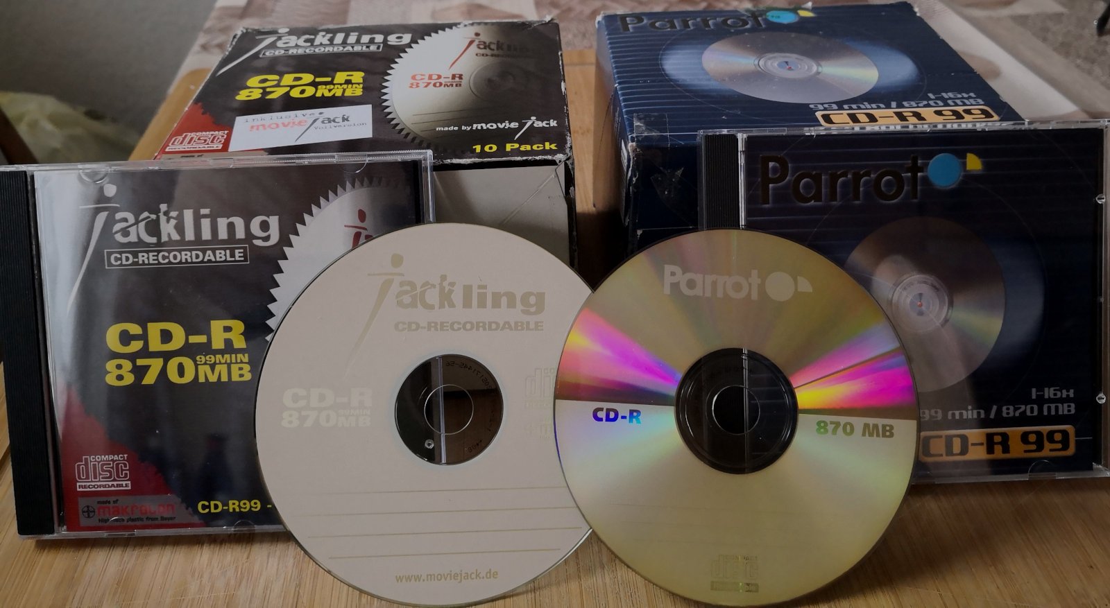

Here are pictures and ATIP data of some high capacity CD-R
"Jackling" → intended to convert DVD movies to (S)VCD with the Movie Jack software (became illegal shortly after being published – sadly the software was not present anymore when I found the old package on the flea market.
"Parrot" → No idea what this is. It looks like some CDs. There was no parrot in the box.
Both can be overburned to 99min but both kinds showed failures at the outer most parts

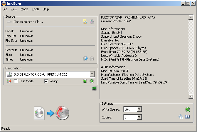

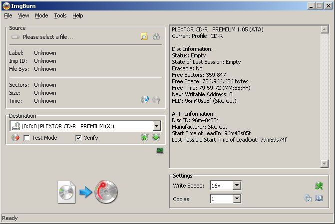

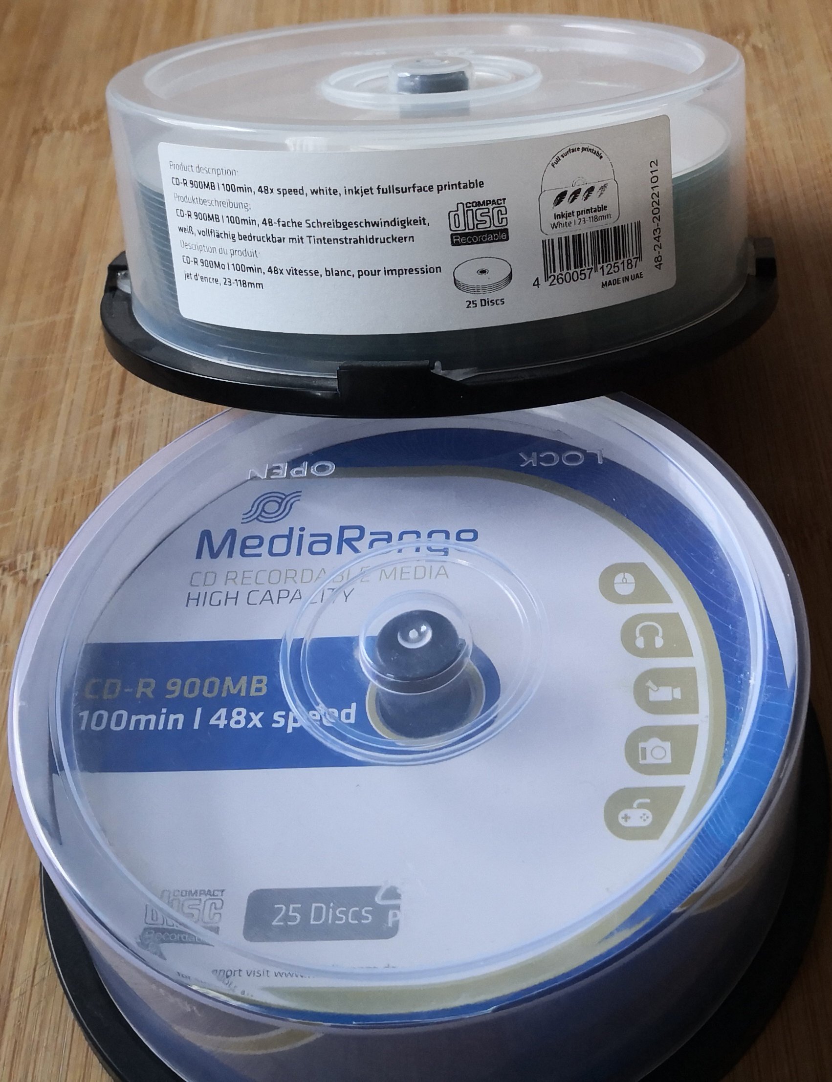

Two different kinds of 100min CD-R labeled Media Range. Still available new, cheapish. I have almost 100 of the inkjet printable kind → ready for testing.
Both kinds can be burned up to 100min. Some discs worked when reading the outer most part, some not.

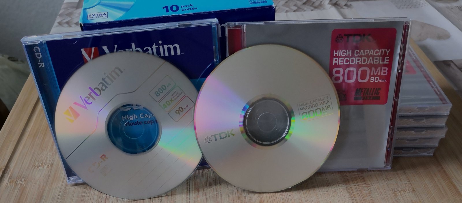

Verbatim, still available, cheapish.
TDK Metallic. Non-standard ATIP advertising the capacity of 800MB/91min. No overburn function required to make use of the full capacity. Since this violates the standard, some burners detect the CDs with a puny 11 minutes (overflow at 79:59.74) instead. Very high quality discs.

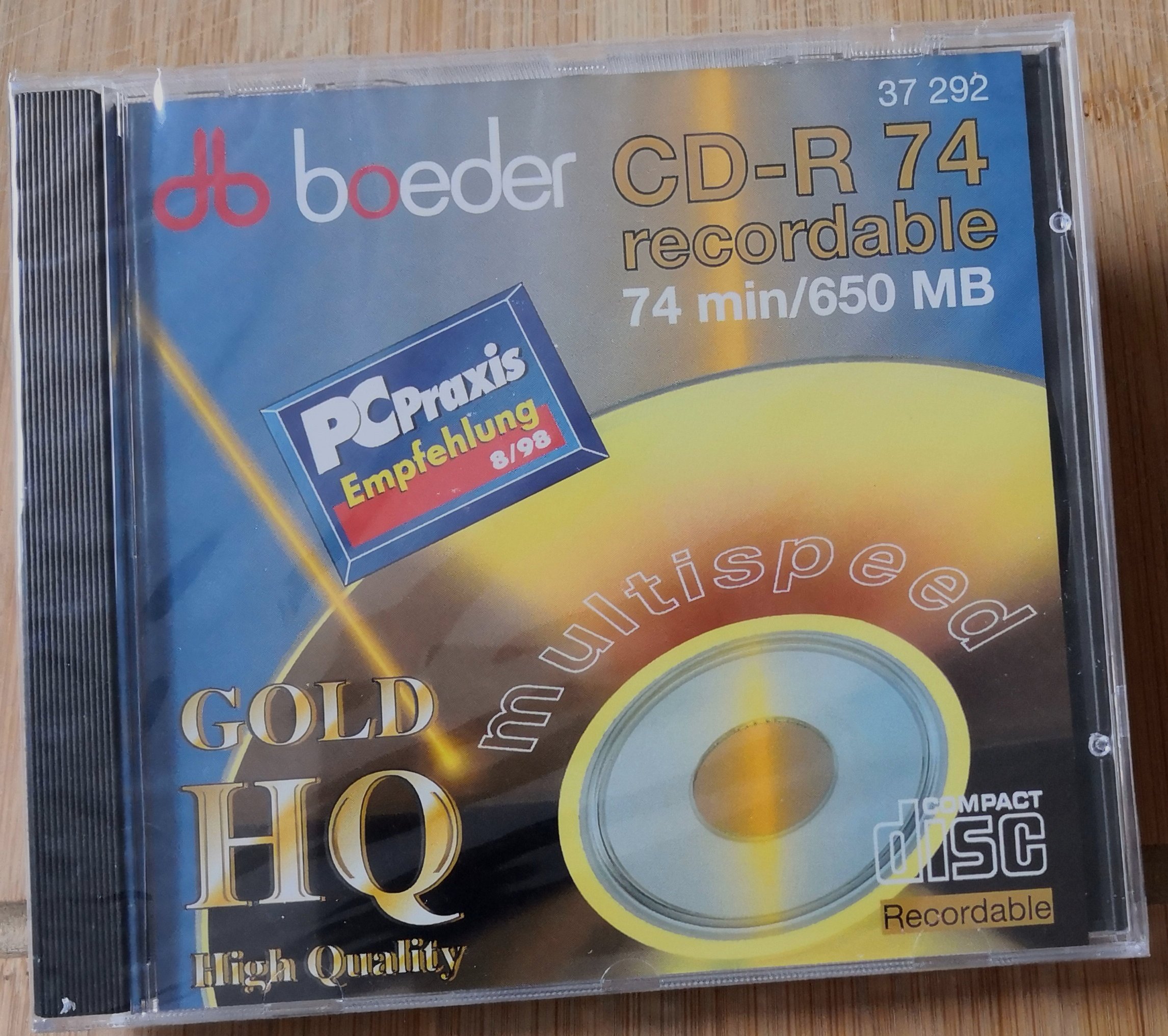

Lastly when not considering a non-standard storage medium as "selling point", these 74min CD-R perform almost as good as pressed original PS1 games.
I've used one of these for a PlayStation backup. The result had just four(!) C1 errors across the whole disc when checking with Nero DiscSpeed. These things are rare and expensive, but they would be excellent for distributing a homebrew game.
thanks for the comprehensive tests. it's cool you got different brands, the only one i can find thats still available today is mediarange. i figure i should try to get as many different brands possible because i know for regular ps1 burning, some brands dont work. but these days 100min cdrs are pretty rare.
as for testing homebrew, my initial video is actually a combination of 3 separate games, RPG Maker, Raiden Project and Mike Tyson's Punch out via imbnes. i modified RPG Maker to launch external exes via the text box. So my idea was to bundle multiple games and have like have a arcade room where the character can launch different games.
there is a homebrew by lameguy called Meido Menu which lets you add multiple games on one disc
might be worth checking out if you wanna try burning a game discs that exceed 650mb

Ok I seriously question this because you’re using an audio track. With a data track there is a fatal flaw in tracking the sync header which audio tracks lack. Sony knew about this in at least early 95. The issue always was MASSIVE seeks from say sector 25 where system cnf is to say sector 300000 where the PSX executable was which system cnf told it to go to was. The higher density media was just too dense to make the approximation expected for lower density to not overshoot and cause the drive to lock unless you added an immense amount of dummy data. In your test some of the audio data is acting like a band aid. If it was completely unburned data the drive would get completely lost and lock up.
The PSX drive is stupid. It thinks anything is 71 minutes disc. Because sectors are longer on 71 minute discs then 74, 80, 90, or 100 exponentially it gets the distance to move the laser more and more wrong. It basically makes a best guess where sector xyz would be from the spindle if it was a 71 minutes disc. If it is a 71 minute disc (like a real pressed cdrom PSX game disc or developer disc) then this is pretty accurate. But sectors get a hell of a lot smaller the more and more the density goes up. And gets to a point where it just straight up seeks inches past even the last part of your disc that has burned data is. And when the PSX reads unburned data it looses its mind and shuts down forever until you power off
If you want to prove this, go ahead and burn krushi pal on a 100 minute CD-R.
not sure if Meido Menu uses a Audio Track but my method is using mkpsxiso which is rebuilding a ISO so it's still one data track. basically rebuilding is like when you rip a game's contents, and you add additional content on the disc, IE a second game that you also ripped, then combine them all together into one ISO by using mkpsxiso to build it
it dont have to be a secondary game, it can be appending more data, like in my RPG Maker example, i added additional BGM music by appending more seq+vab BGMs at the end of the SOUND0.BIN file. you can add additional EXE demos, games, images, or any files you like.
as for any risks, meh i dont mind. it can blow up my PSX, im not really concerned about any risks. i like to experiment
