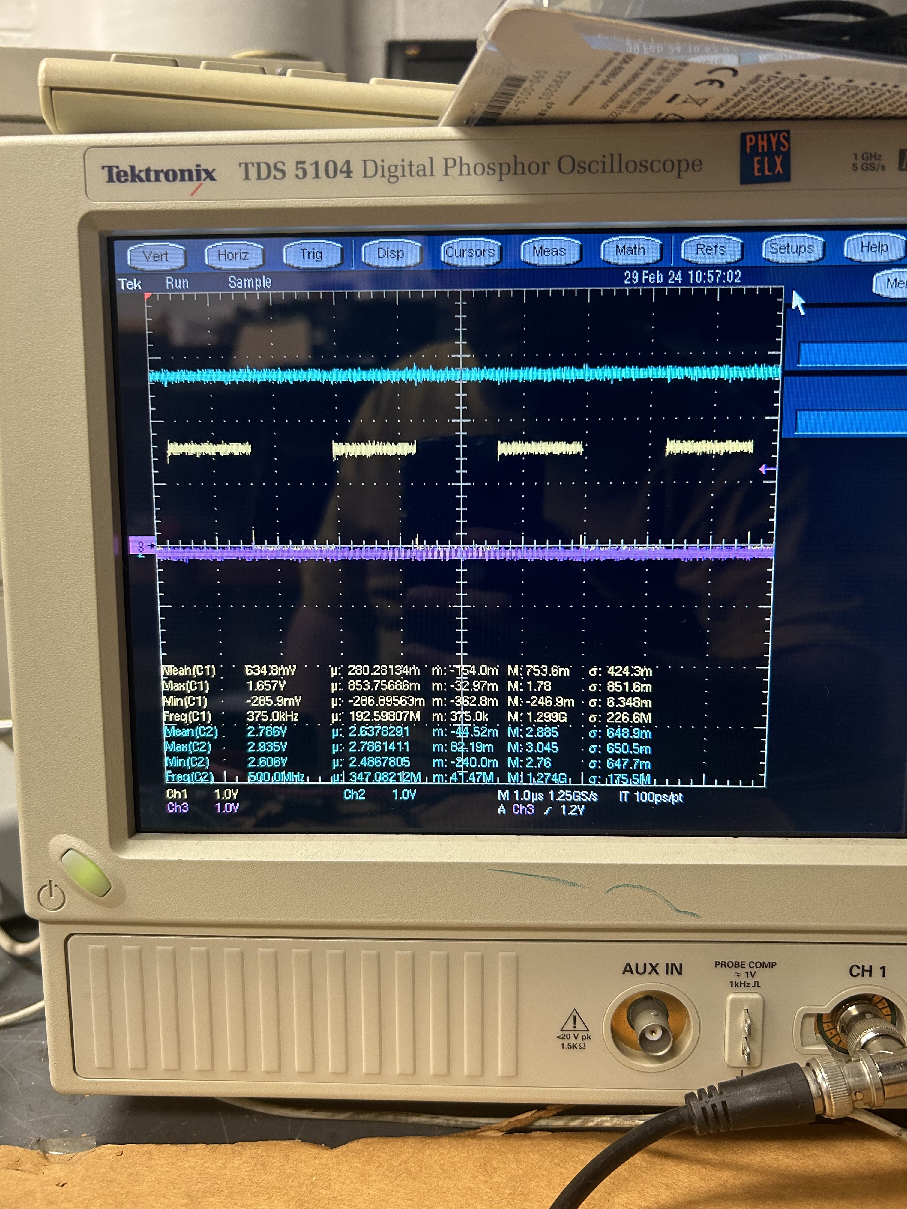

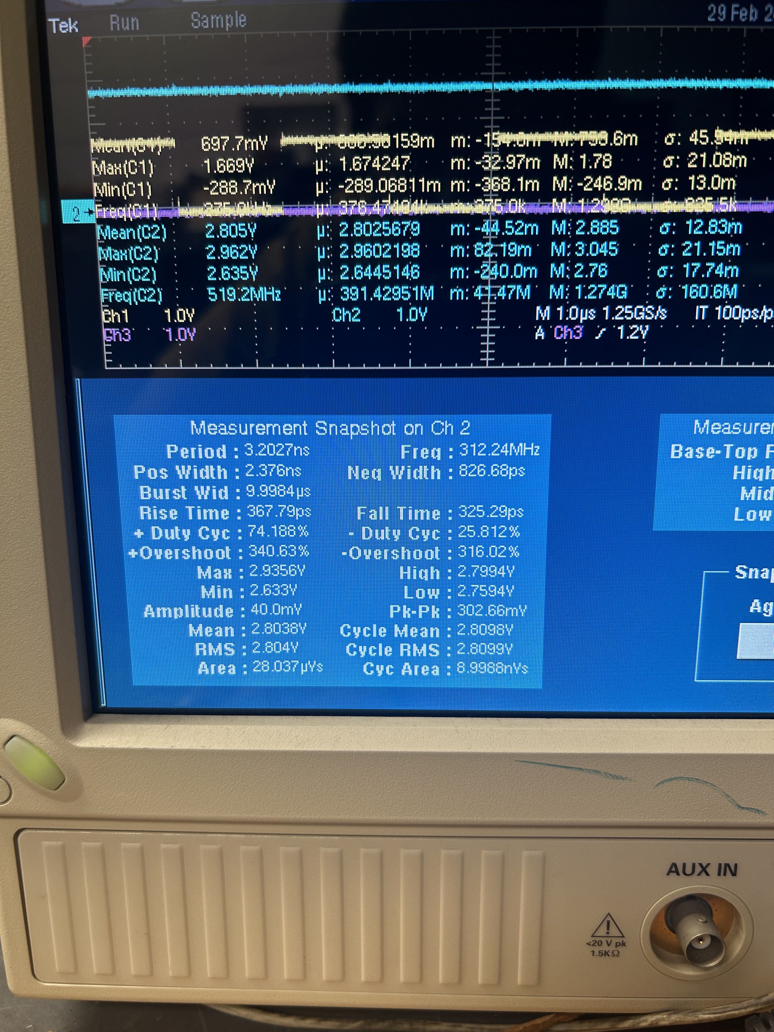

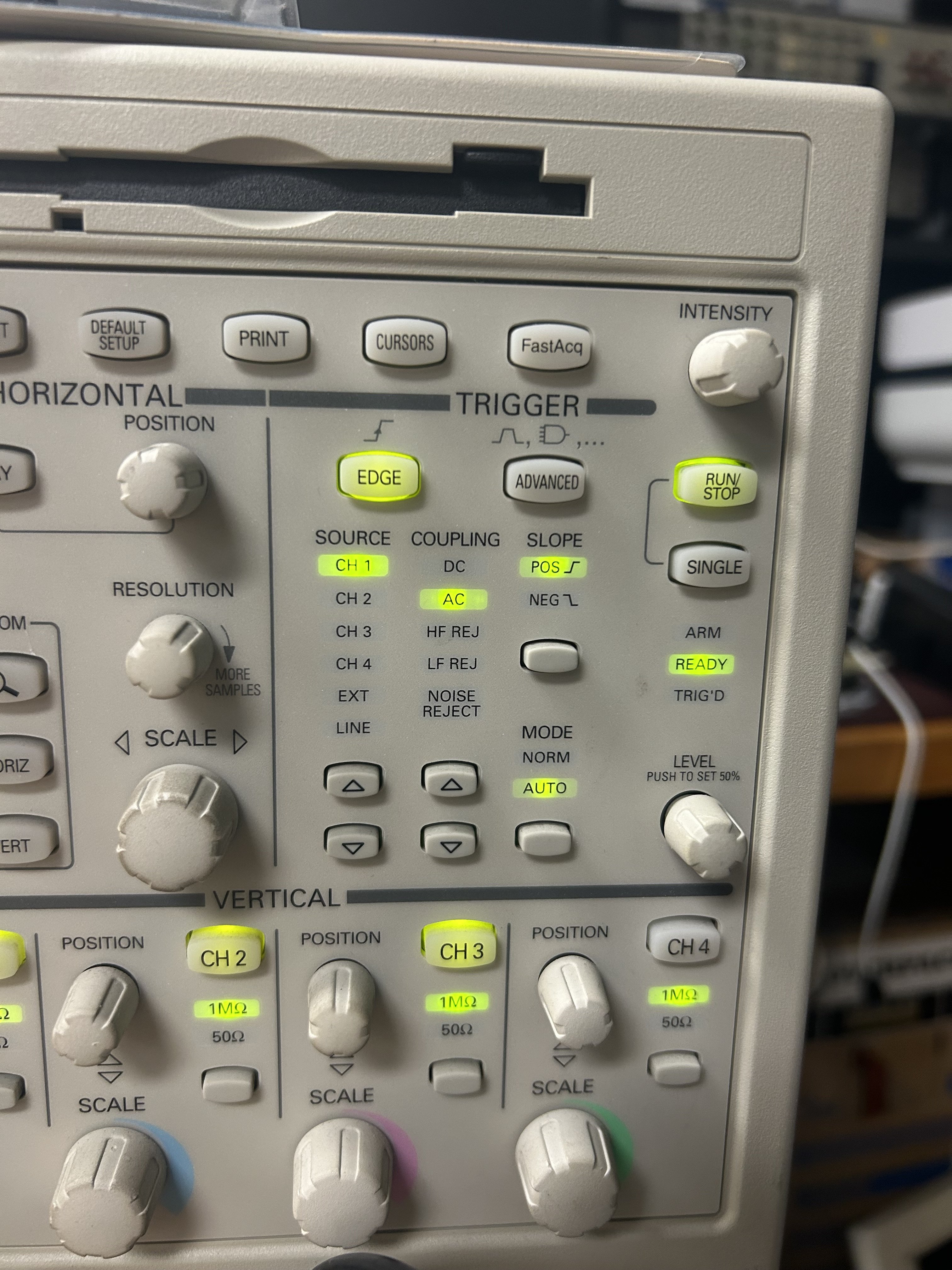

I’ve been pretty busy these past couple of weeks, hence the lack of updates, but today I was able to set aside a little bit of time to use the oscilloscope. I fiddled with the trigger and was able to see a signal from CMD this time by setting the trigger edge to 0 V. I tried other voltages but always got essentially the same results, so that leads me to believe that perhaps the trigger wasn't activated at all. In any case, CMD immediately goes to about 3 V upon turning the Wii U on and it stays there. Frequency also seems to fluctuate. CLK looks the same as before. I tried probing D1 but I was unable to see a signal from it even after trying several different trigger settings.
I've included a couple of pictures, including the trigger options on the oscilloscope for clarity on what I'm dealing with. Channel 1 (yellow) is CLK, 2 (cyan) is CMD, and DAT1 is 3 (purple).
One thing I do want to mention is that after setting up all the probes and setting the trigger, the first time I turned the Wii U on, CMD was doing some interesting things. It didn't seem to have a defined shape and would shoot up and down in voltage and frequency. It eventually stayed at 3 V. Unfortunately I didn't capture this and was unable to replicate it. I think this goes back to our theory that it works better when cold, thus why it acted this way on my first attempt. I tried letting it cool for several minutes but that didn't work, so perhaps it's really sensitive to temperature, unless maybe there's some capacitors that need to discharge over time?

3V3 is the idle state for CMD. When you saw it changing that's when it was doing something. You would need to trigger in the falling edge.
Maybe there is some fluctuation, while powering up, which causes it to trigger too early.

Update: I went back and tried capturing the CMD and DAT1 signal again. I did a bit more reading on triggering and I think I got a better idea of what I was done and what the purpose was. It looks like the trigger was set to auto all the previous times I did it which could explain why I was having a hard time capturing the signal. Unfortunately, I was unable to capture anything new with either the CMD of DAT1 lines. The same thing happened with CMD last time where upon first starting up, CMD would jump up to a voltage and then go down. It repeated this several times until it eventually reached 3V where it proceeded to stay. After that I could not capture anything noteworthy. If I tried triggering on the rising edge, I would just get a flat line at whatever voltage the trigger was set to as long as it was between 0–3V. As for the falling edge, I was unable to capture the signal as it seems there was no falling edge to capture in the first place. The signal would just stay at 3V. Also, as before, I saw nothing on DAT1 (CLK still looked the same though).

Did you set the trigger on the falling edge? Maybe you have to enable the trigger just a second after turning on the Wii U (because when turning on there might ba fluctuations). Did that trigger trigger and it recorded something or was that just never triggered?

I tried both falling and rising edge. I initially started with falling edge before messing around with rising edge because the trigger on falling edge never triggered. I suppose it's possible I somehow missed it, but I tried several times and just never could record anything of note. If I brought the trigger above 3 V and then back down I would capture the CMD line stable at 3 V, but that's not really useful for us.

ok, if it never triggered at falling edge, then something is very wrong. You say it just stays at 3V3? So either the controller is dead, or you have a short somwhere pulling it to 3V3. Can you measure the resistance to 3V3? And also measure the voltage with a multimeter, when it is connected to power, but not turned on.
