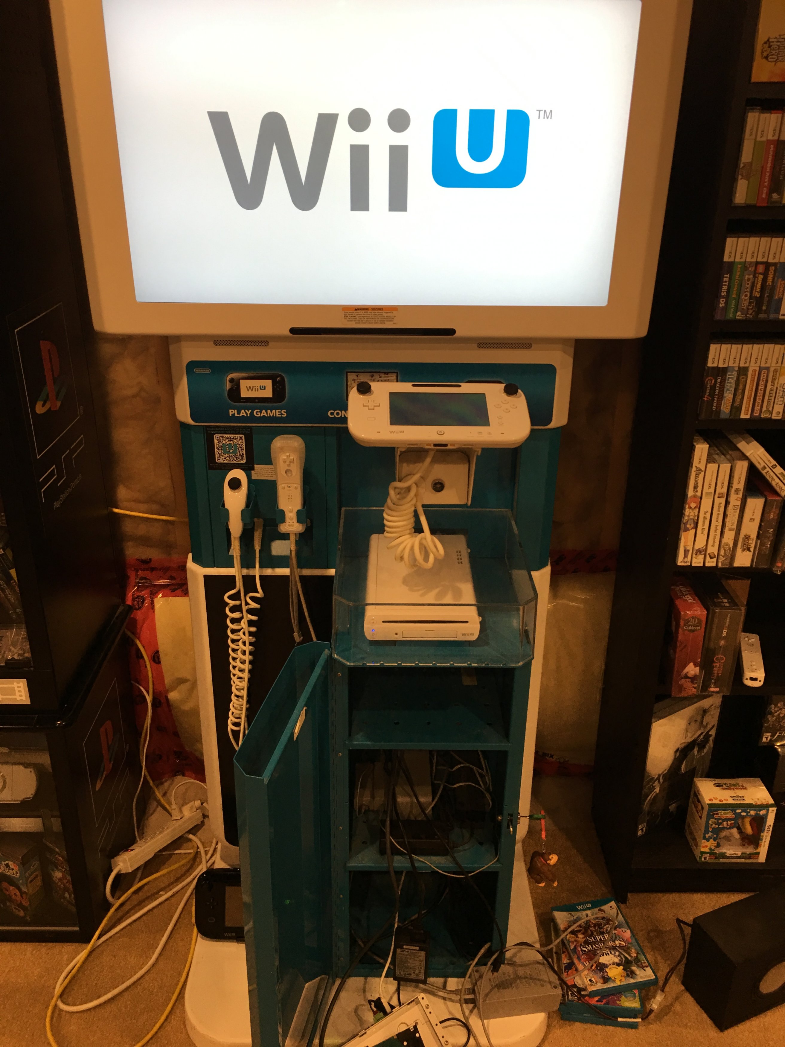

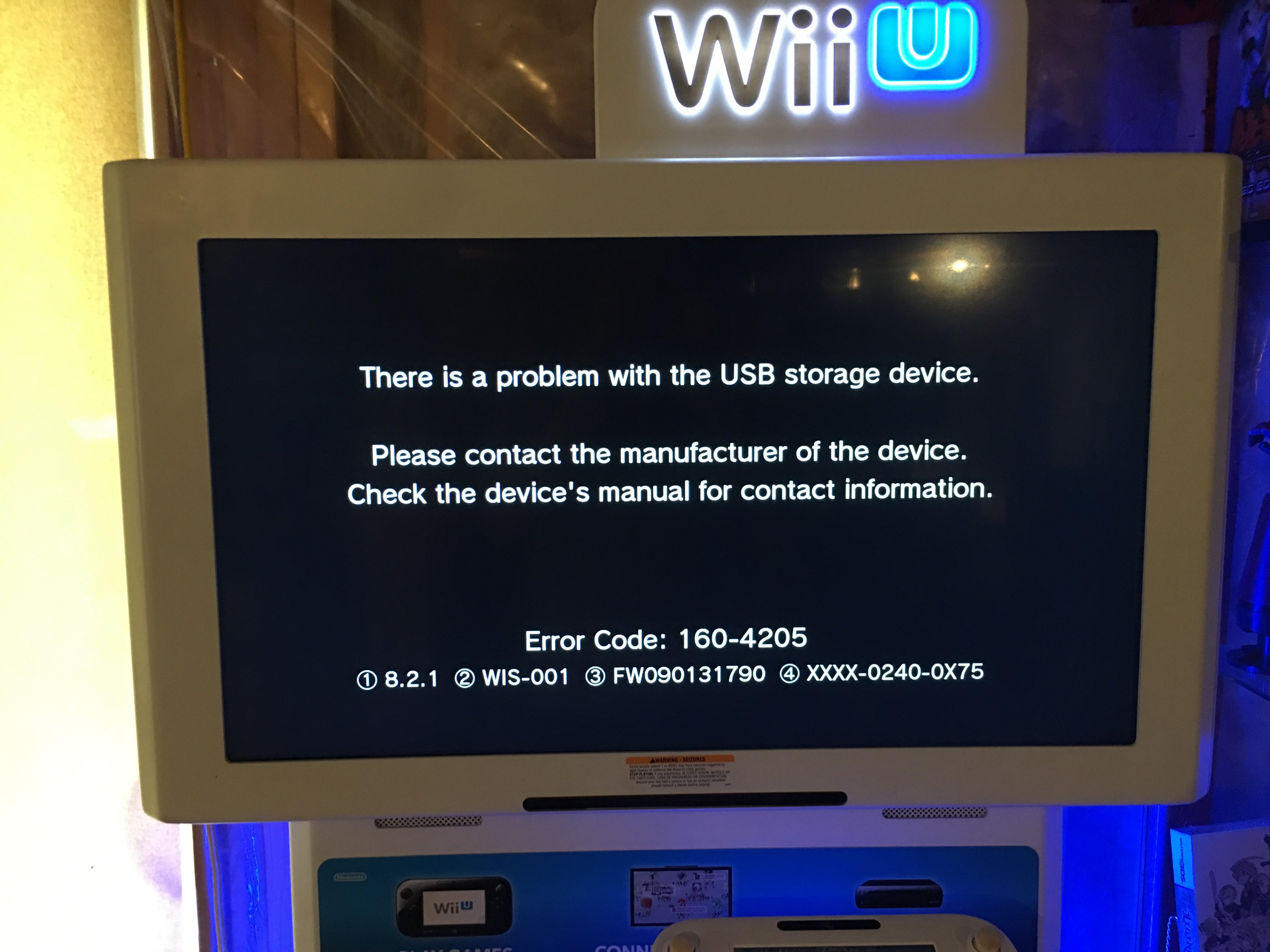

I've been searching for answers for two years with no luck, thought why not ask here. I came across a Wii U kiosk in 2017, it came out of a store that had closed shortly after the Wii U launch. It has a demo console that appears to be PC based, and works/looks like other demo consoles I've seen. It has a bunch of very amazing demos on it, only half function. The rest give me an error message. Here's the kicker, the demo console came with this silver box. It appears to be a PC and has a 320gb hard drive in it. When plugged in with an hdmi it gives an ubuntu screen. Anyone here that is familar with Ubuntu, would this be the hard drive my console is looking for? The only info I could find was from 2011 where it was speculated that demo kiosks pre-launch didnt have an actual console, it was a dummy that had a pc underneath running demos. Could it be a pre-launch demo pc like the article speculates and how can I unlock it to see what is on it. I can't post the link but google Ubuntu powering demo booths. I tried creating a usb key from some advice when I first got it, inserted it and it just gave me the Nintendo logo as seen in the pic below. Any help from all you linux pros would be appreciated, ideally I'd like to get the demos up and running and perserve whatever is on the hard drive.
I tried posting in the Linux thread but thought it was better just to make a new topic instead.
The serial on the menu in the first pic is also totally different than any others I've seen in searching. It has PC at the end, all others don't seem to have this.

If I can unlock the drive, people are more than welcome to whatever is on there. The article I referenced speculated this pc was running Wii U games using peripherals, so if there's any code in there that helps anyone in any way I'd just be happy knowing what's in the box, videos, demos or nothing. The Nintendo splash screen I've gotten suggests there's something. All my reading also suggests this is v1 of demo "consoles" for kiosks to prevent leaking of actual Wii U's prelaunch, and when launch happened these were all taken back and swapped for an actual console. That still doesn't explain why the demo console I have says PC in it, unless that was also a very early version of a demo console for the kiosk. I haven't seen that on anyone else's menu screens, I've watched quite a few videos. I was half hoping there was like a Nintendo rep lurking around that had more info.

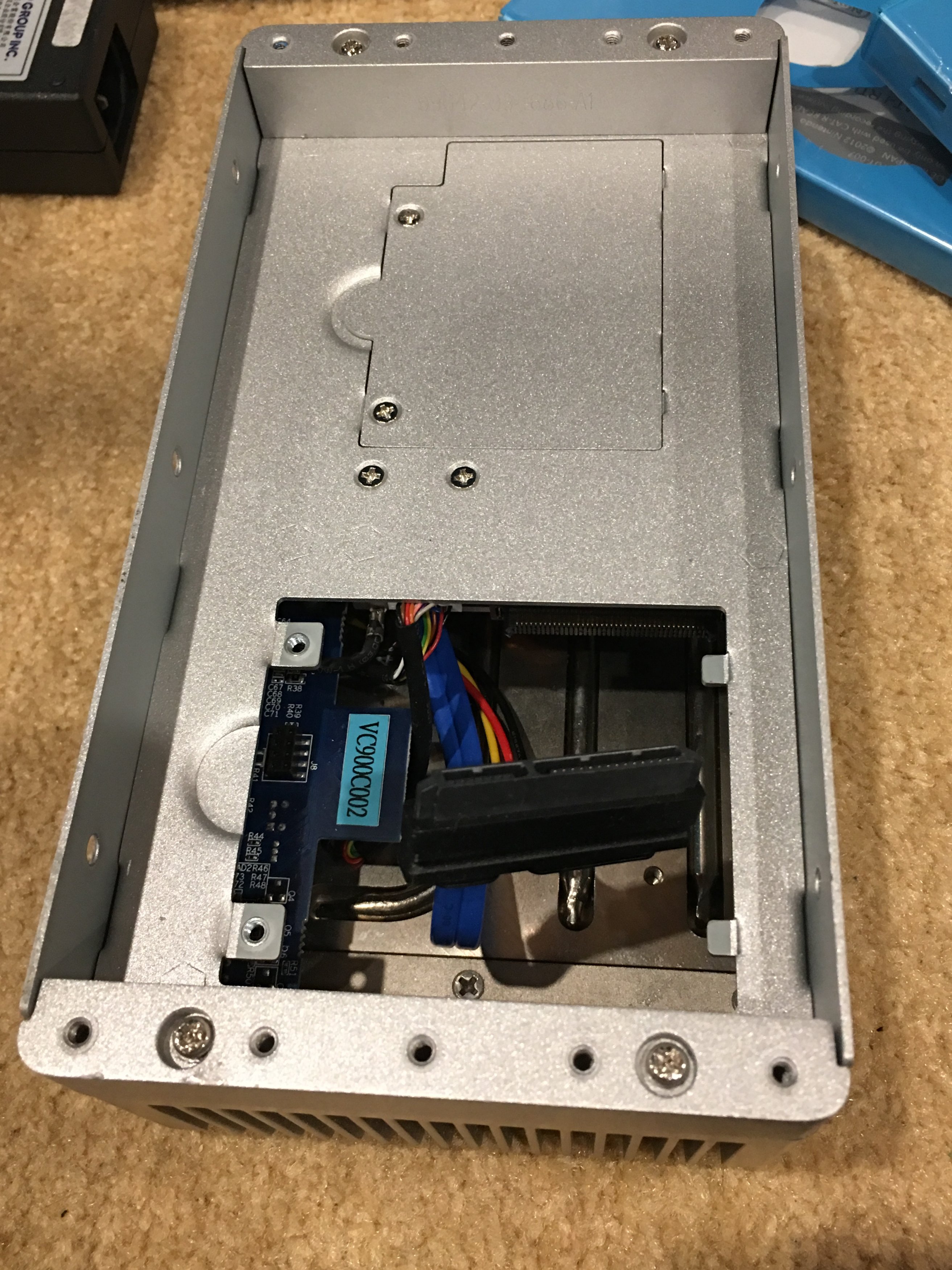

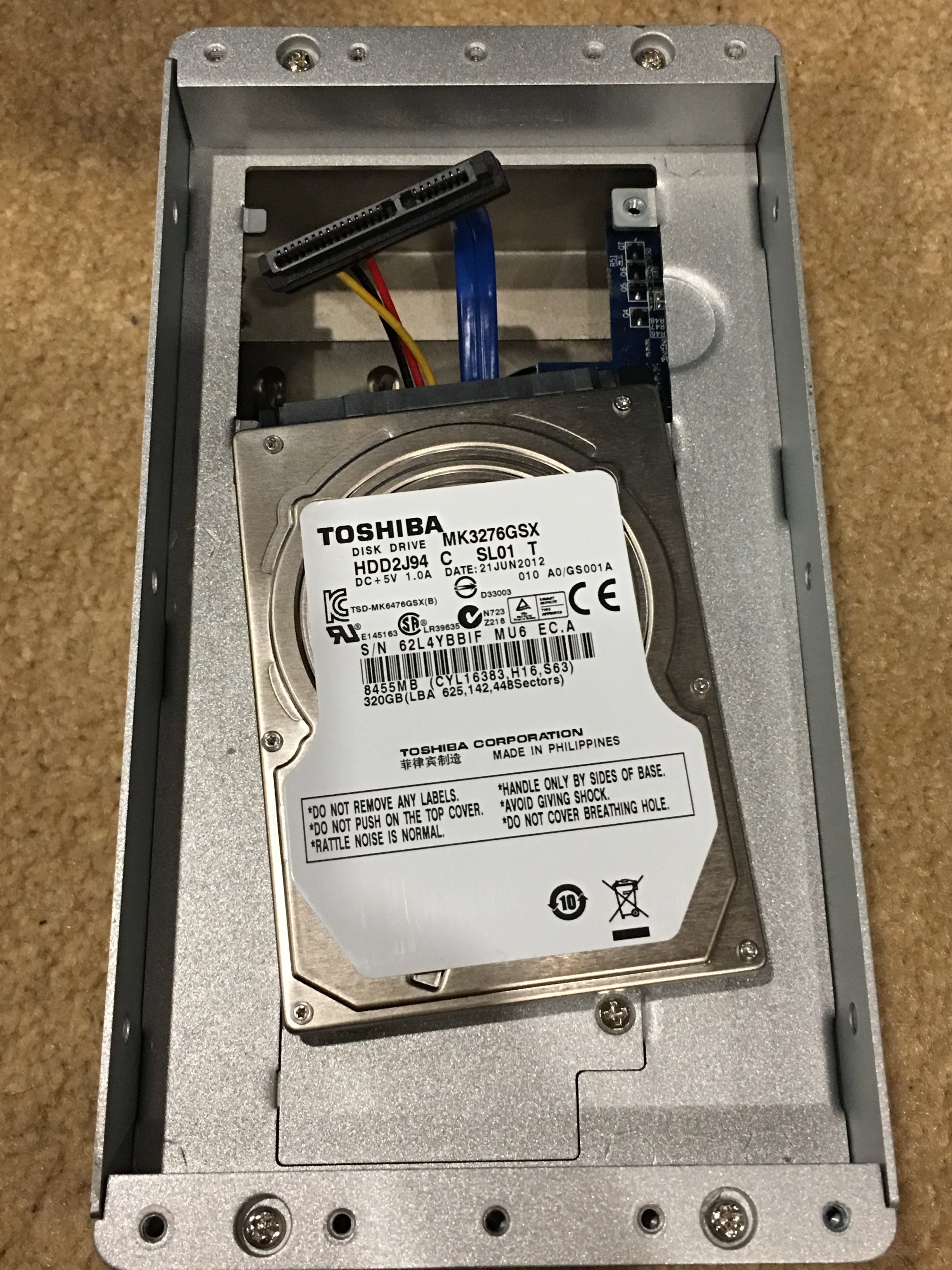

Here you go. There is a usb cord coming off the Wii U console which leads me to believe they work together. The box is just PC guts with a laptop hard drive. I'm not comfortable mailing this off to a stranger, it might be the only way I can get half my demos functional and I would have to trust it makes it back. Again, my demo console works when the two boxes aren't connected, but everytime I try to play some of the demos it hits the error screen, the videos and other demos work fine off the internal storage of the system.

Even if the drive itself isn't able to be decrypted, there's nothing stopping OP from completely making a image of the entire thing. There's a possibility that if the drive is only looking for something hardware based the data itself wouldn't be any more/less difficult with just the data alone.
Sending the unit to someone would obviously mean a person that has a ton of credit in preservation. If you genuinely can't get it open in any other capacity I'd find a person you're confident who wants to try.
I have zero clue on how to clone a linux based HDD. Is there a particular program that would work best? I'm assuming I'd need a second external HDD to copy the image onto. My first preference would be a way to crack it open and see if it's just a giant paper weight. It's like trying to solve a puzzle of how all the pieces fit without any clues and without knowing if I'm missing any pieces. Might try to hook the HD straight up to the demo console with

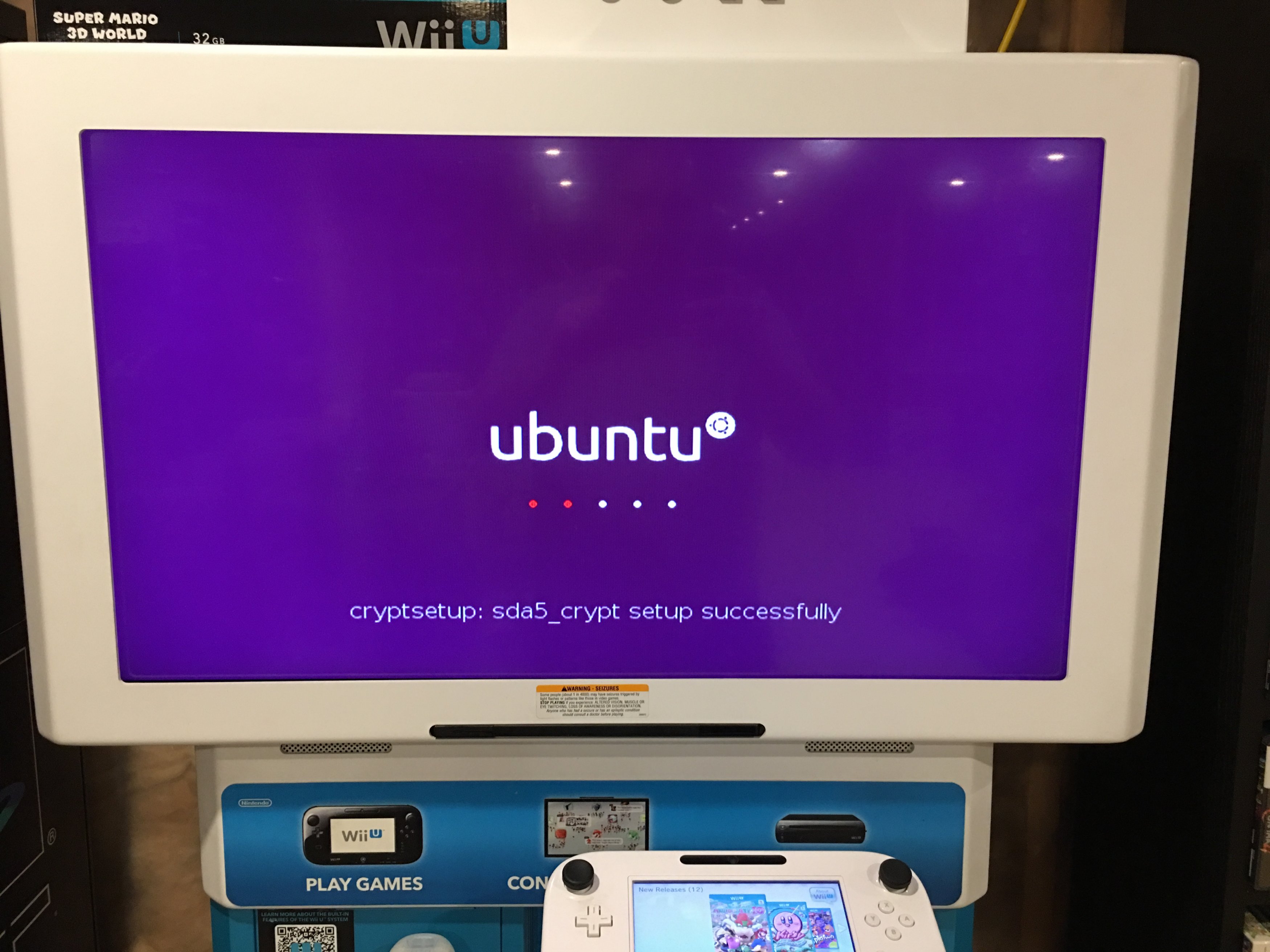

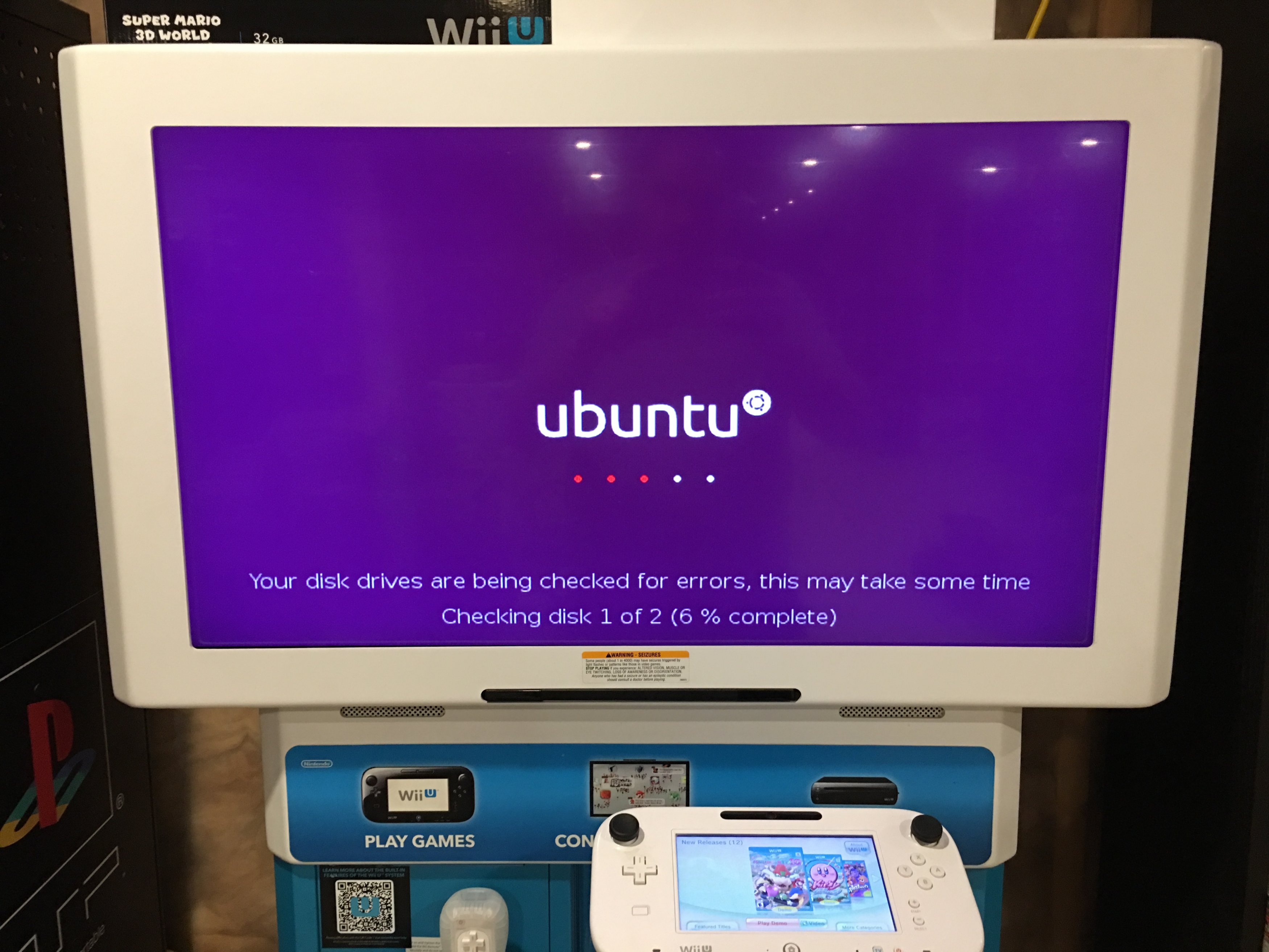

So a buddy just mentioned trying to make sure all the cords from the console were connected, I didnt have the ethernet cord plugged in every time I've tried previously. I dont know if I had just put the usb in a different spot this time, but when I turned it on, it went to the Ubuntu screen, checked the hard drive for errors, it's never done that before, then proceeded to log in. The console might be the usb key? The demos still dont work, but when I swap inputs on the TV from the console to the silver box, it now displays this screen and nothing else happens. I'll have to mess with this more tomorrow. Maybe there are other wires I've just missed buried in the back, there also a coaxial wire coming out the back of the console.
