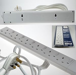

I've said this before, but people should really delete their internet settings every time and only re-add them when they actually intend to use the Wii U exploit. It's a pain, but it avoids these kinds of accidents such as updating in the background. Also, unplug the console from the wall socket (or use one of those multiplugds with individual on/off switches) rather than trusting your console to not update in standby mode.
