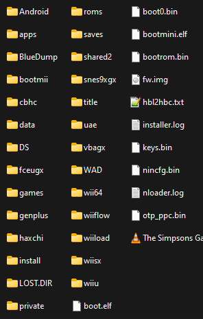

I tried to turn on my Wii U after a lot of years, and it boots to a black screen showing "-3". It has CHBC installed, if you need more info, here's the list of files in the SD card:
Thanks in advance for the help!
cant you just press home button during countdown and choose to start directly on sysmenu?
Thanks for the answer! I'll try when I get home
Apparently it works, in fact I managed to boot without the SD card pressing the home button and manually selecting "boot sysmenu", and on the next boot with the SD card it just worked!
Thanks again!
