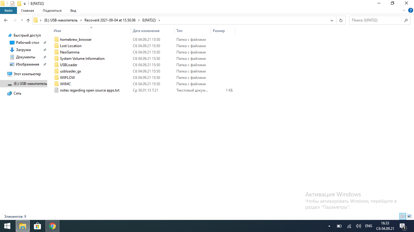

i'm a littlew confused now, does the wii boot, or is able to boot to priiloader?уes i do it but i doesnt see thats file at sd after recover and before deleteView attachment 274854
did can i just delete all and get factory wii (from pc or usb) or system is dumb and cannot recover without nand

Thx for help but i recover all, and usb loader gx wont to work, just stuck when openi'm a littlew confused now, does the wii boot, or is able to boot to priiloader?

if it boots to priiloader and you can acces homebrew loader through this than there's hope you might not need a nand dum, you might be able to reinstall System Menu (your region!), BC, Mios, ios9 to 100 in wad. your system should boot again normal with these installed if boot0/1/2 aint broken, but these are only restorable from your nand dump.
remove the ssettings file of the usb-loader GX, make sure you've installed at least one cios (i'd recommend to install all ciosses @XFlak tells you to use), and don't use a bendrive, there seems a few to work for some time but in the end most of these drives will cause (random) fails with backups. backups from SD is with some loaders possible, but i war you it might run real slow.Thx for help but i recover all, and usb loader gx wont to work, just stuck when open
