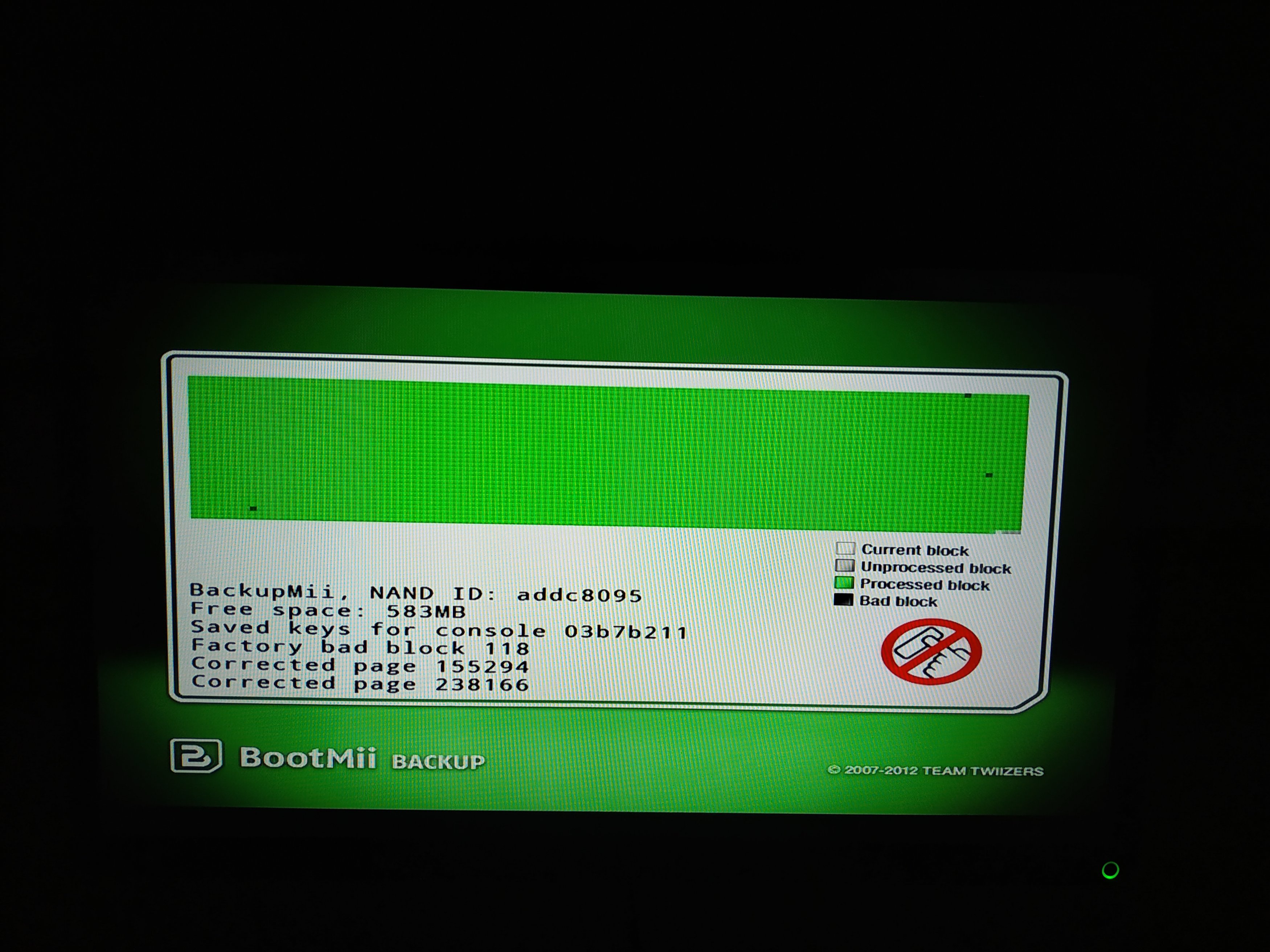

aapostol
Oct 7, 2019
23
40
56
Greece
I got this at the moment and now is Verifying the backup
Alexander1970
XP not matters.
Nov 8, 2018
14,882
52
Austria
1,316
Austria
Thank you.:)
It looks good.:yaywii:

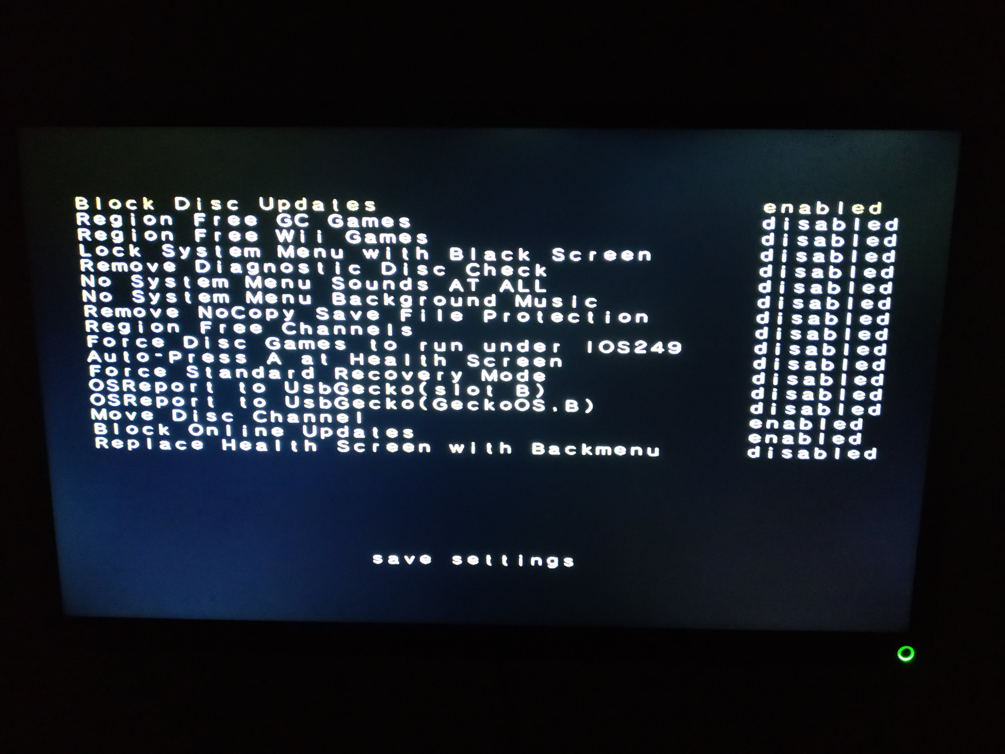

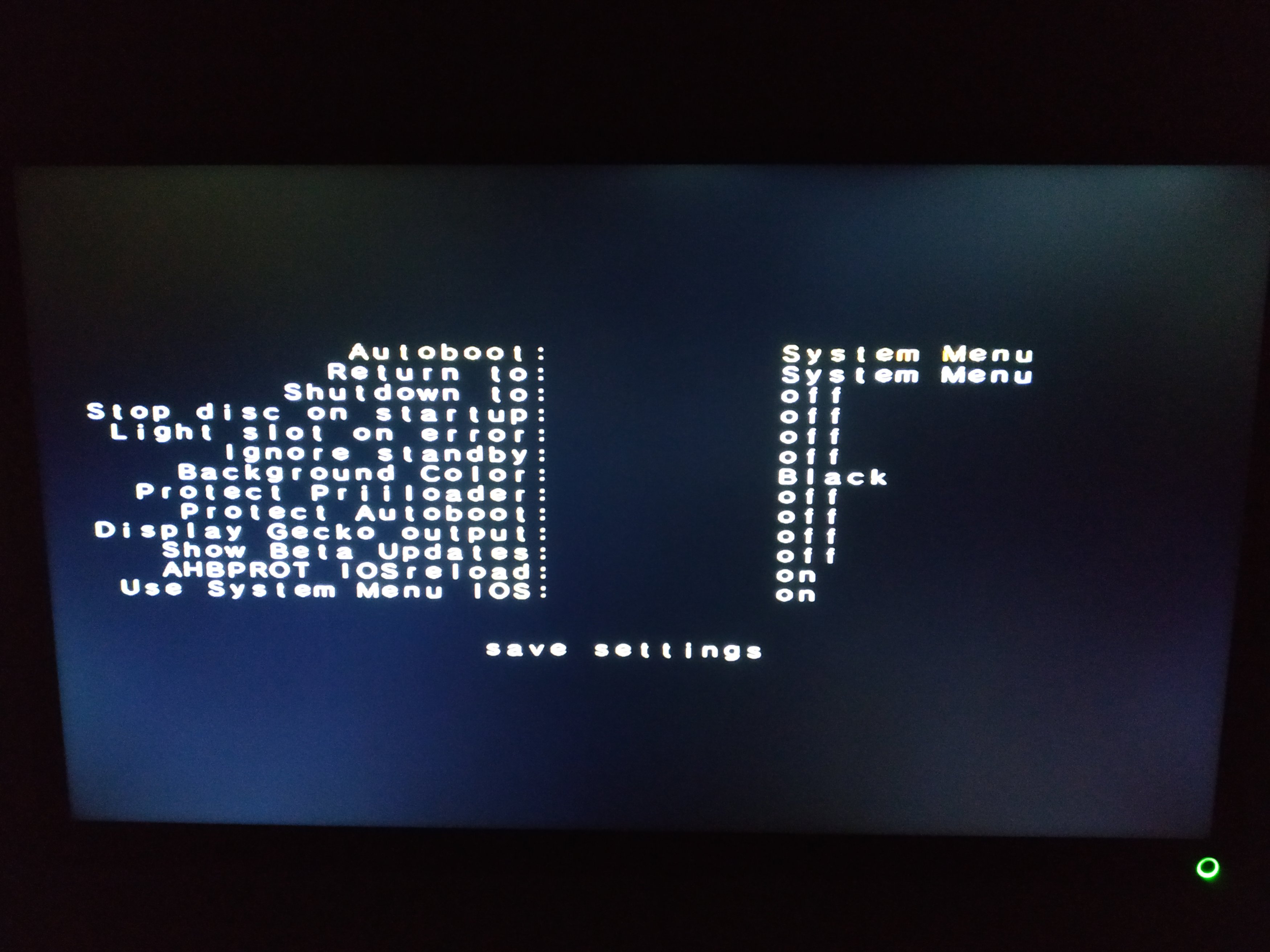

Can you please make a SCREENSHOT of your PRIILOADER Sytem Menu Hacks and Settings please ?

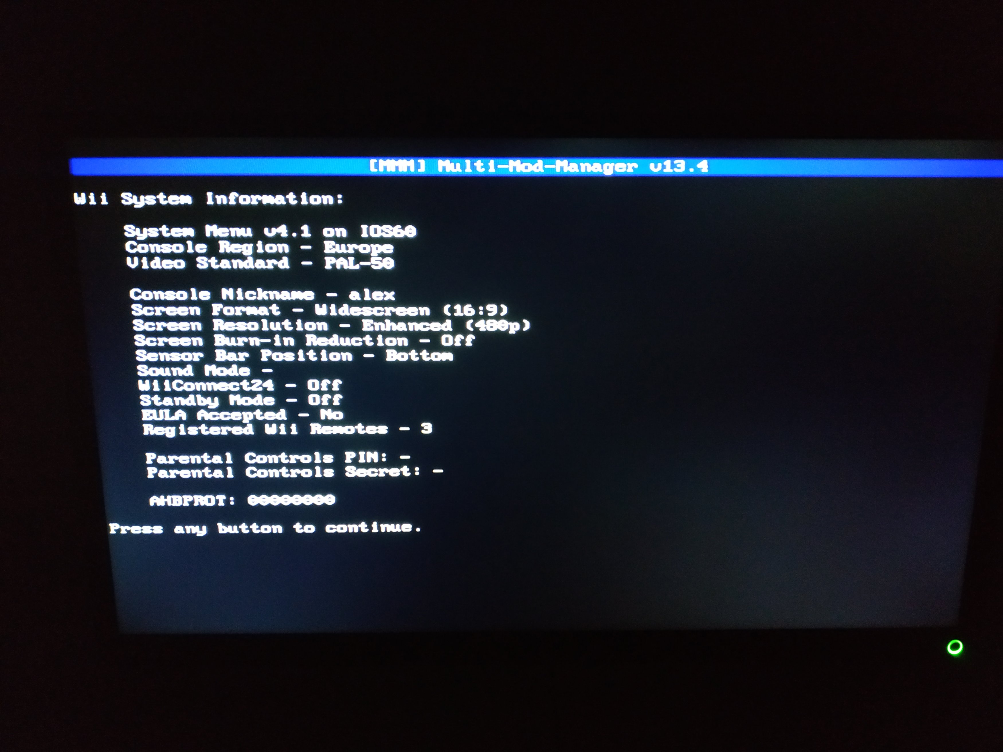

and what says MMM on "Display Wi System Info" please ? :)
Reactions: aapostol
Alexander1970
XP not matters.
Nov 8, 2018
14,882
52
Austria
1,316
Austria
View attachment 182140 View attachment 182141
Thank you.:)
I maybe see where the main "Problem" lies:
Sound mode -
WiiConnect24 - Off
EULA Accepted - No
Do you have an Original Wii Game (one of that later released than July/August 2009 - the Date of your Wii System Menu 4.1) ?
Now you have maybe a few choices:
- Leave all as it be.
- Set Priloader to "Force Standard Recovery Mode" in the "System Menu Hacks".
This gets you into the Wii´s Recovery Mode where you can use an Original Wii Game newer than 2009 and hope the Update works.
- Use ModMii for the Wii Update to a higher Version than your current 4.1E
In Case 2 and 3 you need to re-install the Priiloader.
(and maybe also BootMii too).
I do not know exactly what happend on your failed Wii System Update and then later.
I can not give you a warranty that one of these Solutions works on your Wii.
Please also note the chance of a non working Wii after you try one of this Solutions.
It is your Wii and your Choice.
Good Luck
