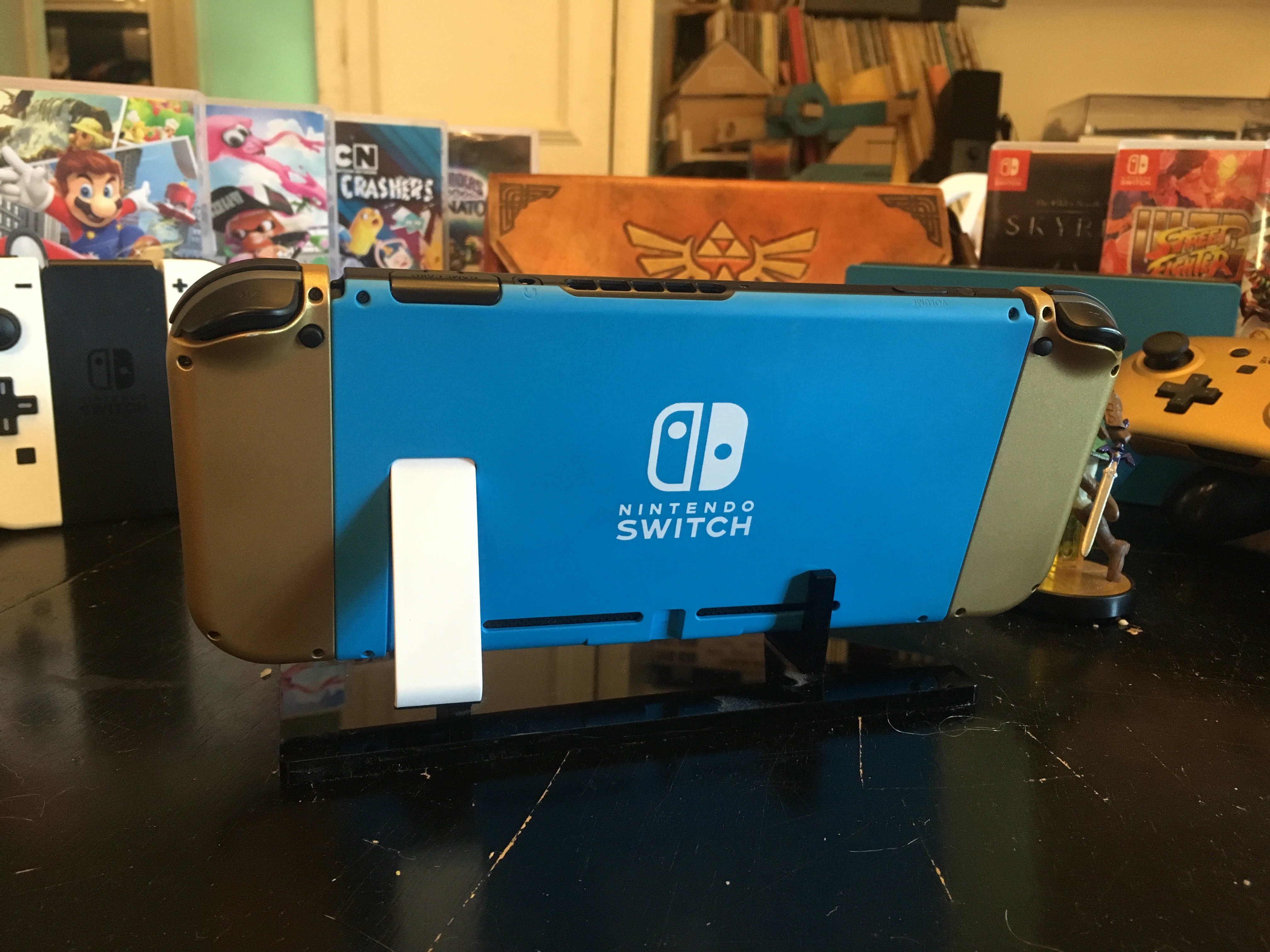

I have two switches, one I put decals (Skyrim theme from GameStop) and the other was painted by Colorware.
The decals I've played with always look like decals, you can just tell. But the price is cheap and the looks arn't bad so I use decals for the kid's Switch.

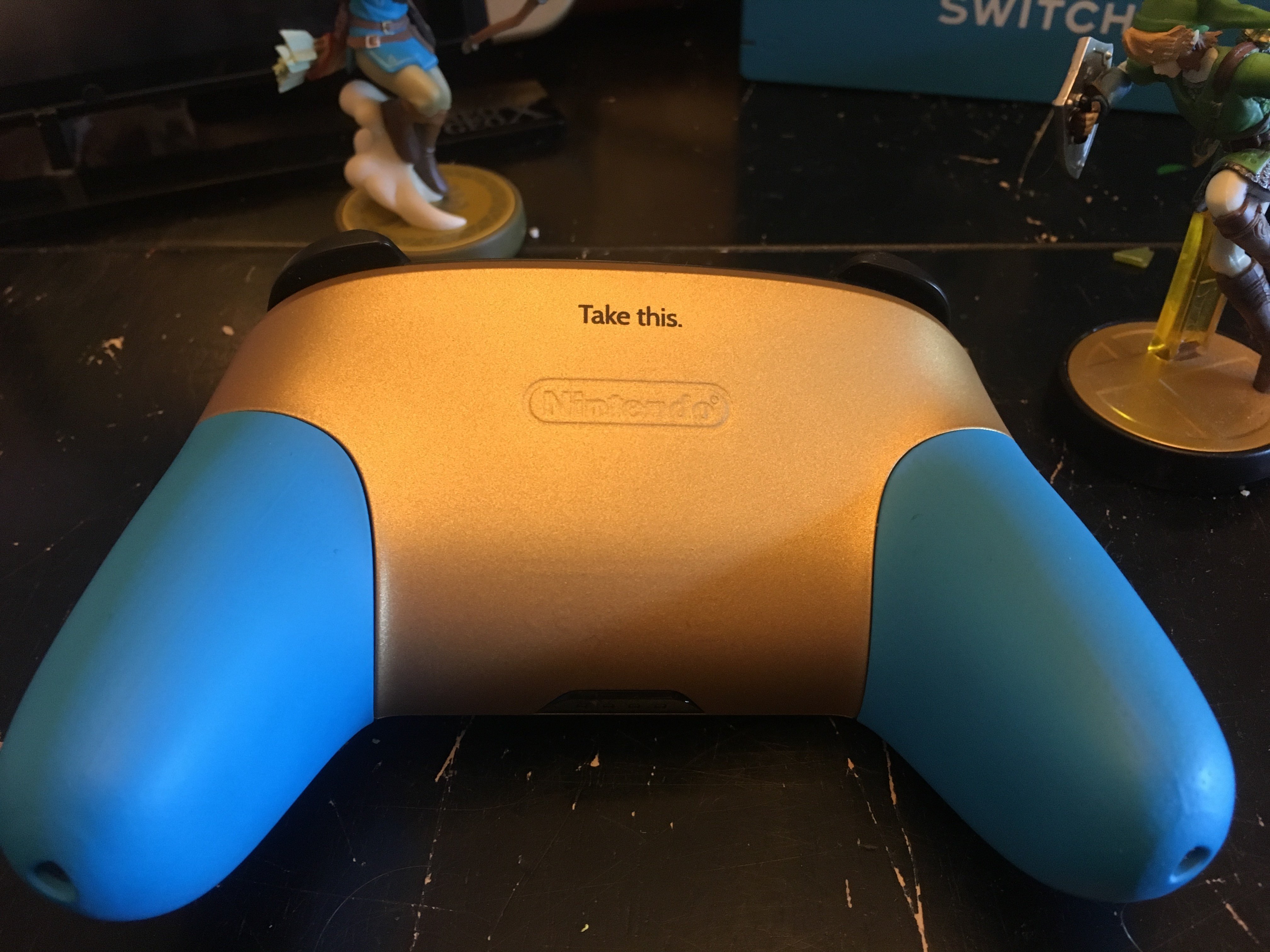

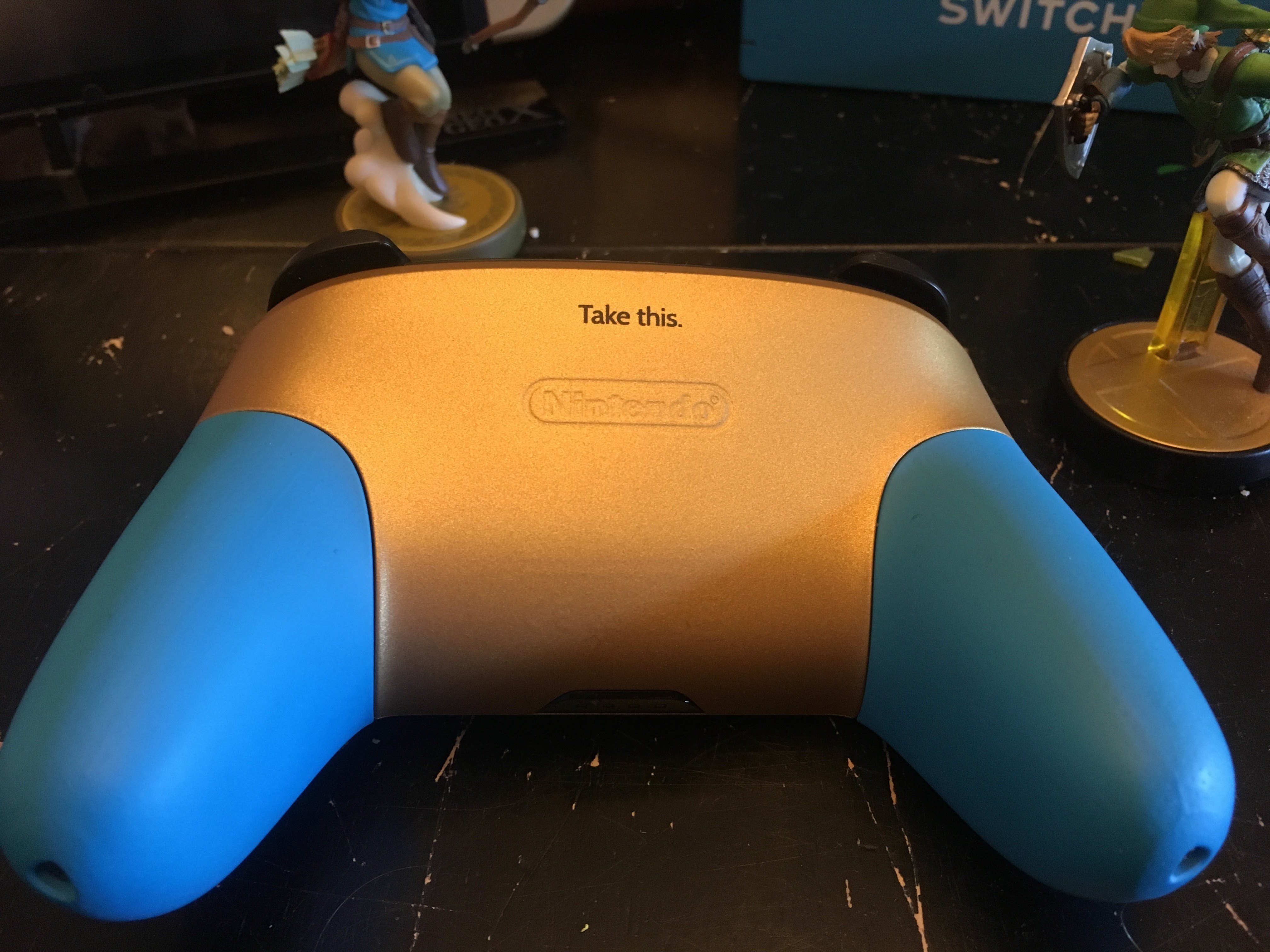

The paint job from Colorware looks like it was always meant to be that way. It is beautiful and somehow makes it even feel more quality... maybe something to do with the paint finish. But it is very pricey, and my kids are never allowed to even touch lol.

Here is my painted Switch:

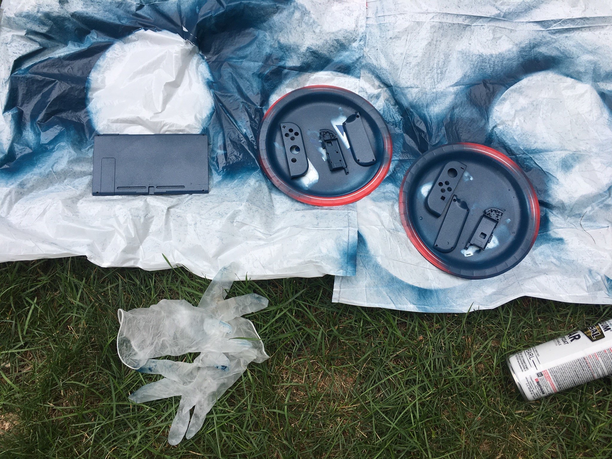

Two days ago, I took apart both joycons and have the materials to spray paint them when the damn rain stops (fine sandpaper, matte blue spray paint + primer, and glossy finish which was the only one I had). It was very easy to do and it seems like it'll go back together just as easily. You'll need to buy a triwing screwdriver though of like 1mm, I think? I'm not worried at all about a issue with a spray paint job coming off. Regular joycon housing is so cheap that I'll just buy new housing to spray paint if it starts coming off after a while...but I do hope it doesn't start coming off only a few months in or worse!

Stickers, in the long run, aren't worth it. Even if they last a year they're going to turn to crap.
I've been painting consoles since 2002. You want car spray paint. Or another high quality paint.
DO NOT BUY KRYLON. It comes out like garbage compared to Duplicolor. And they're like less than a $1 difference.
Plus you can get metallic colors like the gold MrBland has.
If you've never spray painted anything before, look up some quick tips on youtube. One key thing you'll want to get down asap is starting about a foot away from the object, spraying, and Swipe. Never start the spray pointed directly at the object.
If you're going to sand, I dont recommend anything under 1000 grit.

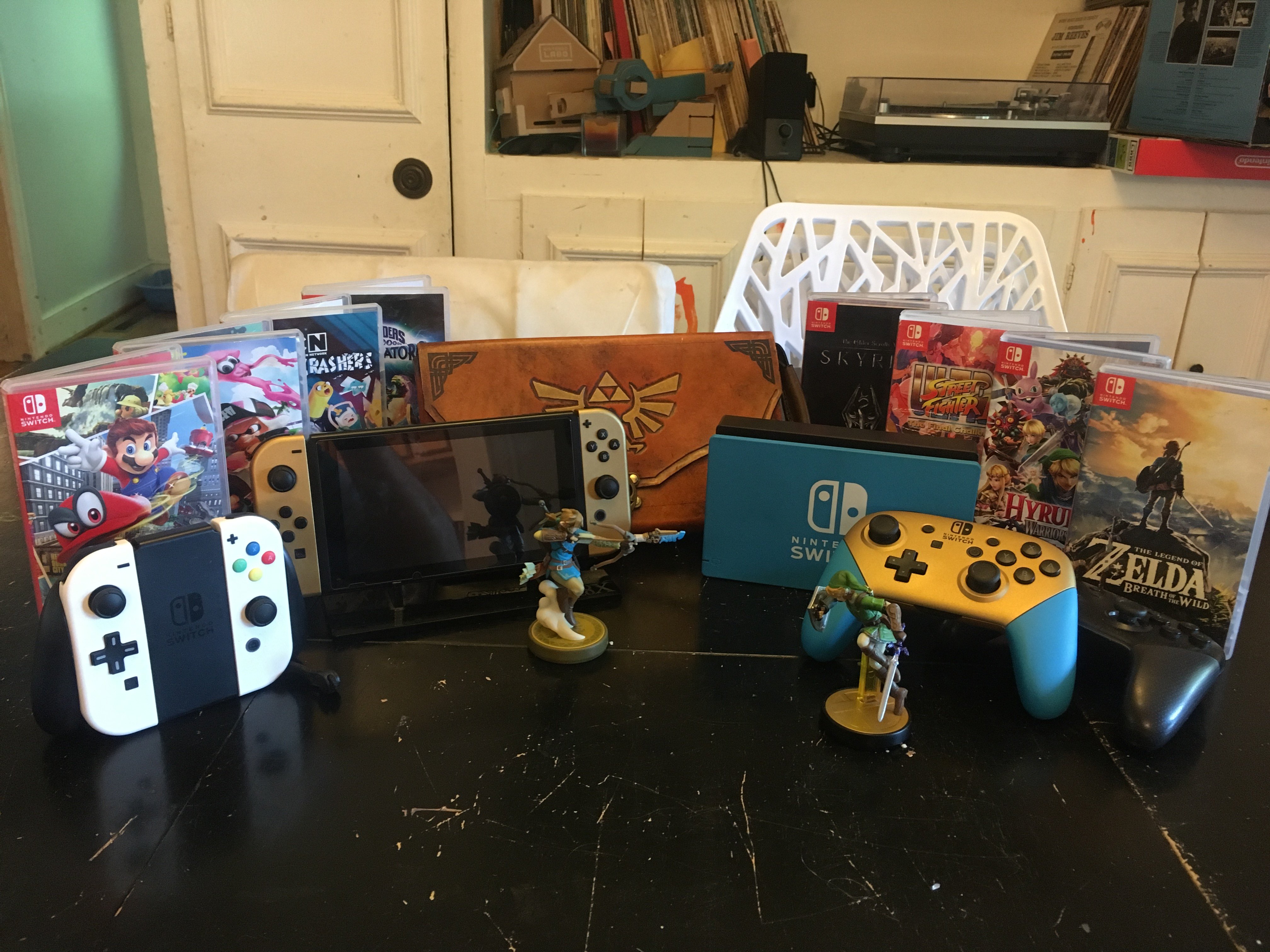

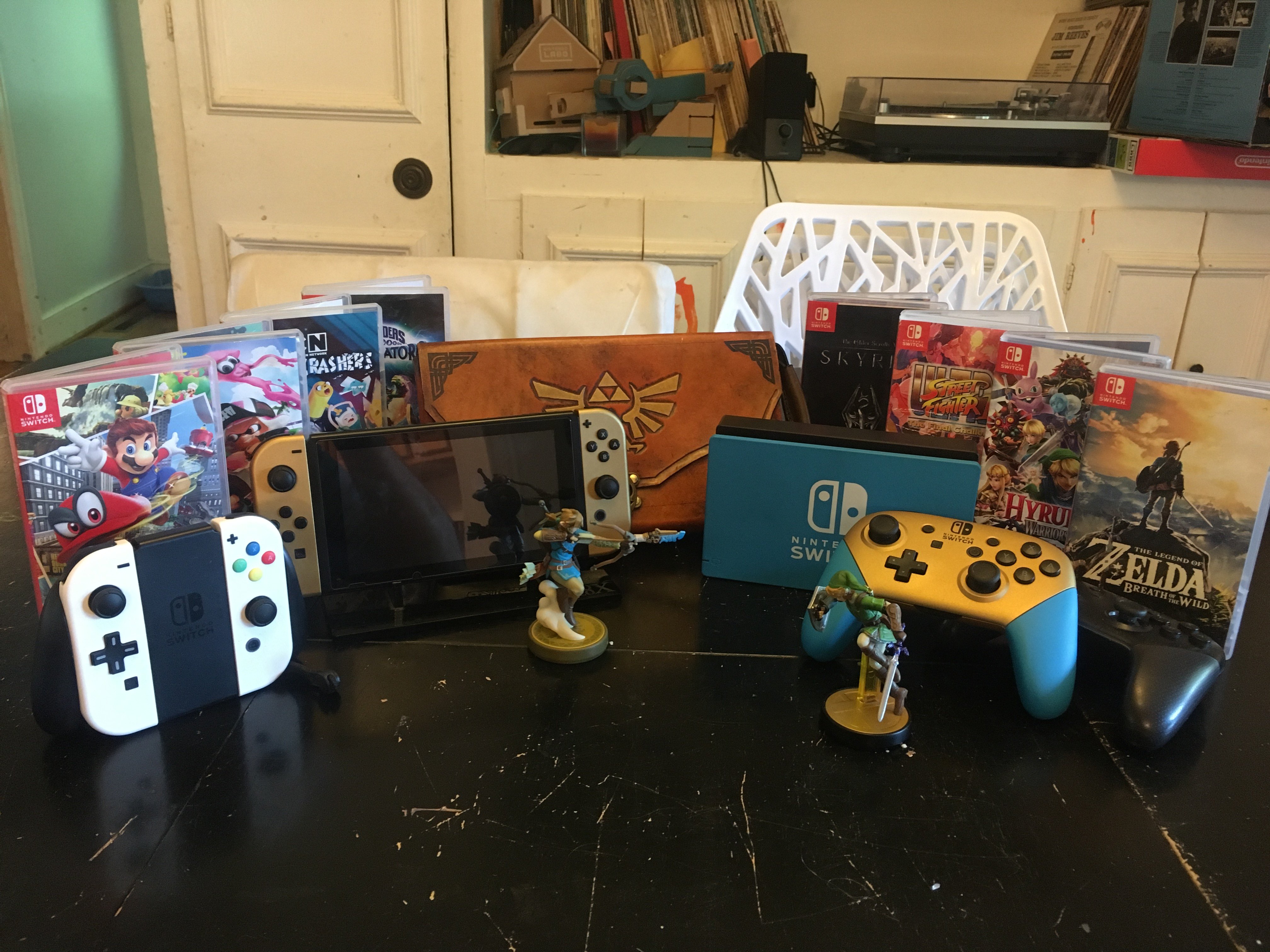

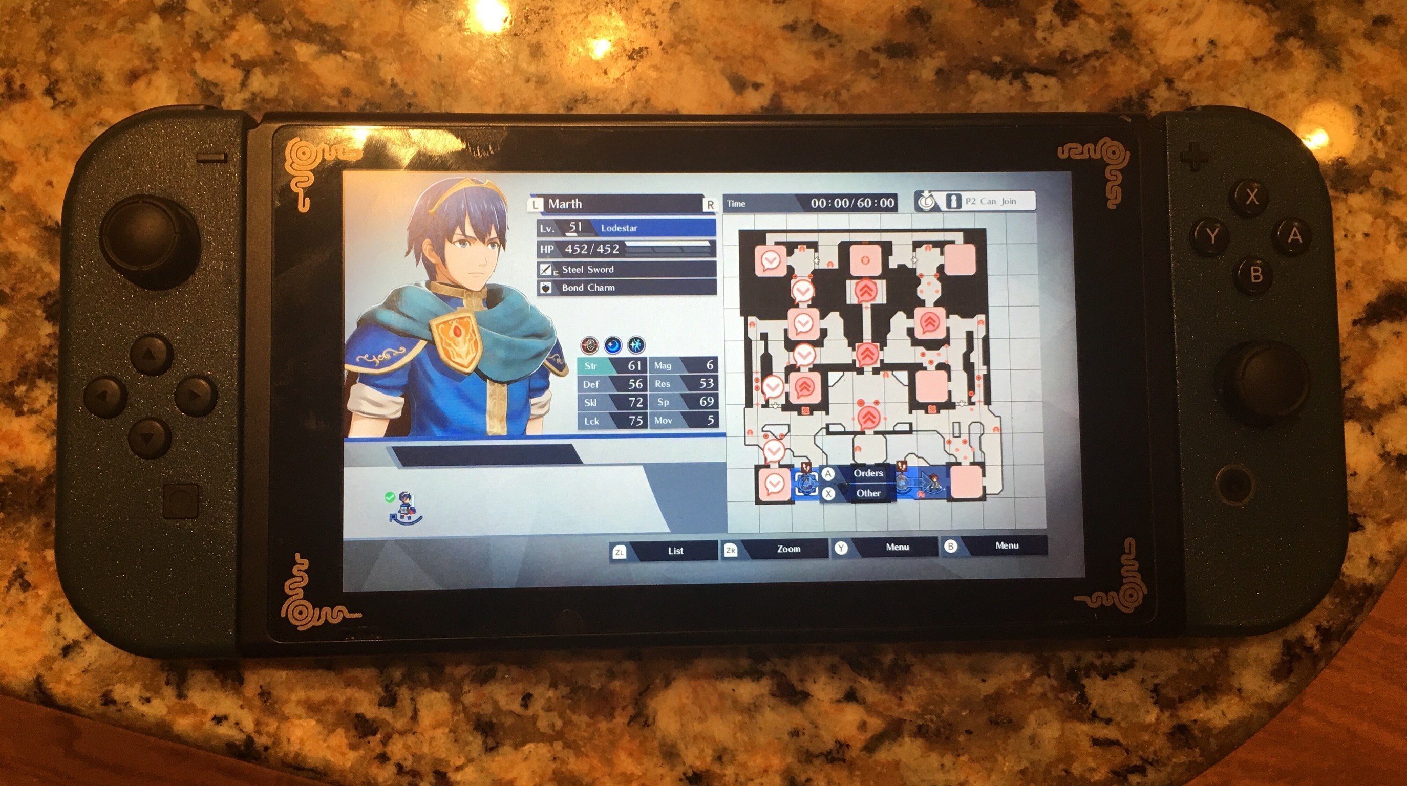

It looks all right to me. You might be interested in seeing. I didn’t do the best job, but I think it’s serviceable. I expected less than this honestly. The sparkly finish isn’t for everyone, but it does help hide any sanding marks in case you were rushed by a week of predicted rain + a bit lazy.

A clear coat would be a good idea, but I’ve actually put it back together already. Here it is. The only issue was that I lost one of the triwing screws for the back of the Switch, but there are 10 more screws holding it on so it doesn’t make a difference.
I expect it’ll come off for sure, but I’m not sure when, so I’m going to wait until it does. You can still see the parts where the paint ran a little and where I sandpapered, but I don’t mind it at all. P.S. Fire Emblem Warriors is a fantastic game ;0 Edit: Turns out I added a "topcoat," not sure if that counts as a clear coat though.
