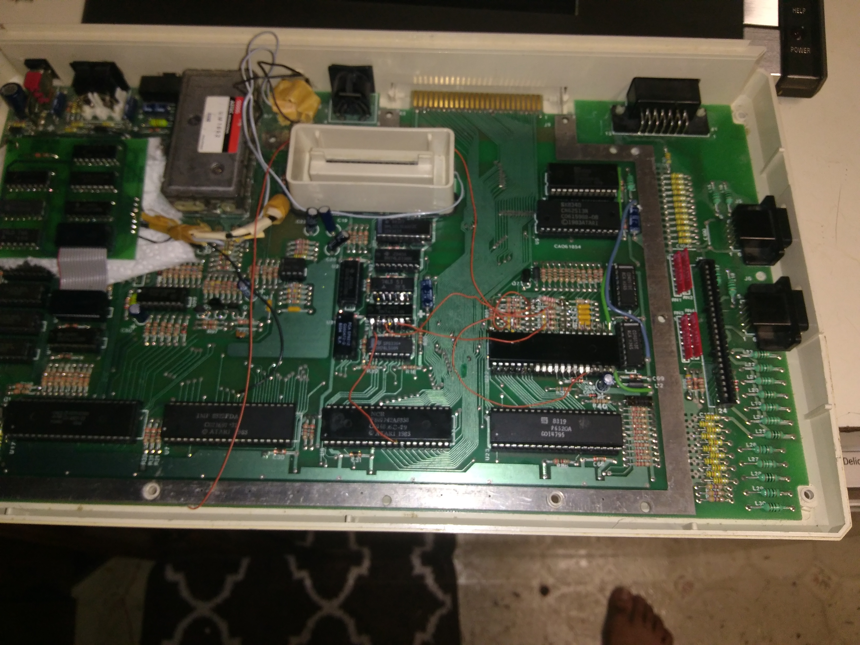

Welp, I spent alllll night converting my Atari xl into a stereo dual pokey, was much easier than I expected.....works well, especially on draconus

This is just scratching the Barrel, if I had the cash, I can have up to 4 Meg's of ram, or replacing the 6502 with a 65C816 I could get 16Megs of ram, hell some one even replaced the the 6502 with a Motorola 6809, might aswell put in a 68008 in one, run the Atari chipset with 16bit power(uses an 8bit databus though), I run software via a ftdi USB serial port via sio atm, I've order an sd sio emulator from lotharek, but he is in Poland and I'm in the USA, and the covid keeps it from being delivered
Software has to be specifically written to take advantage of the additional pokey, mostly newer games and demos ultlize it, earliest did I found is from around 1984. I want to put an ay-3-8910, connect it via pbi though, I have a bunch of spare vcs tia too, a combined 13 channels of pokey,ay,and Tia would be interesting to play with
PS check this demo out, running on a 16k atari 400, uses over 60megs of ROM (uses a flash cart) and cassette drive, but for the weakest of 8bit Atari it shows the real power without the price
