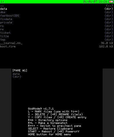

Are you certain your [1:] SYSNAND CTRNAND is empty? This isn't the same as [0:] SDCARD ().
It's suppose to look like this:
If those are truly missing, there's no way to retrieve or recreate those three (3) important files unless you made a prior SysNAND *.bin image from that system.

Your n3DSXL has no unique identifiers. This is something CTRTransfer can't fix. It would be like if you lost your driver license, passport, and citizenship making you a nobody.
If you've used GM9 before and never accepted the prompt to create essential.exefs (why?), then you'll have to fabricate new files or use ones from another system.
LocalFriendCodeSeed you can use from a different system, if you don't have another 3DS to get this from you can get a public one from the internet.
You might be able to forge a fake one, but that's not something I've tested, and if you're going to be getting a new LocalFriendCodeSeed you might as well get a proper one rather than inserting garbage data (if you forge a fake one, it won't work for online play, assuming that it would allow the console to boot that is.)
HWCAL0.dat and HWCAL1.dat, I'm not sure how important these are, I've had success simply using ones from another working system, but your mileage may vary as those are meant to contain system-specific calibration data.
movable.sed, you can copy one from a working console. You can do a system format afterwards to regenerate a new one. You might need to copy your LocalFriendCodeSeed into it at 0x8-0x117 first, that's not something I've tested. In a pinch, your 3DS will work without a movable.sed and allow you to play carts and digital games, but you will not be able to system format, among other possible issues.
nand_cid and otp you don't have to worry about, those aren't nand files so you can't possibly have deleted those while deleting stuff from nand. Your nand_hdr is likely fine if you only ever touched CTRNAND and nothing else, so you probably don't have to worry about that either, but if absolutely needed, GM9 lets you rebuild nand_hdr, if needed, and that might be all you'd need.
SecureInfo you can forge a fake one if needed, I am not sure if the 3DS requires the correct serial code in SecureInfo in order to boot though. You can get your serial code from the back of your system, or from the box it was packaged in (if you have that.) You can fill the signature with random garbage (all 00s or FFs is easy), enter the correct region code for your system, and then your serial code (if you don't have your serial code anymore, try any serial code, in case it works.)
If you do this, your 3DS will no longer boot without CFW, but it's better than nothing.
Get a CTRTransfer image from your region, mount it in GM9, then highlight everything with L and paste it into CTRNAND. Then delete the placeholder LFCS, SecureInfo etc. files that were present in the CTRTransfer image, and move the ones you extracted from essential.exefs into their place (you will have to rename them first), or copy the files you've forged and/or taken from another 3DS into their place.
Fix CMACs for drive 1: (Highlight [1:] on the main menu and press R+A), after this your 3DS should boot.
Optional: if you have opted to go without a movable.sed and can't system format (if you couldn't get one, etc.), you may be able to simply delete the "data" folder in CTRNAND (those are simply nand extdata and savegames that should be safe to delete, the 3DS will regenerate those on next boot or next run of the affected applications.)
Note that if you choose to go without a movable.sed, or if you couldn't get your original SecureInfo and had to forge a fake one, I can't guarantee that the eShop and online access will still work. I don't even know if you would be able to update through system settings. But you're better off with a 3DS that can boot and run games and homebrew, than one that doesn't work at all.
This should be all the info you need to get your 3DS back in working order, if you aren't as tech-savvy and need directions on how to do any of this, somebody else can probably guide you.
