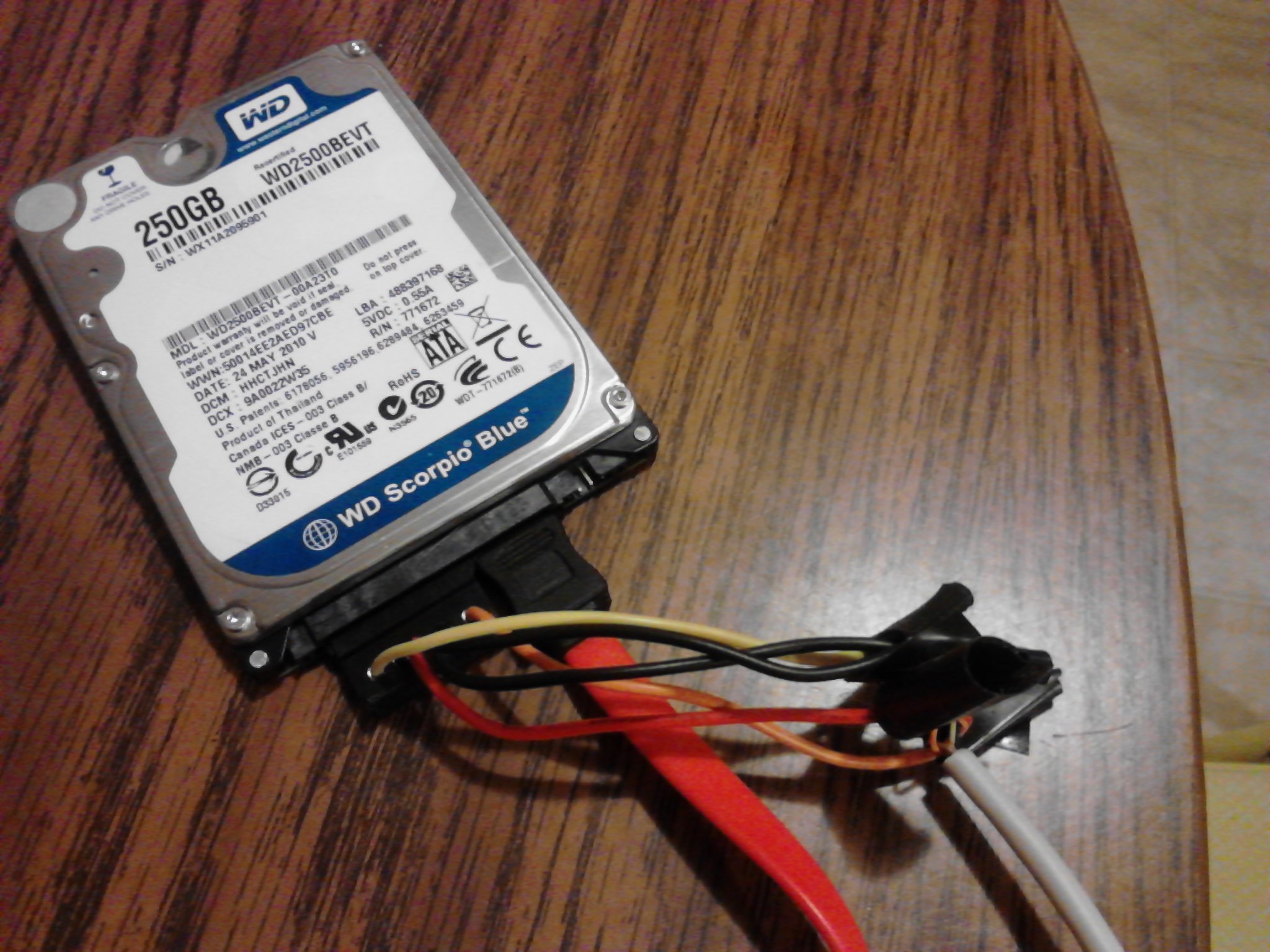

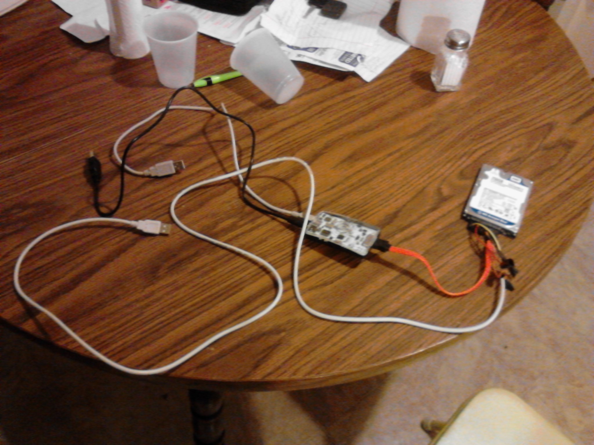

Since I lacked one of those to work with, and seeing how I have two dead phat xbox 360s lying around, I decided to scavenge the hdd out of one of them (which is just a simple notebook/laptop hdd in a fancy shell). Okay so my next thought was, can I use THIS (its a 250gb hdd so for use with trinux this would be massive for extra storage) with trinux :). My only problem with that was that I don't own a USB enclosure XD. At that moment, I realized I have an old x360usb adapter for flashing/repairing 360 drives huzzah! Sadly, the only SATA connection for that is DATA not power rats. So instead of going out and buying a USB enclosure, like a normal human being would, I made myself a custom cable to power the sata hdd using a usb cable XD.
Now the harddrive reads perfectly fine on both my laptop and desktop (windows and linux), the issue is i've been bashing my head against a wall trying to get trinux to see it. After battling with this for many hours (lol) I realized that it isn't seeing ANY usb mass storage devices at all. I think something became broken after that last beta was released. It must've been some package I installed that didn't play well with mass storage devices. Long story short, stuff got broken software wise XD. I figured this out by trying other usb mass storage devices (that work fine on my computers) and none of them would read under trinux. Fun fact though, I could view the hdd and other devices fine using Wiixplorer via the hbc, so I know this issue is isolated to trinux.

Okay for those of you who found my little custom cable venture interesting, I had a chance today to finalize my custom usb to sata power cable. In the previous pictures (and tests) I had only spliced the cable together to see if it worked, before going through the labor of soldering everything, in case I screwed up my wiring. Anyways today I had a chance to solder all the connections together. I've attached some neat little pictures of the process, including showing the harddrive reading correctly on my Ubuntu laptop. As for getting this to read under Trinux, thats another project altogether XD. Anyways, here's some neat pics :) IMG_20140920_173920.jpgIMG_20140920_174401.jpgIMG_20140920_174606.jpgIMG_20140920_182557.jpgIMG_20140920_182752.jpgIMG_20140920_182927.jpgIMG_20140920_183021.jpgIMG_20140920_183110.jpgIMG_20140920_183200.jpgIMG_20140920_183250.jpgView attachment 10514IMG_20140920_183608.jpgIMG_20140920_183614.jpgIMG_20140920_183631.jpgIMG_20140920_183638.jpg

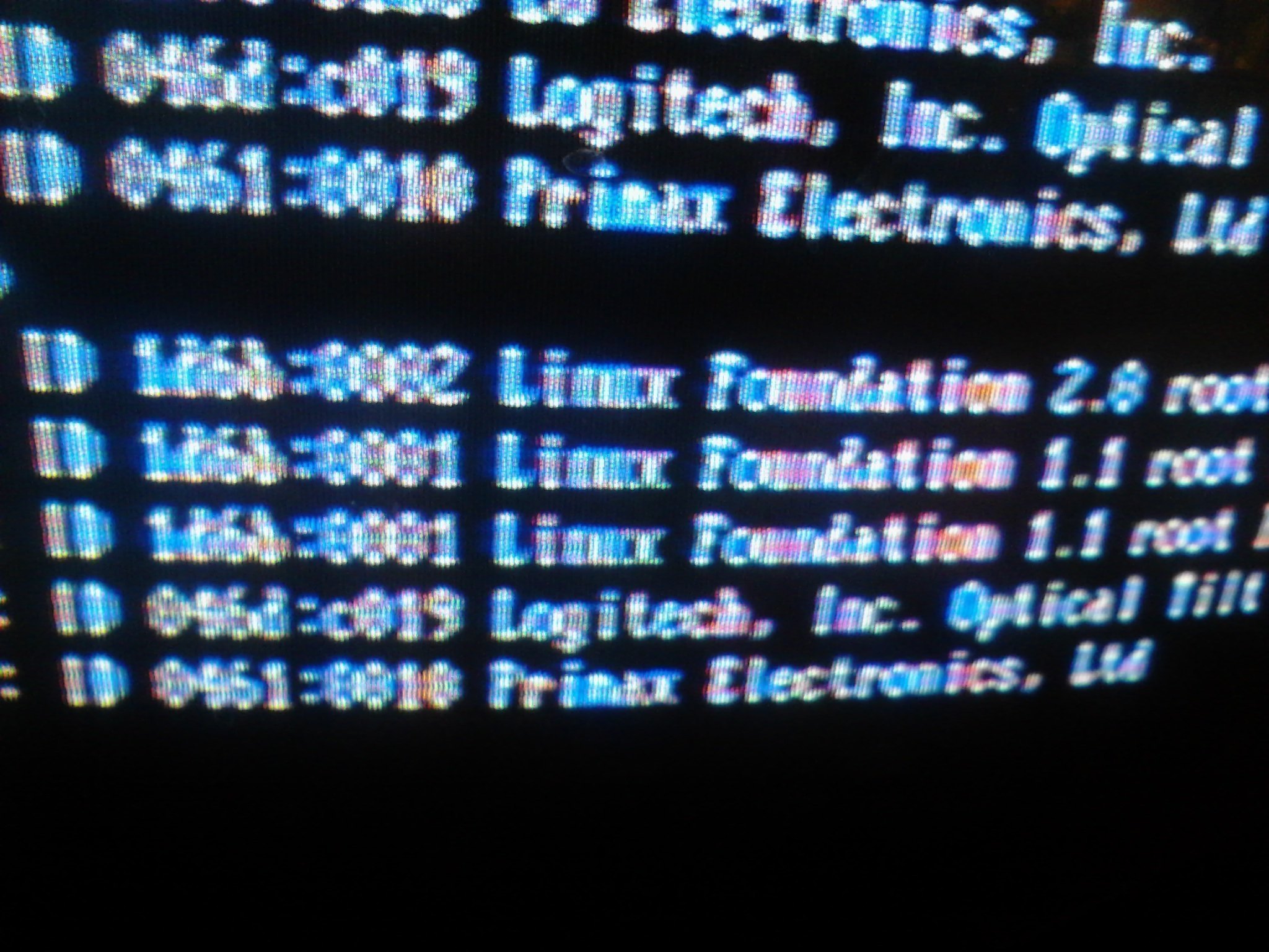

UPDATE 3: Something interesting happened when I plugged in my android phone and set it up as a usb mass storage, its listed under the lsusb output w00t! now we're getting somewhere. Again, I'm on Trinux 1.0b still, I'm not sure if this still works on 1.4b. That's my next test :). If everything goes well on 1.4b then I should be able to mount it from there. So I can confirm what Ninja_Carver previously stated, that some usb mass storage devices are compatible w00t! We would just need to do some serious tweaking to get more usb storage devices to work correctly
Phone is unplugged:
Phone is plugged in:
