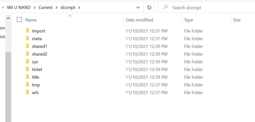

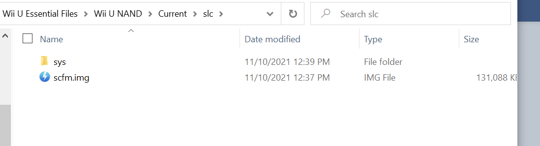

that gave me an idea: to extract everything from my dumps:
mlc:
slc:
slcmpt:
