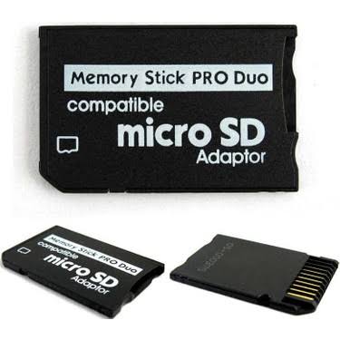

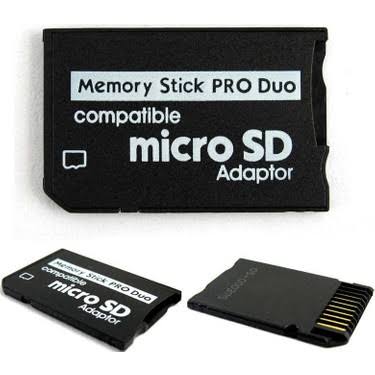

I've used this one for years and never had an issue. Tbh any single slot adapter should be decent enough.
OK noted that's what I'll purchase then p.s giving a little update borrowed a oem memory stick from someone and everything works flawless even installed cIPL just that my current double sd card adapter once it's re inserted the psp goes haywire (also realized I couldn't even get PRO installed either it would just crash everytime) so that confirms my suspicion just need to get a single slot sd card adapter now thanks so much reha your help It is greatly appreciated
