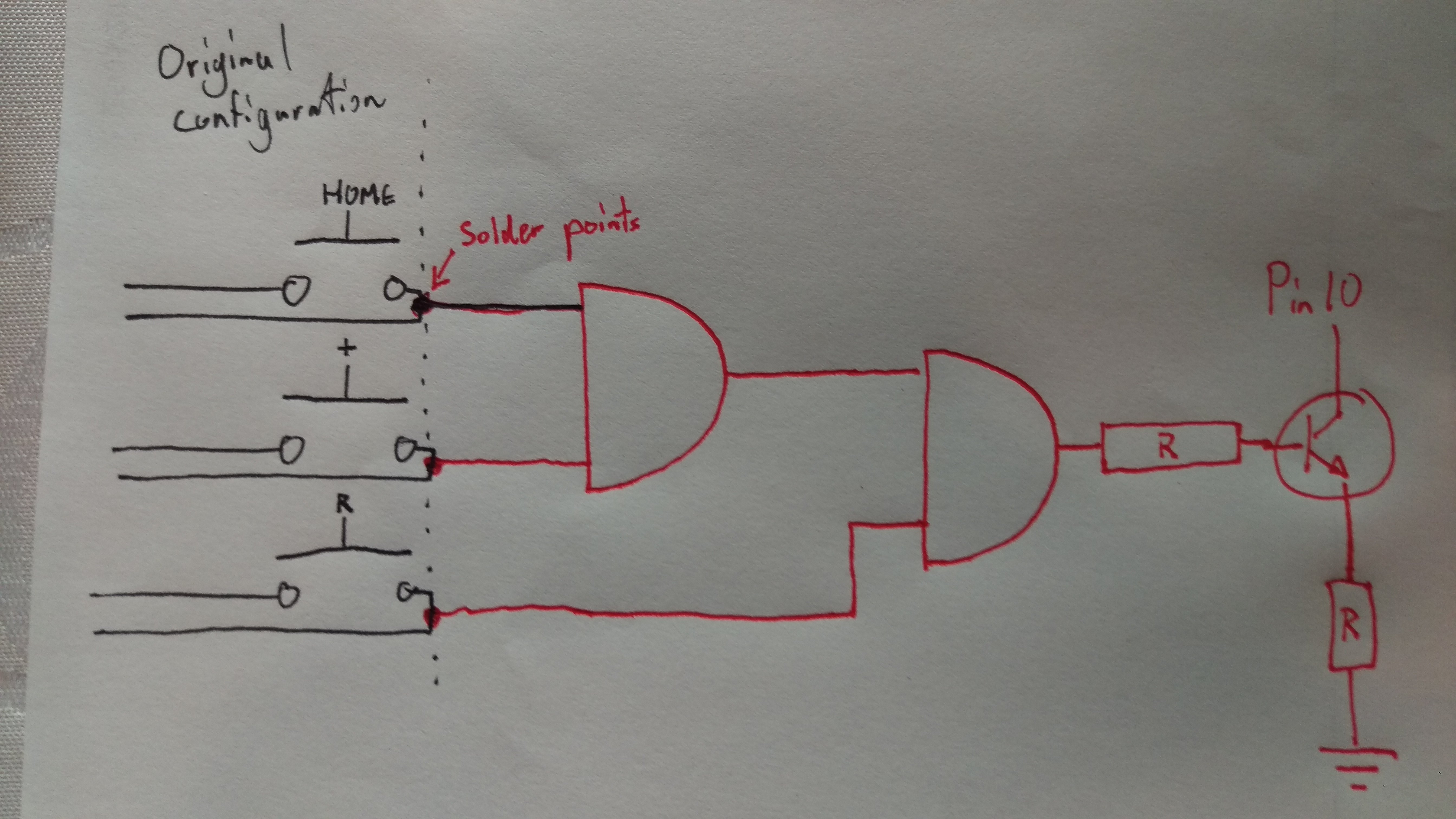

so after I installed the Joycon magnet mod from @TheCyberQuake I had an idea to use a button combination (like HOME + PLUS + R) on the stock hardware buttons on the Joycon to short PIN 10 to GND.
My problem right now is, that when any button is pressed it is already grounded and my electronic skills are not that great and I can't get a solution. I tried different button combination but I get some weird results, like when I press R the switch thinks I'm pressing the HOME button.
Maybe someone knows a solution, I think this is a nice and clean thing if it would work.

Thank you for your reply, to clear some things up here is a plan how it looks like.
I can't figure out how to wire it properly without shorting buttons which results obviously wrong button detection.
Try this out. The semicircles in the middle are AND gates that I didn't label, how you want to wire those is up to you

Guys, how would ANDs work, if the pushed buttons are connected to Gnd? :unsure: To use ANDs, you will have to invert the signal...you can't wire this up with 2 or 3 transistors. Maybe you could use some kind of IC...a Teensy or another small micro controller would definetly work. But i don't know how much space is in a joycon.
That is what thought. Good point I will do some research.

You could try a Nor Gate(3 inputs)/Gates instead of the And. With it's output you can use a npn Transistor as Ground switch. But i can't promise this will work or if you fry your Joycon via any kind of short circuit. :D
Also the IC and the transistor may draw current all the time from the battery, even if the Joycon is shut off. :unsure:

You're probably going to have a hard time with that because the buttons don't use common ground. They use a keyboard matrix interface instead.

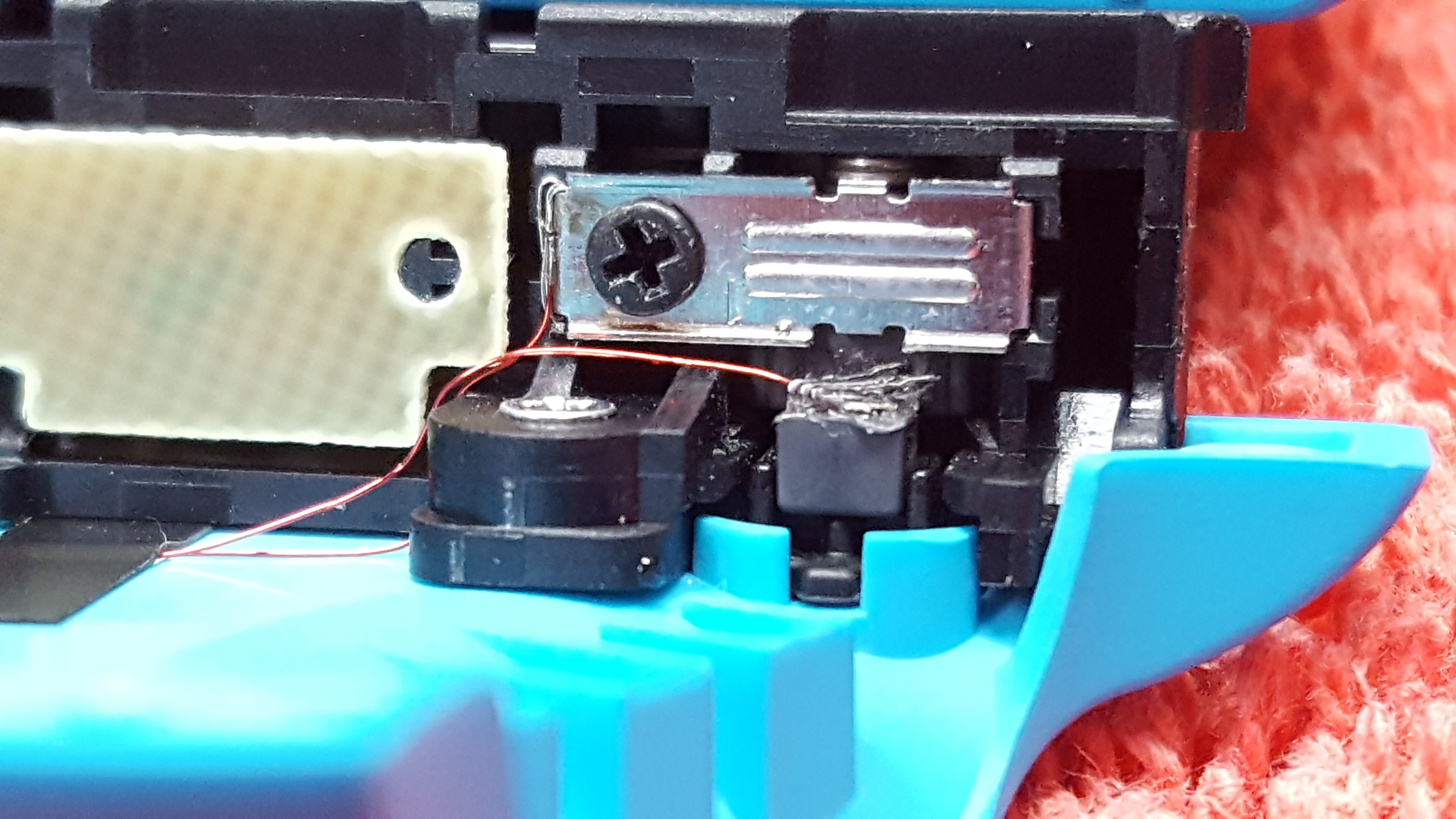

You can use the Joy-Con release latch by adding some wire and metal pieces. I used a potentiometer wiper on mine so it can fold down and spring back:
Reactions: MuppetPaster
