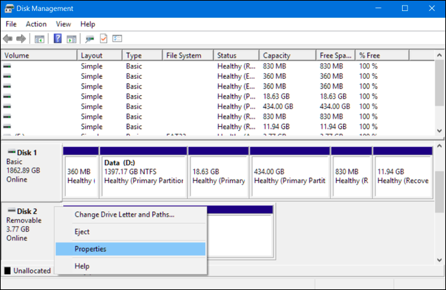

Which HDD/Brand do you have please ? If it is an WD (Passport) then it is maybe a sleep/wake Issue.The HDD needs to long to spin up again.:sad:
Is it intialized as GPT or MBR Drive please ?
img_56e628d28bd5b.png ximg_56e6297886fee.png.pagespeed.gp+jp+jw+pj+js+rj+rp+rw+ri+cp+md.ic.CWW2klJGXS.png
Is it maybe partitioned ? And how is it formatted please ?
Which Loader´s IOS in USBLoader GX did you have set please ?
58 or 249 ?
Thank you.:)

Hello
I have a Toshiba Canvio II slim 1TB external hard drive. I use the Y-cable for USB, so I need to use both USB ports to power the drive.
My Drive doesn't have anything listed for GPT or MBR under volume, all of the fields are blank. IOS 58 for USB loader GX which is showing rev 1272, I thought I downgraded to 1271 but that is not what is showing.
Thanks

That is "strange"....
What we still not know,how is it formatted please ? Did you maybe used a Tool like an Partition Manager for it ?
