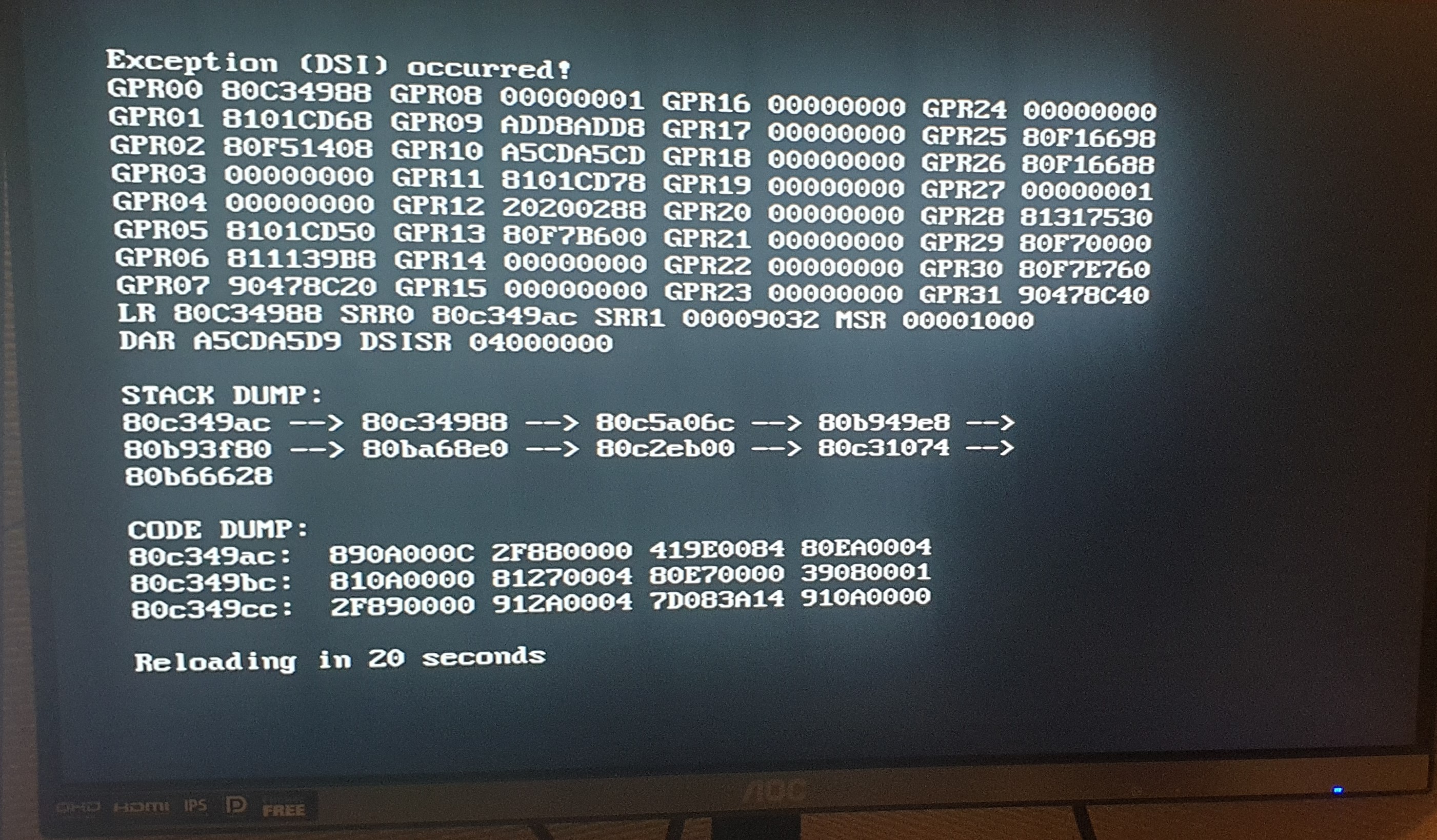

So tested a few more things... Most interesting is Test #12 where Usbloader GX actually boots with two FAT32-partitions totaling 2500GB.. There are graphical corruptions and I cannot launch games but it works.
I uploaded screenshots to onedrive at: https://1drv.ms/u/s!Ag1uaIt_1fBWzXvHnB_pwRgZJEXD?e=lSnBlk
The DSI exception seems to be consistent for both Usbloader GX and WiiFlow Lite.. (its the same for each launcher each time)
(To lazy to create a proper table now, so here is a screenshot. An Excel-sheet is present in Onedrive)

I wouldn't have thought both GX and Wiiflow would generate the exact same dsi. I guess they use the same sources for drive access.

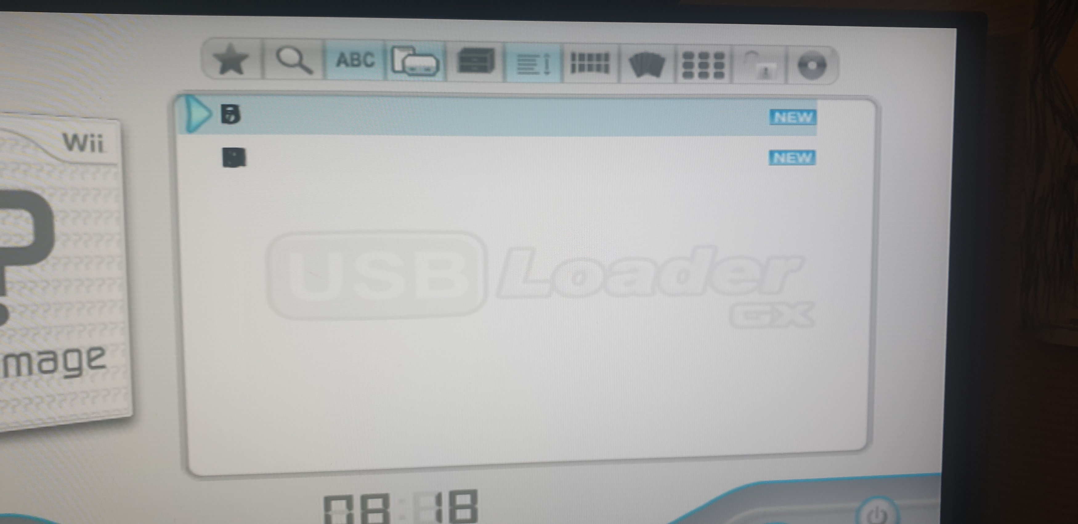

It works fine - until I enable multiple partitions.. Then "graphical corruption occurs". Right of the bat this happens:
Now I need to hard reset. When I launch Usbloader again this happens:
Now there should be one game on each partition. Choosing the topmost-game (de Blob), I get the splash but cannot longer run it (black screen then return to HBC)... The 2nd game cannot be read at all...
I will test with two games on second partition to see if it actually finds all games, or its just repeating the first one.

(Correct me if I am wrong) - Yes. But 8TB FAT32 entails that you have 4K Sectors, and therefore just need 32-bit addressing to get the correct LBA. So perhaps there is something wrong with addressing sectors above 2^32?
I have attached screenshots. Note that USBLoader GX and WiiFlow have different DSIs.. What I mean is that the three DSIs I got from Wiiflow looks identical (granted I have not read every number and compared, but what I looked at looked equal).
Test11-DSI-USBLoader:
Test12-DSI-WiiFlow
Now I tried looking at the source of USBLoader GX - now I have very little C and no C++ experience, but somethings that look out-of-place to me are among others:
Partititionhandle.h:
               u32 GetLBAStart(int pos) { if(valid(pos)) return PartitionList[pos].LBA_Start; else return 0; };
If u32 is unsigned int 32-bit... That would not work if the partition is created over the 2048-gb mark (LBA 2^32).
        u32 GetSecCount(int pos) { if(valid(pos)) return PartitionList[pos].SecCount; else return 0; };
This would mean that a partition can have at most a size of 2^32 sectors, which means 2048GB with 512-byte logical sectors.

we can try to change that to unsigned 64, and see if it's enough. there might have other place where we need to change it.
Here is the result of the code dump trace back:
it gives all the stack from the error (mem2 alloc) to the first called function (menu.cpp)
it's a good start to know which files to look at and will need an update.

BillyBlaze, thanks for pointing at these sources.

Again, I stress that I am on deep waters both regarding C/C++ and the Wii in general. However, I do read and know something..
Now suppose that USBLoader GX is able to do 64-bit addressing... Now a game is launched, if I understand one of your guides, Usbloader GX is no longer running... but the data is read through cIOS? is that correct? And for most cases that cIOS would be d2x
Now I recon that this is the source for d2x cISO:
https://github.com/davebaol/d2x-cios
I also see here u32 pointers/datatypes for sectors (usbstorage.c etc).. Which in my head means it won't be able to run them... This might also be true for libfat etc and other things that would have to be fixed.
billyblaze, you are right. it'll depend on the cIOS to access these LBA addresses.
I suppose to test it we would require an update of both the loader and cIOS (leseratte is working on new modded versions).
