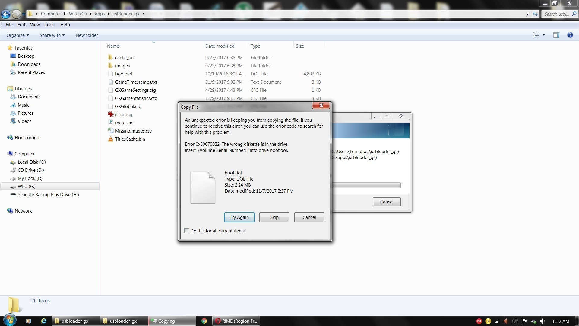

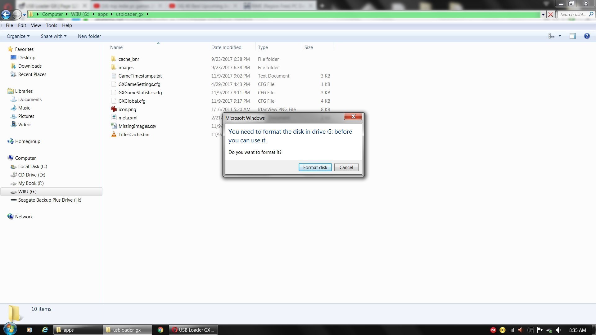

omg wtf. those files kill my sd card. this is the second time. I thought it was something else but it did it again now. it tells me i have to format sd card after i get an error copying the 1266 files onto it.

Unless, the issue is the new libfat. (but it's the one provided by devkitpro, the only change I did was to add ustealth support)
but like said, if the error is when exiting a game from nintendont, then it's something nintendont did (crashing while writing the savegame file?), unless you saw the USBGX icon on screen before the crash (it's the forwarder's logo, no code change happened in the forwarder either)
maybe USBGX is crashing because the SD card is bad/file table corrupted.
SD corruption is done when it's crashing while writing (or ejecting before safe-removing it). maybe nintendont crashed while writing the savegame to SD and corrupted your file table.
I hope we find the cause, I wouldn't like if it's the loader's cause.
I didn't release 1265 "officially" yet on sourceforge. latest version is still 1262, to prevent massive issues like this (if it's the loader's cause).
It shouldn't be libfat. I've been using it for months and haven't had any of those issues, but I'm using the wrapper class I posted last month rather than a modified libfat. I do need to add the stealth thing to it, though.
@comput3rus3r Try a different SD card or run "chkdsk /f" on that one. It looks like it's going bad.

on your screenshot, there's no visual element stating the SD is bad.
when the filetable is corrupted you usually get random symbols instead of filenames.
can you read from it ?
make a full backup and format it, maybe it will fix your write issue.
cant read it acts like it's not formatted at all
Usually the "wrong disk is inserted" error occurs because the storage medium is disconnecting unexpectedly. It saw the drive but it was gone by the time the shell tried to access it.
Try cleaning the contacts with a bit of alcohol on a cotton swap and blow out the card slot.
