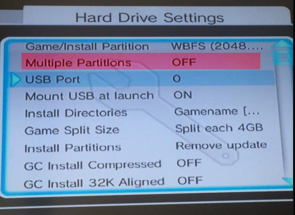

Can you please make a Screenshot from the Hard Drive Settings Page from USBLoader GX please ?
Specially the first Line with the Game/Install Partition Entry please ?
And only to get sure please,the HDD is connected to Port 0.:)

sorry about that, here's the screenshot
Thank you.:)
Ok,something is wrong there.
You have an 150 GB FAT32 HDD in Windows
and
You have an 2048 GB (??) WBFS HDD in USBLoader GX
How is the Size of the HDD please ?

Please try and turn the Option "Multiple Partitions ON".
Can you maybe choose then above the 150 GB FAT32 Partition ?
Thank you.:)
These two option are unrelated !
the "multi partition" option is not used to choose if he wants to switch partitions or not.
it's used to display games from ALL existing partitions, and "STOP USING" the first option as "partition to display games from".
Not enabling multi partition only let the user pick "one single" partition to display games from, and it's the partition chosen in the first option.
when using multipartition, the first option is still used as "partition where disc dump will be copied to".
but not as "partition to display games from", as games will be displayed from all (8 max) partitions.

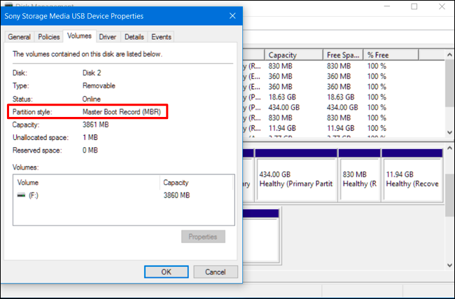

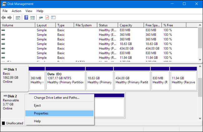

Alexander, Did you notice his HDD partition manager displays "basic" instead of "removable/external hdd" ?

- if you use the Windows Format Option that your HDD is recognized as MBR and not GPT please.

Please check

okay so i formated to ntfs and then with command promts i made it MBR and the used the fat32 formater that comes with modmii, nintendont read it too (although i didnt put gc games yet)
