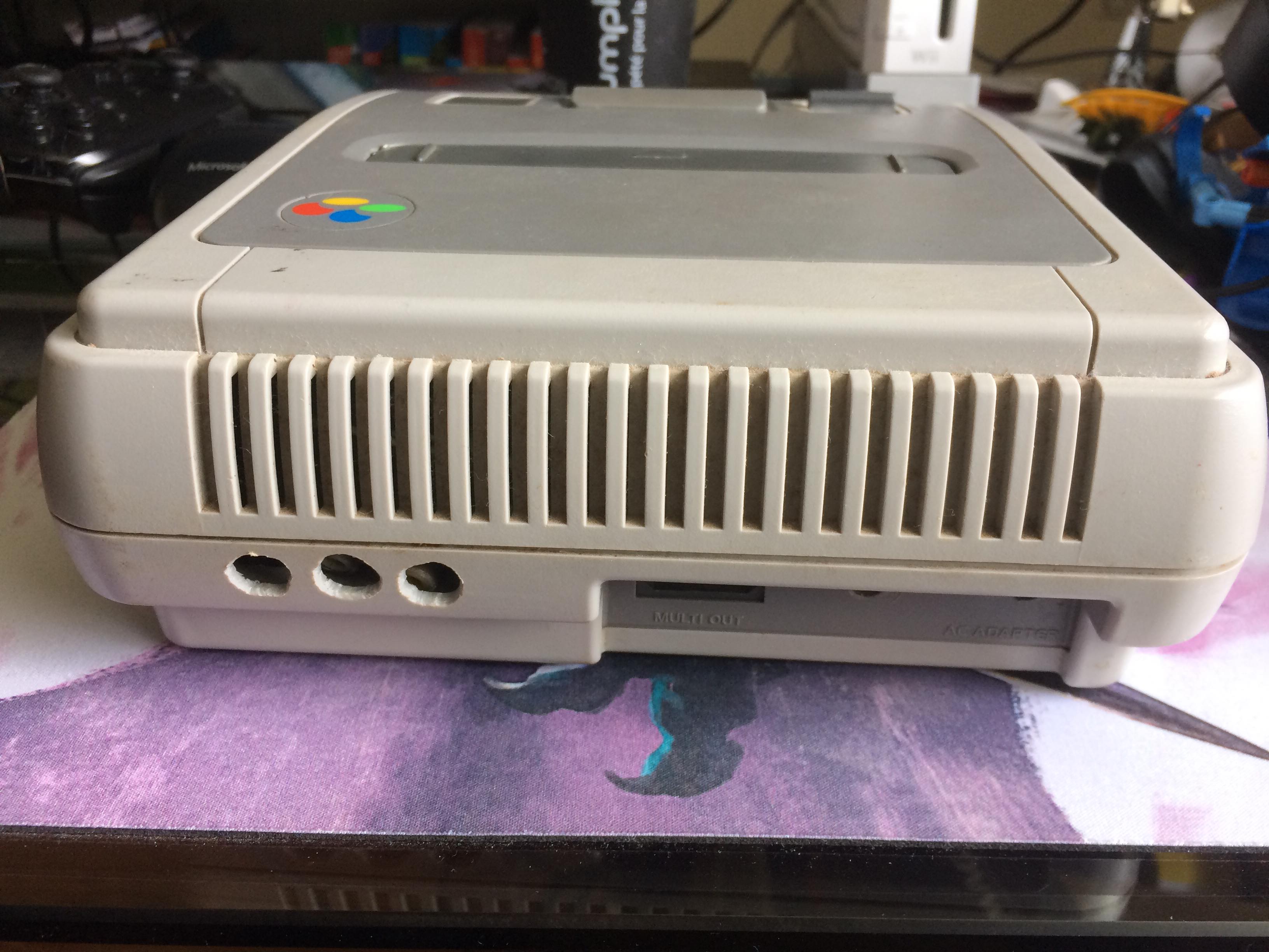

Hi everyone.
A few years ago, I was gifted a second hand PAL SNES. Now that I look at it though, I think it may be modded ... Anyone has an idea ? I'll take it apart later today and keep you updated.

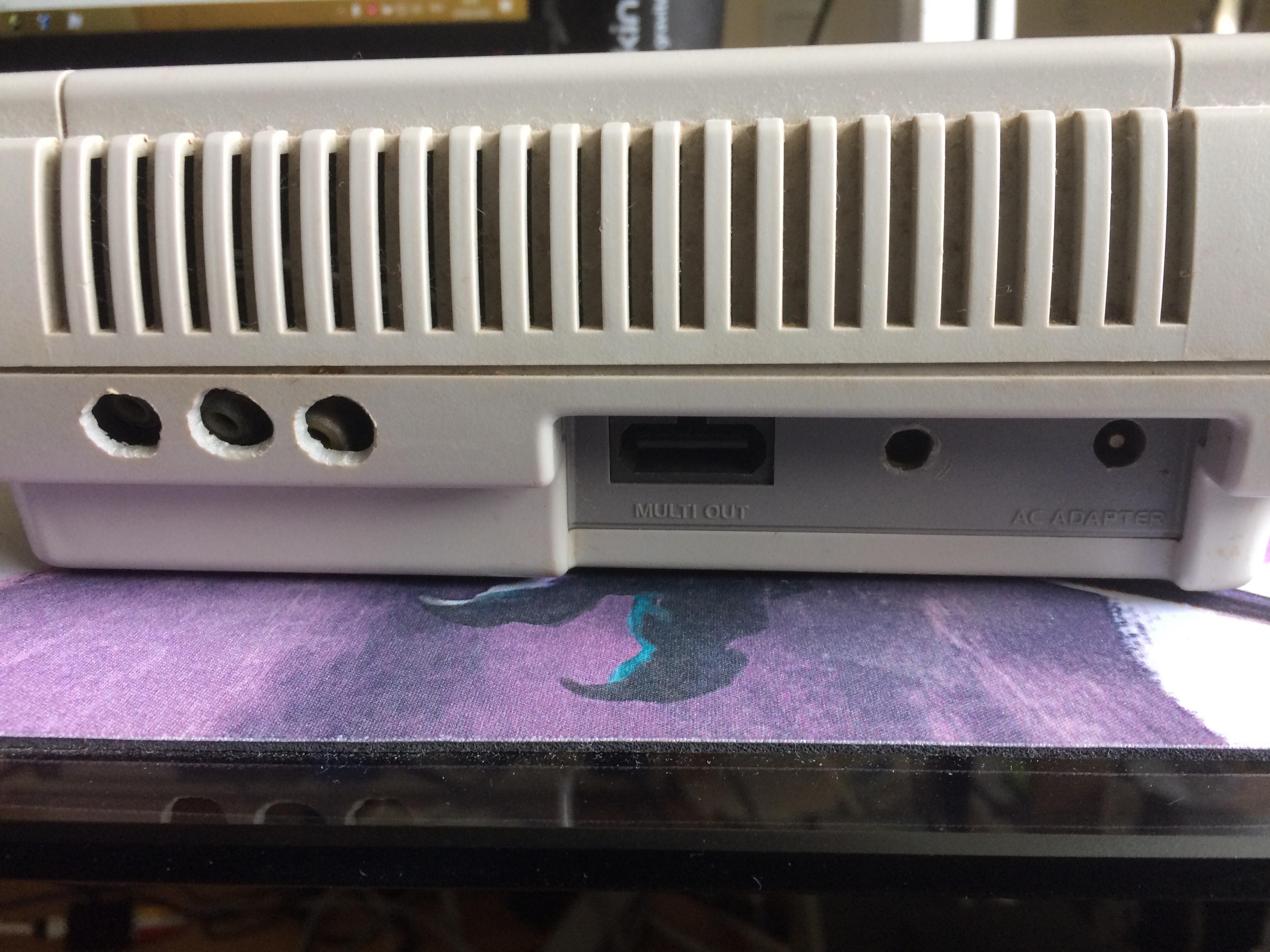

Yikes, that looks butchered. Second the RGB mod, but more likely a component mod, since PAL SNES already outputs RGB via multi out. Wouldn't keep that, as it looks seriously shoddy.

Shody is one way to say it. If I find myself a game bit, I'll take it open and look at what I can do. Though 3 is a bit short for component ain't it ?

Not if the multi out is being used for sound. Three outputs for YPBPR and then take the left and right audio from the multi out.

If it does not include audio then two of the five (the red and white ones) are audio and that leaves 3, which is what most video standards use regardless of whether they are RGB or have some fun with luminance and chrominance.
Also if you are going to tidy those up pick yourself up a tapered reamer, handyman's reamer, step drill or something similar and make it nice (don't know French terms offhand). I am actually impressed someone made holes that bad in plastic.

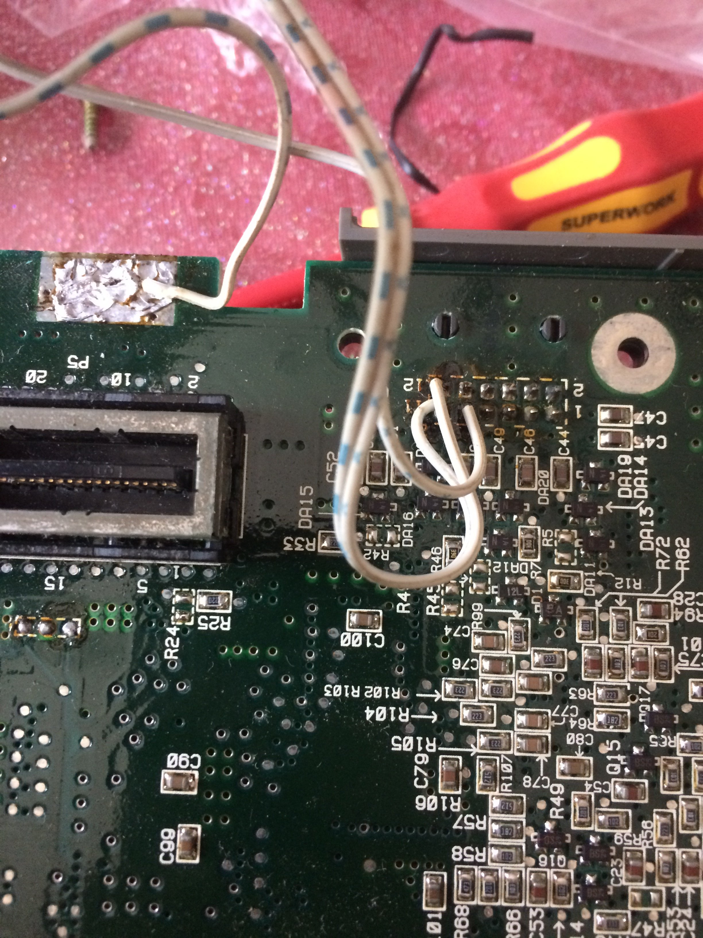

4 wires on 12 pin header. 1 wire just being a ground so I am guessing they are commoned up there.
In their numbering 9,11 and 12.

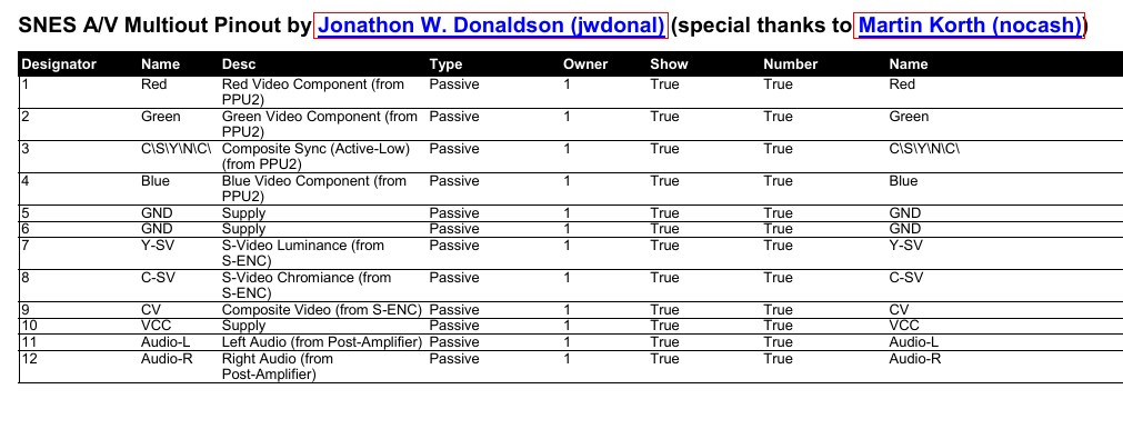

If it is the same numbering then that is composite video and left and right audio.
Screenshot of the PDF from the second link above
That is an odd thing to do but if the port is broken or they lacked a SNES lead then eh. For the effort considering far more useful pins are right there
Hard to tell from those shots but it looks like
wire marked "X" goes to 12 (right audio)
wire marked "-" goes to 11 (left audio)
Both those are stuck together still as they leave the header in https://gbatemp.net/attachments/104001801_612766145999475_7760378687571555561_n-jpg.213195/ they look like they might still be stuck together.
In which case X (right audio) goes to the middle and - (left audio) goes to the left in that image (not the yellow one).
Another Free floating "-" is the ground, there are several nice grounds on pins 5 and 6 but to each their own I guess.
What looks like X and free floating is going to 9 (composite)
If the person doing the mod did the colours conventionally then the yellow should be the composite out. It does have a X going to it.
Edit short version if I am right
Right/most towards the front/yellow should be composite out
Middle should be right audio
Left (most towards the back, not yellow) should be left audio.

Thanks for the analysis ! So this definitely looks like an output mod, but I can't really comprehend why they would do it this way. I'm not even sure it would be a good idea to actually look at the signal I'd get from this
The SNES video cable is custom so if they lacked one for whatever reason (I believe it was shared with some other things) then that is a quick and easy way to simple connect it to a commonly seen TV (RGB and component was not that common on European TVs until not so many years ago, indeed RGB still is not) or VCR with commonly available cables, not to mention it might also be a step up if the only cable they had was RF before that.
