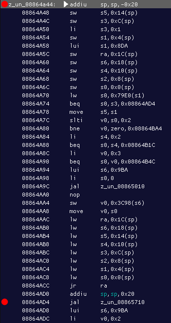

Hello
I have a PSP game that I want to apply a "patch" for, by reading a file I have inserted into its ISO. The file contains the script (dialogues and choices since it is a visual novel) of the game, decompressed and then edited. Which is supposed to be read and inserted into a specific memory location where the game's script resides in RAM (0x08DD9A80 ->). This has been confirmed to work by externally injecting bytes into that location, using a modifed version of PPSSPP (hardcoded function calls into it when a button combination is pressed, to insert all the bytes of the file into that specific memory location). (The game would not respond to cheat scripts, so went with a less common option for verifying that changing the script worked without issue).
The process has been this:
1. Identify where in the game I can insert my patch safely by checking instructions with PPSSPP, as well as Ghidra.
2. Successfully found a spot, and inserted my new function into it (by manually inserting it into the EBOOT using a hex editor after compiling the instructions, and hooking a function call early when the game starts up).
3. The function is executed and the game safely returns back to normal operation, no issue here.
Now then, the issue is that the file I am trying to read from the ISO simply cannot be "read". I am able to open it using sceIoOpen which provides me with a valid FD, I can then use sceIoLseek the file to get the file size (which works). But I am unable to read the file, all attempts lead to the error code 80020323, despite a valid FD (that was able to be used with seeking the file). PPSSPP does not log this error though (BADF log for example), but it does if I give it an invalid FD.
What I have tried:
1. Insert running my own thread. No change.
2. Use async reading instead, if anything may block the synchronous reading. No change (async read returns v0 = 0x0, a successful queue, but async wait also returns v0 = 0x0, thus no reading was performed).
3. Recreate the setup that the game originally uses for reading files (from what I could tell: Open the file, changeAsyncPriority(?), Lseek to the end then rewind, syncRead). This still did not work.
4. Began writing to uncached RAM instead of cached RAM (0x48DD9A80, which later on will be moved over to its cached counterpart.) I used to try and write to the cached RAM section, however since that failed I switched to uncached instead. No change was observed for reading though.
The game does read files right up to the point where I insert my function, well of course one would think that there is something blocking my read perhaps but not at the moment where my function is being executed. I hijacked the call to "install game on memory stick" to call my patched function instead. Doesn't matter if I place my function right at the start of the game either, as IoOpen & Lseek succeeds but any reading fails.
I will provide the function I currently use (it has a looping issue right now but that is not what I need to be fixed, that is something I can work on later. I need assistance with figuring out why reads fail). I apologize if the instructions are quite messy, I am not well knowledgable in writing 32 MIPS myself so had to consult chatGPT for most of the generating of instructions.
The registers contain the correct values all throughout the function, they do not get overwritten elsewhere during execution (for example FD is valid until I close it, it is not overwritten). Due to a whole lot of testing and messing around with the instructions, there may be other issues you can find but if someone could see where the reading issue lies that would be greatly appreciated.

The error occurs immediately after executing sceIoRead. Which returns v0 = 80020323 (BADF). So it never gets to the point of looping. So to answer your statement “a0-3 may be destroyed by the first call”, that is correct, all those registers will be turned to "deadbeef". But the reading itself already failed once it tried to execute the first time, not the second time (which never happens). So yes, any call to the syscalls will destroy any value in the registers, and I then have to fill them again (by saving the values prior to using any syscall). But the second loop never executes since the first call already errored out. However, you are right that I need to save the registers.
I have tried by reading just 64 bytes from the file, no loop, which also results in 80020323 from any form of reading (async/sync). Even trying to read files that the game already reads normally during startup (the original script file) also fails within my function.

Is the location where I execute my function one of the possible issues? Right now, I use 2 functions in my patch. The first is executed at start-up of the game and overwrites the menu choice for installing the game on the memory stick to calling my other script loader instead. When the player presses the install menu choice, the area they are in within the code is inside of a routine (similar to a hub, where it loops over and over again to check certain conditions). It will therefore execute some other routines (waiting until the game has been idle enough to show the intro movie, etc).
When I press the menu choice for installation it will execute some routines that belong to the installation setup, but then branches in the middle of it to my function, before any installation is performed. I don't know how well the images will capture any of this behavior and make it more clear, but it is possible to see where I have edited the code to branch over to my own function that resides at offset 0x08890E60.
I have tried to move the execution of this loader script to the very beginning of the EBOOT, so it will begin by executing my loading script before performing anything else. This did not change anything however, and reads continued to fail.
Is there some prerequisites towards reading a file that I am missing?
