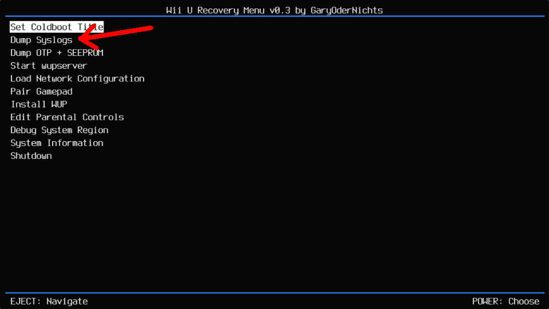

So what's this recovery menu? The recovery menu allows you to fix several bricks:
screenshot
Wii U Recovery Menu​
A simple recovery menu running on the IOSU for unbricking.
Options​
Set Coldboot Title
Allows changing the current title the console boots to.
Useful for unbricking CBHC bricks.
Possible options are:
  • Wii U Menu (JPN) - 00050010-10040000
  • Wii U Menu (USA) - 00050010-10040100
  • Wii U Menu (EUR) - 00050010-10040200
On non-retail systems the following additional options are available:
  • System Config Tool - 00050010-1F700500
  • DEVMENU (pre-2.09) - 00050010-1F7001FF
  • Kiosk Menu - 00050010-1FA81000
Dump Syslogs
Copies all system logs to a logs folder on the root of the SD Card.
Dump OTP + SEEPROM
Dumps the OTP and SEEPROM to otp.bin and seeprom.bin on the root of the SD Card.
Start wupserver
Starts wupserver which allows connecting to the console from a PC using wupclient.
Load Network Configuration
Loads a network configuration from the SD, and temporarily applies it to use wupserver.
The configurations will be loaded from a network.cfg file on the root of your SD.
For using the ethernet adapter, the file should look like this:
type=eth
For using wifi:
type=wifi
ssid=ssidhere
key=wifikeyhere
key_type=WPA2_PSK_AES
Pair Gamepad
Displays the Gamepad Pin and allows pairing a Gamepad to the system. Also bypasses any region checks while pairing.
The numeric values represent the following symbols: ♠ = 0, ♥ = 1, ♦ = 2, ♣ = 3.
Note that rebooting the system might be required to use the newly paired gamepad.
Install WUP
Installs a valid signed WUP from the install folder on the root of your SD Card.
Don't place the WUP into any subfolders.
Edit Parental Controls
Displays the current Parental Controls pin configuration.
Allows disabling Parental Controls.

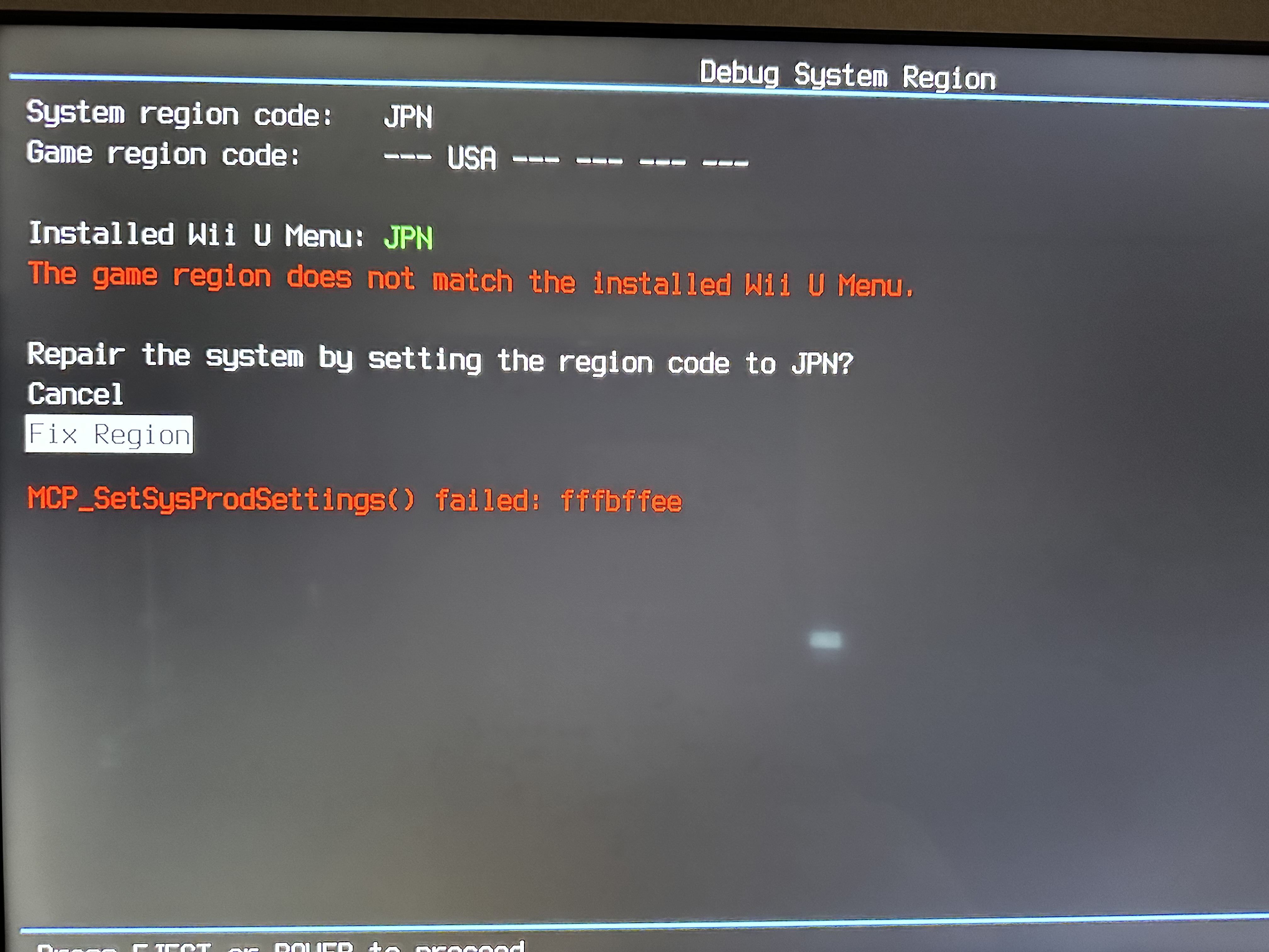

Debug System Region
Fixes bricks caused by setting productArea and/or gameRegion to an invalid value. Symptoms include being unable to launch System Settings or other in-region titles.
System Information
Displays info about several parts of the system.
Including serial number, manufacturing date, console type, regions, memory devices...
Load BOOT1 payload
Loads a payload from the root of the SD Card named boot1.img and executes it from within boot1.
If the file is named boot1now.img it gets loaded automatically when starting the recovery_menu after a 5 second timeout.

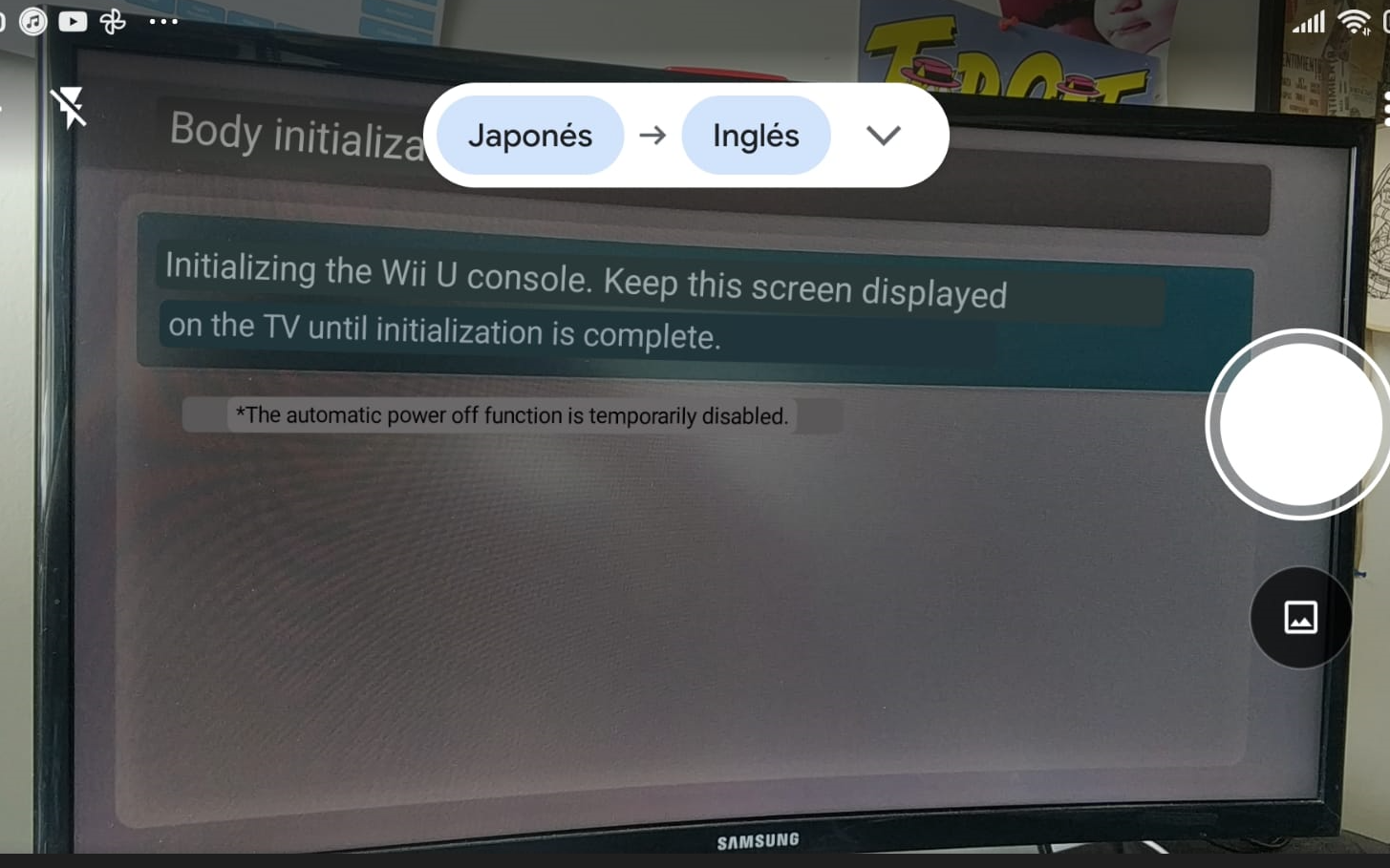

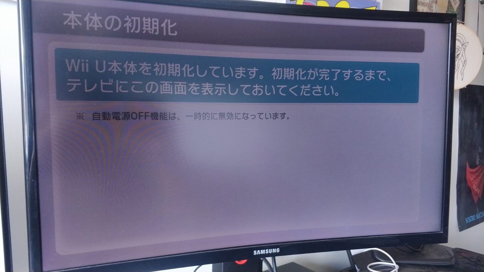

Hello, could this solve my problem? when formatting the console (JAP 5.5.5), it rebooted and got stuck in this window, the console was never modified :(
Reactions: Augusta

Don't try anything but grab the logs and upload them to here.
//EDIT:
Dump Syslogs
Reactions: Augusta
No logs, no service. Really, Grab the logs before you break even more.
