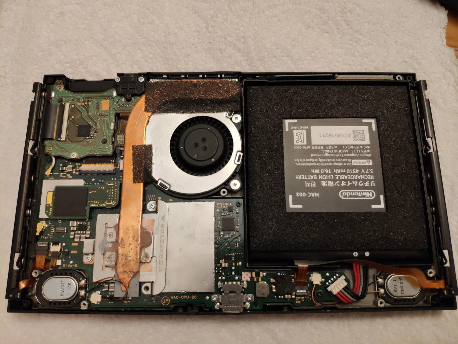

The previous owner told me it had fallen down the stairs, I guess the left joycon took most of the damages, it's missing its rail and buttons.

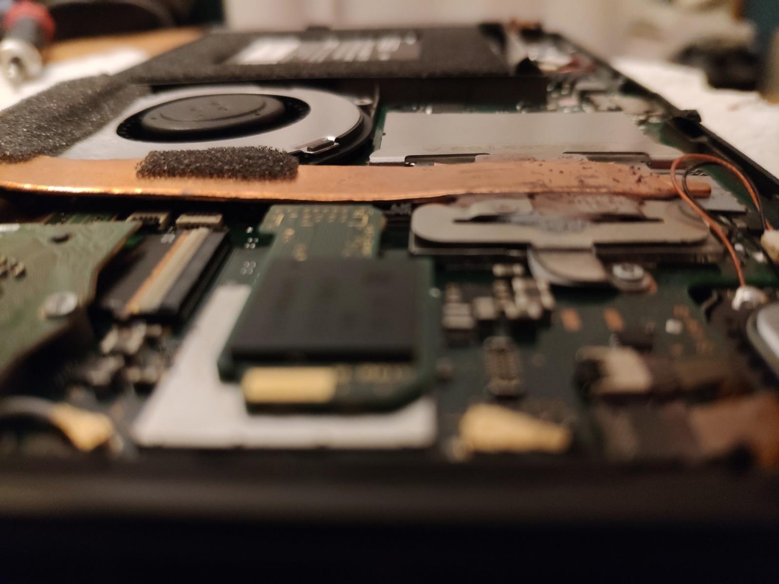

About the Switch itself, I found it was already open: some screws are missing, the right joycon cable was not put back correctly, the heatshield is bent, even the heatsink seems warped:
There is even thermal paste on the BQ24193 :

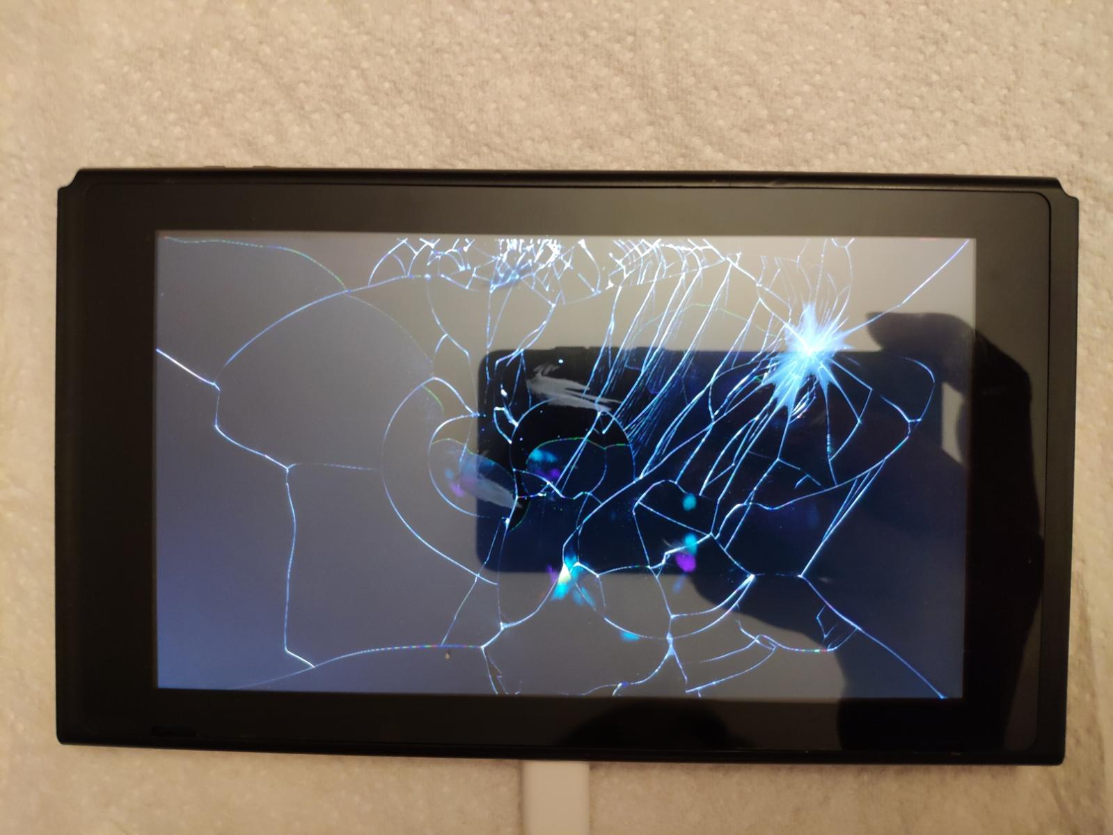

I don't have a jingle on boot, when I plug it on the dock its green led switches on for only a second, nothing appears on the TV but the screen switches on:
Because the fan doesn't turn I believe it's only the backlight showing broken screen pieces.
If it was only a broken screen, at least I should be able to use it with the dock right?

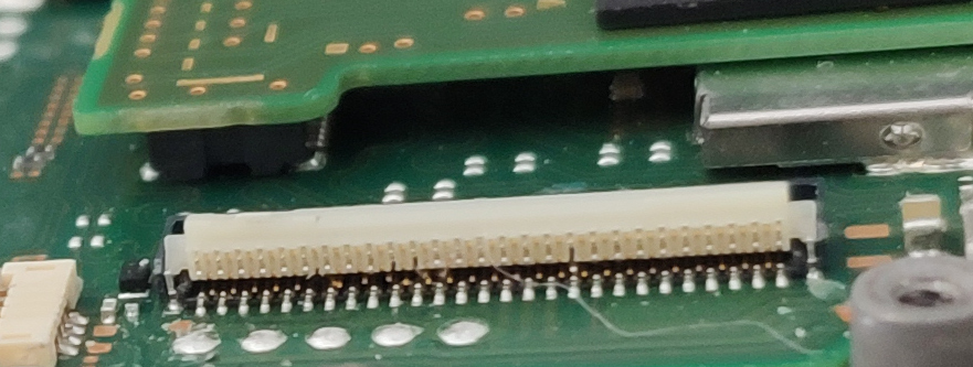

When I opened it to unplug the battery I realised the screen was not correctly plugged, I believe it was showing random stuff while I thought it was showing the charging icon.
But when I tried to plug it correctly, I discovered the genius that opened it managed to bend some pins on the connector :angry:
I will try to straighten them up, at worst I found it on Aliexpress for $2.5.
If the Switch doesn't try to detect the screen and the touchscreen during its boot sequence, I should be able to use it with the dock if I remove this connector right?
Small update: I did my best to straight the screen connector pins back, 2 or 3 are still bent.
Now I have a solid blue screen when I power it on normally. Its serial is "possibly patched", fusee-launcher was able to send hekate but it gives me a black screen with no backlight.
Should I change the screen connector or this Switch is dead?
