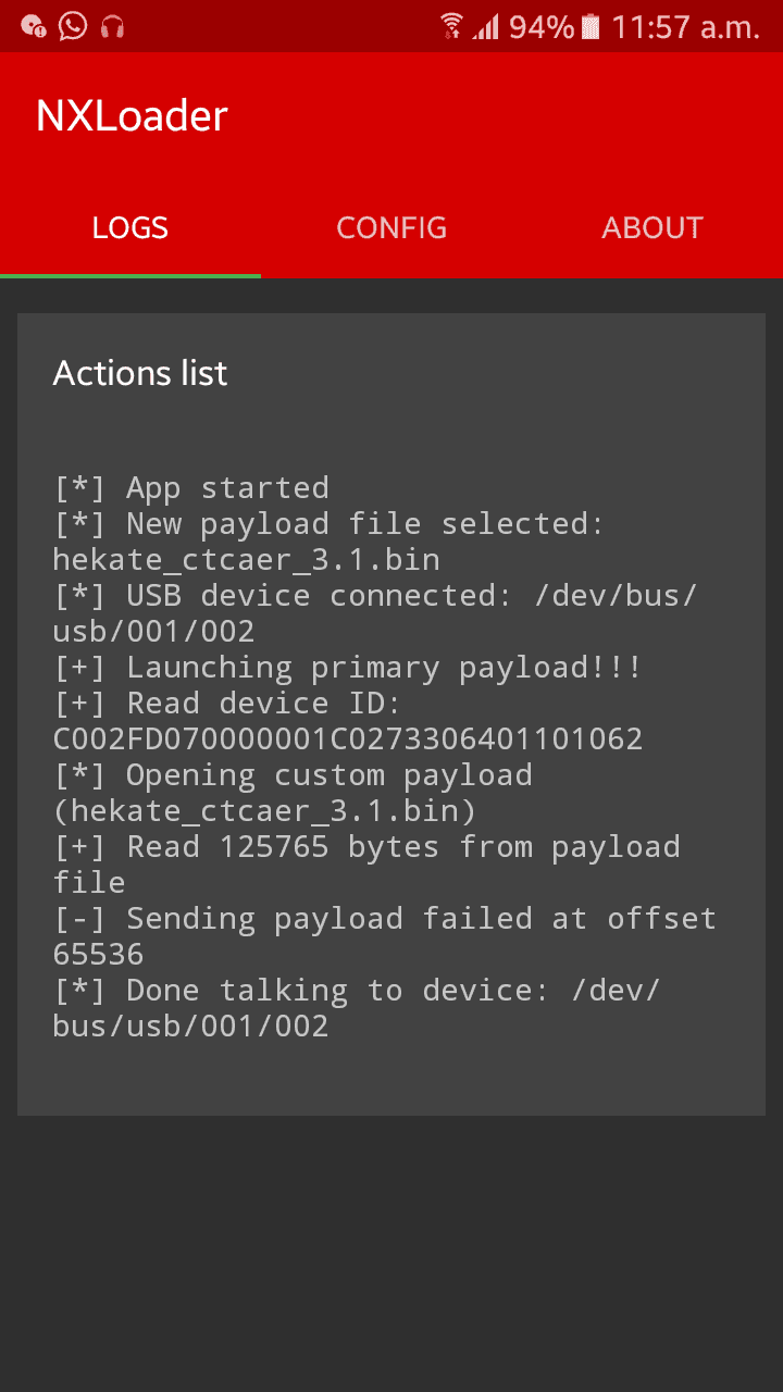

Am getting this..any help please

are u using your phone's original cable ?
if you do change the cable .
i tried with s8's and note 8's and s7 edge's none of them works . changed the cable and the problem was solved .
NXloader Just Doesn't work with some Cables
And have you tried that same cable with the a PC? ('casue i don't any other cable and every single one i can find is chinese shit).
Yeah the Samsung Cables that doesn't work with Work With PC. I used a Huawei Cable and it worked , used a nillkin cable and it worked too.
Am using anker cable with the required resistance..and a otg cable conected to my phone tho idk what am doing wrong here!!
im kinda sure that its the cable. i had the same error and it was fixed when i used another cable.
