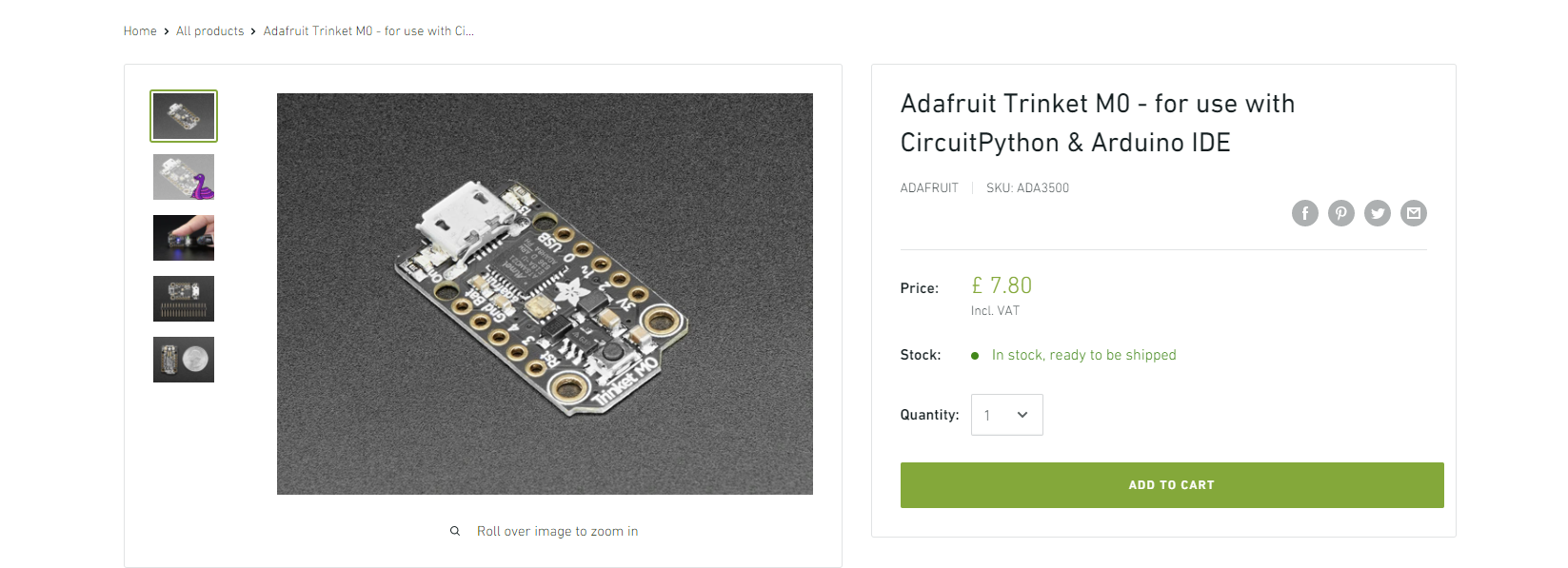

I see, seems like it would be a good addition to a V1. I searched it up and I see that there is a black colour trinket and a blue colour trinket. what's the difference between them?

Yes that's the one. Before spending your money, it's probably worth researching what's involved, there's a guide here. Before fitting, the USB port would need to be removed, and the soldering to the Switch itself is apparently moderately tricky, so you might want to find someone with the skills if you're not adept at that stuff yourself.

It should be clarified that the USB port of the Trinket needs to be removed, not the Switch.
But yes, the spots are overall very small. I've been soldering and modding since early PS1 days and the Switch is still a challenge.
