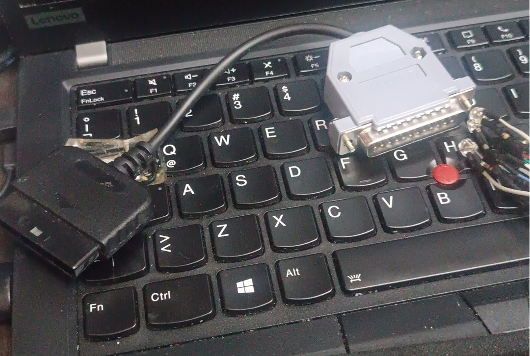

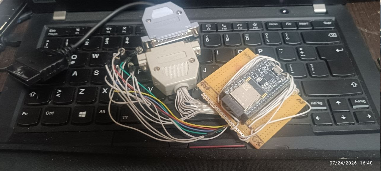

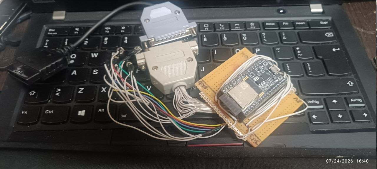

I am making a BlueRetro adapter using the DIY schemas and a ESP32-DevKitC and works very nice, I am using the DB25 interface so I can use on multiple consoles, so far I am using it on my PS one and my Family Computer.
This is a Quick and Dirty prototype next will be a correct PCB and a 3D Printed case.
DB25? Where do you connect that? i'm assuming you use some adapter for each console conector type?
The Kit have a DB25 female connector and for each console I made an adapter which at one side have the console controller connector and the other end a DB25 male, is like changing the connectors on the ESP32 to match the console you like to use.
There is a multi console firware which autodetect which console you are using.
Now take this prototype and work it into KiCad so that you can produce these boards.

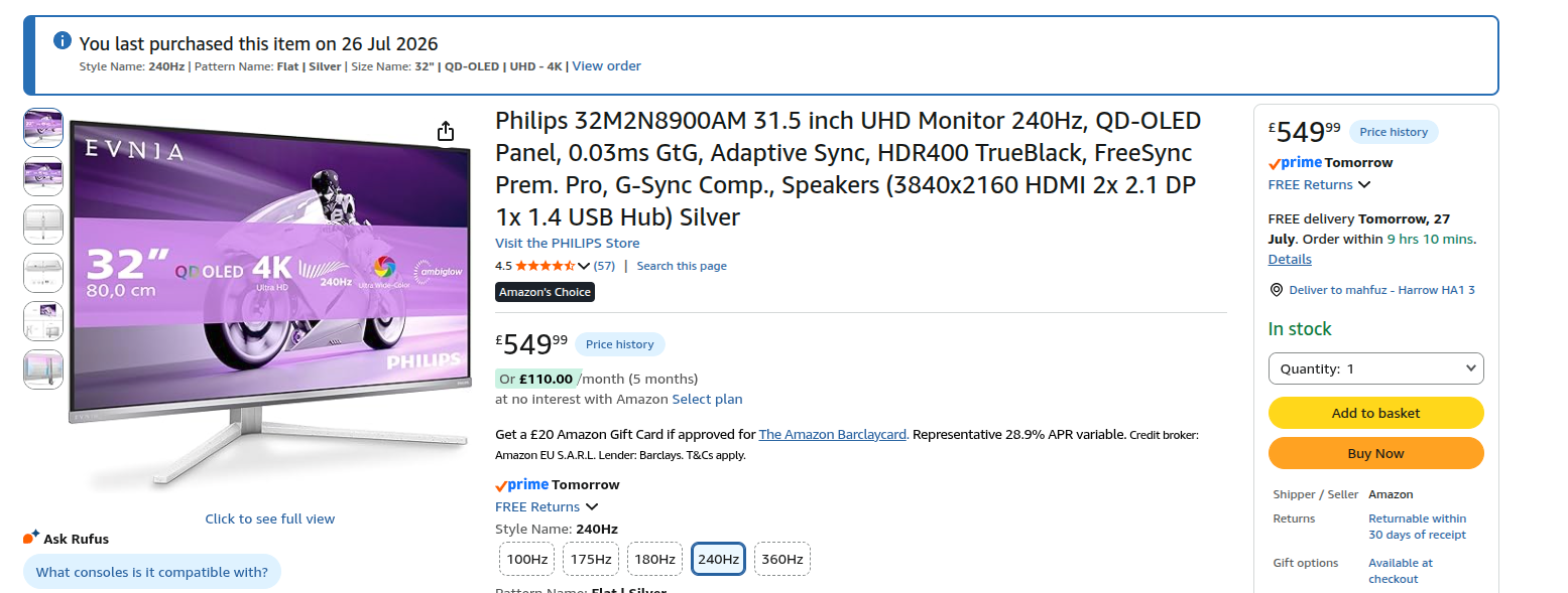

Why would you put 32" on the image and 31.5" on the description? Hope someone was fired for that blunder.
Very cool. Now you only need to print a case for the esp32 board.
