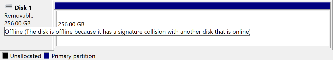

Is anyone getting this with the Dumper on Windows 11, even after the 1.1.6 update? Interestingly, the update is 119KB, but when I drag-and-drop it, wait for the light to finish flashing, unplug and replug the dumper, the file shows as 279KB. I have tried updating it on both Android and Debian to no avail.

you can read the previous post, the late firmwares have a problem which can cause the collision.
you can solve temporally the problem by using diskpart to change the collision and put online the disk:
https://www.minitool.com/news/fix-disk-signature-collision-problem.html
it's on the post:
https://gbatemp.net/threads/the-swi...-switch-unlockswitch-etc.651852/post-10512407
Additionally a file of 200 bytes can be shown on your disk as 32Kb, 512Kb, etc, that have to do with the cluster size of the current partition format, the cluster is the minimum quantity of information you can write on disk, each file is stored as cluster size chunks and the last one will use on disk more space than the file data size. That's why Windows on the properties of a folder or file shows you «Size» and «Size on disk»
