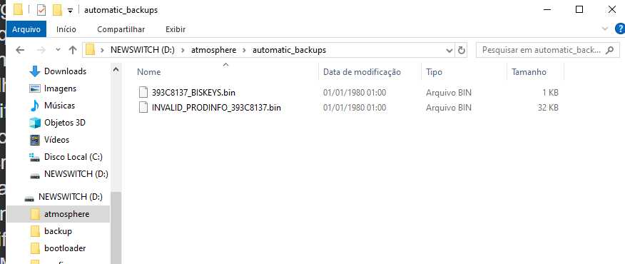

I have the same problem and I have these two files, can they be of any use?
