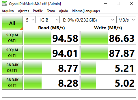

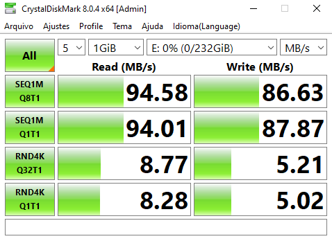

This is what I got with the Kingston Canvas Go Plus!
It's just a old random test I did once, but I'm sure it goes a bit better since this is using my old 2011 PC and I didn't even tested on my I7 laptop with PCI-express card reader which could get more. But sure just like Sandisk if you buy their overpriced card reader you can get above the UHS-I speeds around 170MB\s but that's all BS as it needs software on windows.
