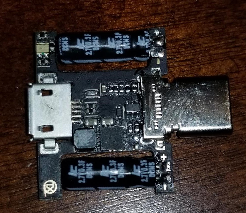

I know this is an old post... but I recently ran into issues with my SX pro. It took multiple attempts to send the TX payload and the thing eventually stopped charging altogether.
I opened up the case and saw a solder bridge between the +/- pads for one of the super caps. I removed the bridge but the short didn't go away. So I took the cap off and found that it was internally shorted.
Looking for a replacement the nearest thing I could find was p/n HP-2R7-J354UYLL made by a company called Kamcap. It has body dimensions of 5x12mm and is a 2.7V 0.35F supercap with 2mm lead spacing. You can't buy these things locally, and I didn't want to wait a month for a shipment from China.
So I did some digging and found this as a replacement p/n 304DCN2R7SCBB. It is a 2.7V 0.3F supercap made by Illinois Capacitors. Its body dimensions are 4x11mm and the lead spacing is 1.5mm. These are readily available on digikey and mouser.
I ordered them from mouser and replaced both caps on the SX pro. The thing is working flawlessly now! It sends the TX payload on the first try. Attached is a picture of the new caps installed on the SX pro pcb. Hope this is helpful to anyone who is looking to do repair work.
2.jpg​
