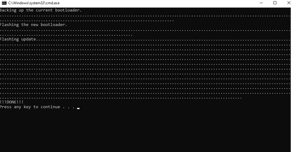

I guess this means its an original? Now i just need to install it and find a tutorial on how to get Atmosphere installed and working :) Thanks chaps
This seems a good sign, now to figure out how to get it to boot a payload and get atmosphere up and running
