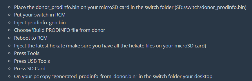

  1. Repair Method 1: ProdInfo_Gen + HacDiskMount OR NXNANDMANAGER
    • Place the donor_prodinfo.bin on your microSD card in the switch folder (SD:/switch/donor_prodinfo.bin)
    • Put your switch in RCM
    • Inject prodinfo_gen.bin
    • Choose 'Build PRODINFO file from donor
    • Reboot to RCM
    • Inject the latest hekate (make sure you have all the hekate files on your microSD card)
    • Press Tools
    • Press USB Tools
    • Press SD Card
    • On your pc copy "generated_prodinfo_from_donor.bin" in the switch folder your desktop

No I downloaded it from the thread I linked. From the tutorial:View attachment 345929
(With the donor_prodinfo.bin file being provided)

With your tutorial I wasn't able to run prodgen correctly, it was throwing the error I shown above. In the video it works with another, wayyyyy more complex procedure which somehow ended up working.
