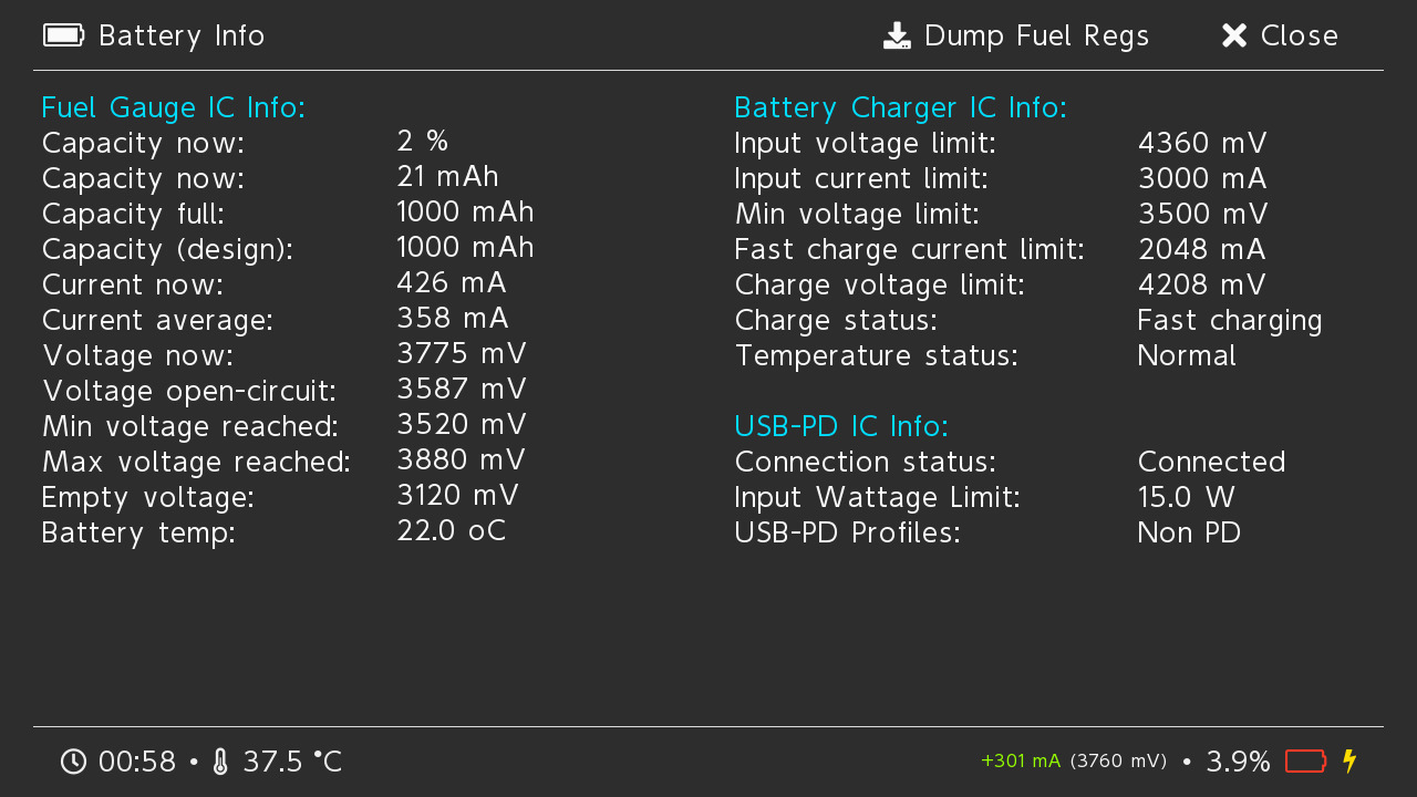

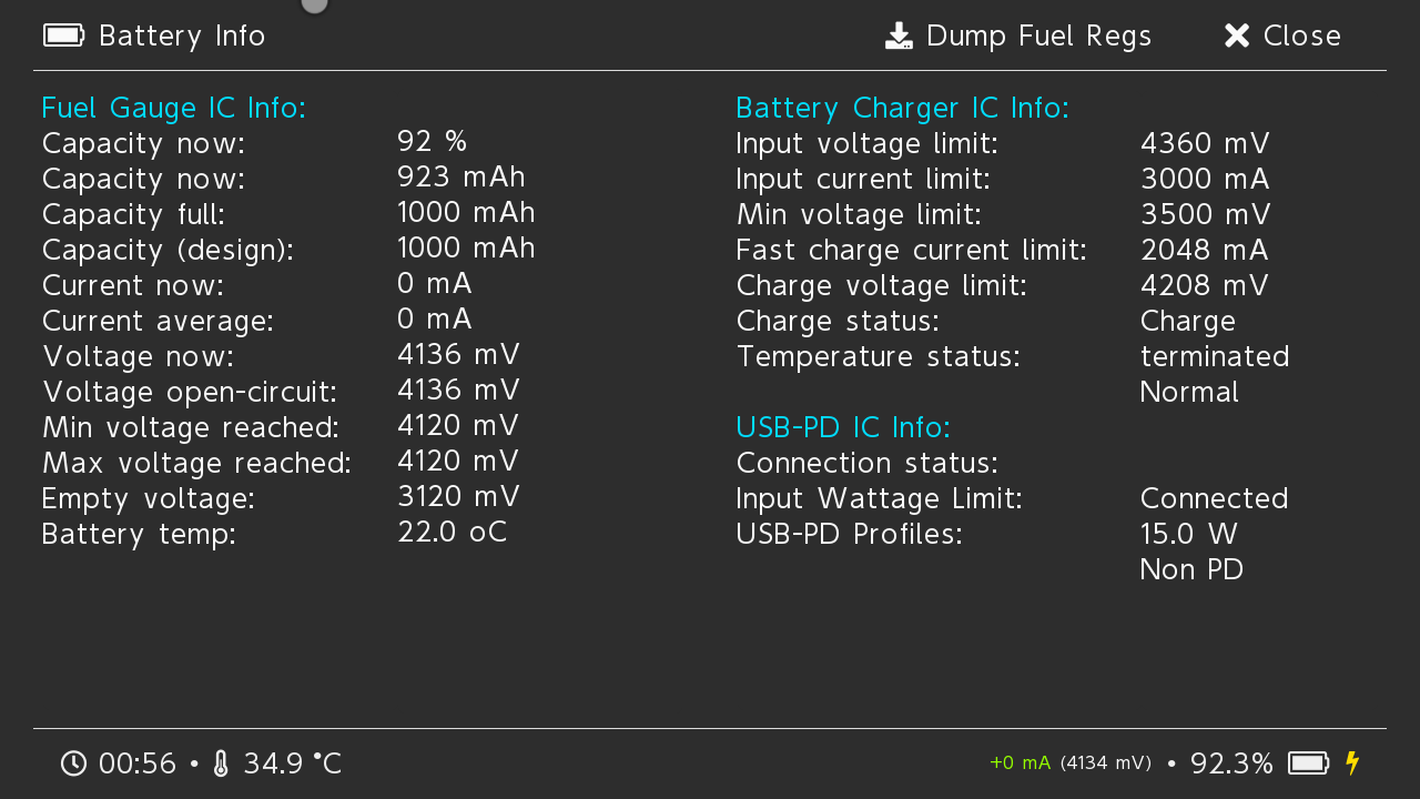

What does hekate report for battery stats?
I would say they are correct?
It shows 0ma charging & charge terminated but looks like it is plugged in charging. Is this plugged into a computer or a charger?
You're right that's strange, it was on my computer.

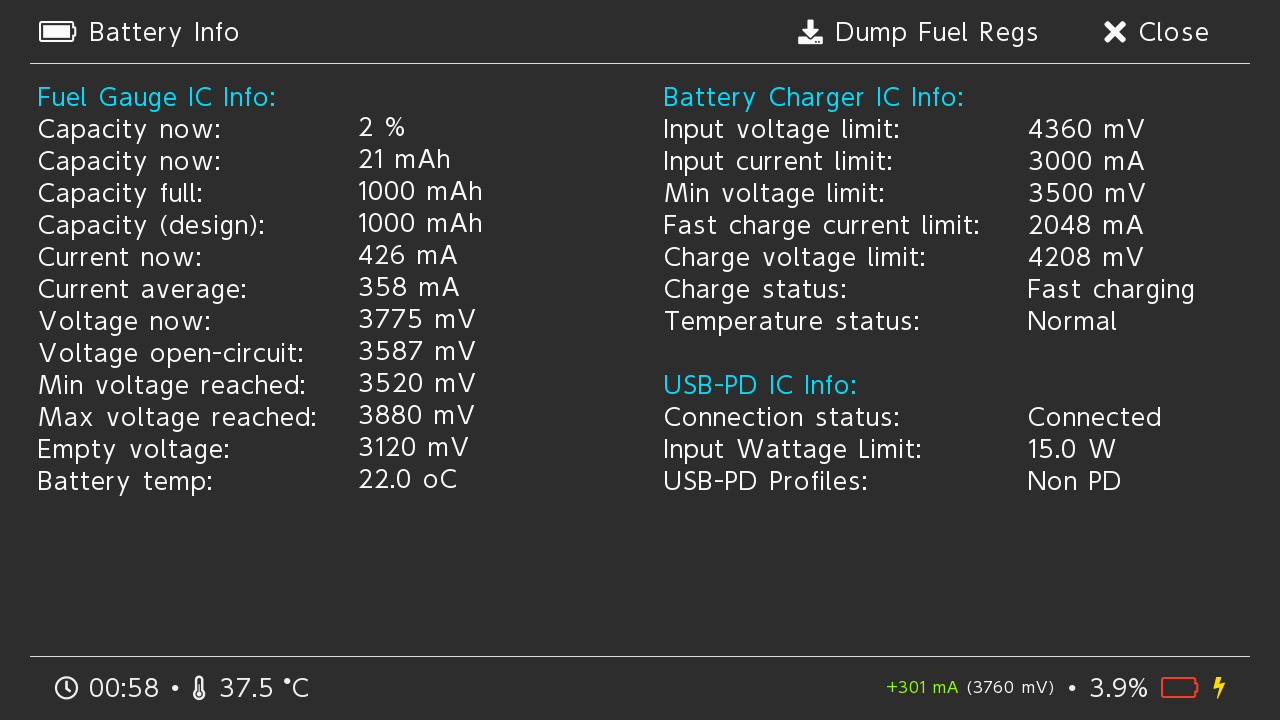

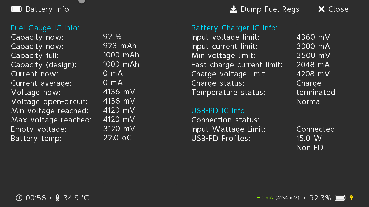

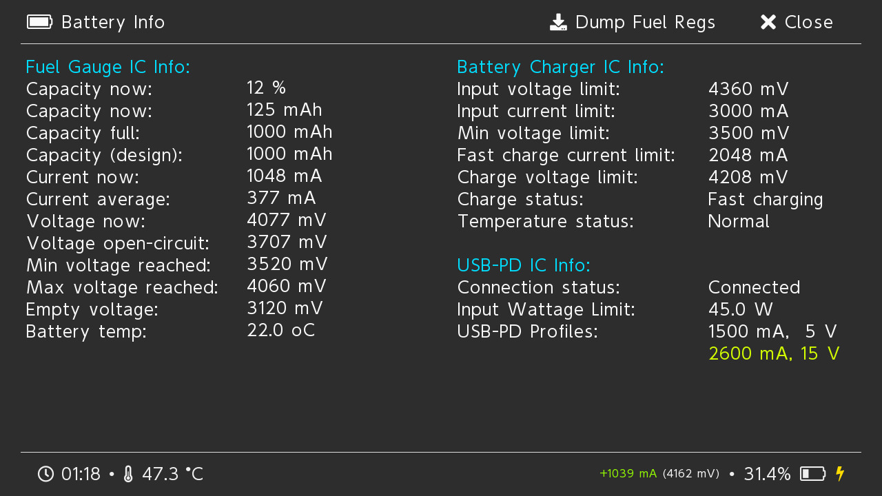

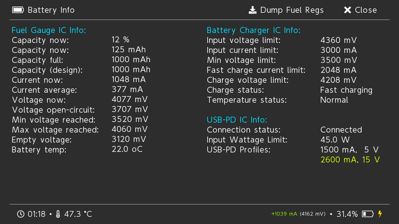

I tried with an other battery, here on my computer:
And with the official AC adapter, but it capped to 1A?
But it's still not booting.
