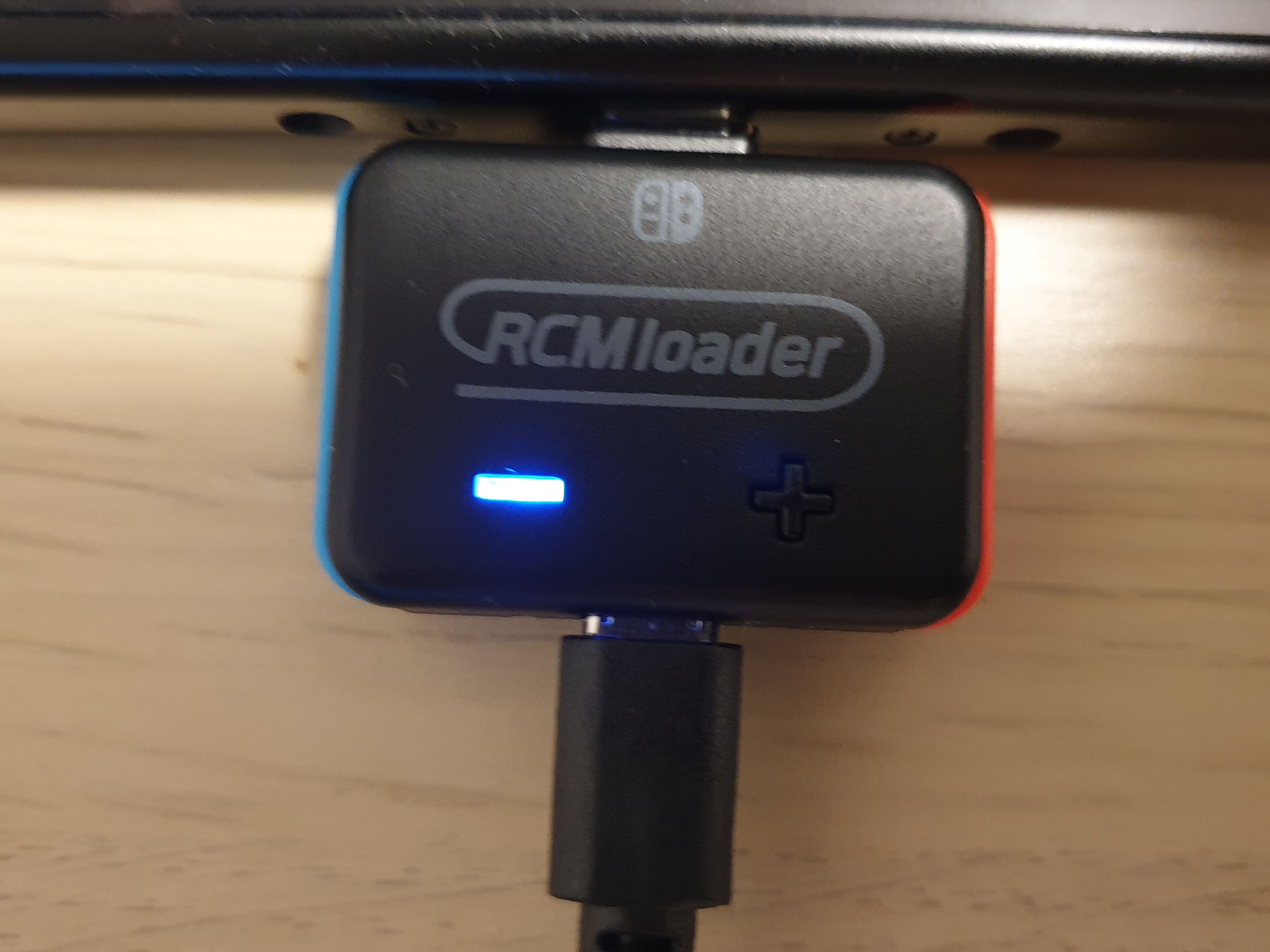

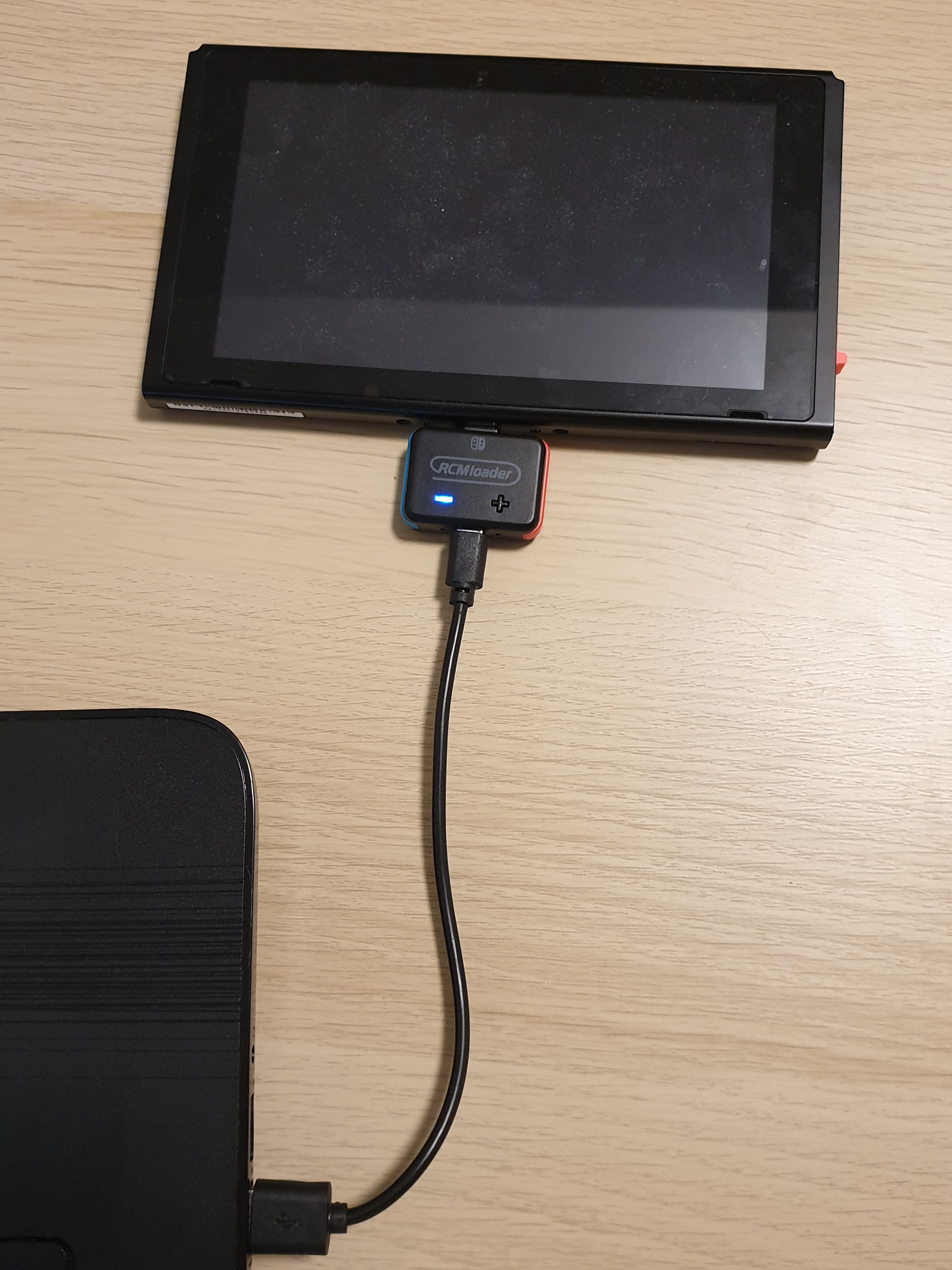

I think with bootloader you mean that thing I called payloader. Its real name is RCMloader.
When I have only the RCMloader on my Switch and press on the + button of the RCMloader, it blinks red. And when I then press on the On/Off-button of the Switch, I get the message boot.dat?
When the RCMloader is connected with PC and Switch, the light of the RCMloader gets blue (constant, no blinking). When I press on + of the RCMloader its light stays blue and cannot change its color.

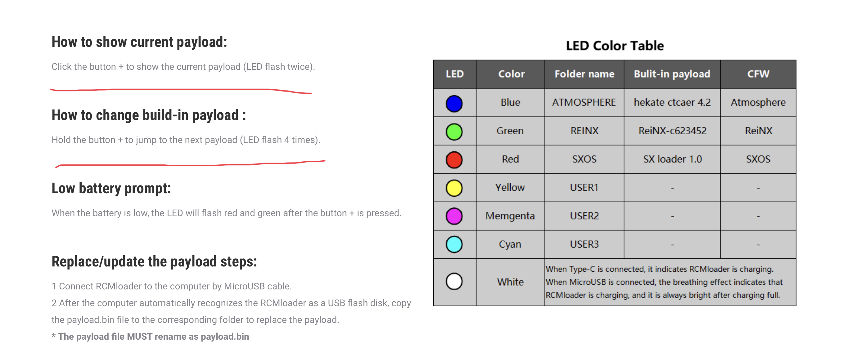

@Dust2dust nailed it! The link he provided has docs on how the RCMloader works. The injector can connect to your PC for maintenance (updating payloads and its own firmware). In that mode it does nothing with the switch. When connected to the switch you can cycle through the various payloads that you put on it with your PC by holding the + button until the color changes. The colors are assigned to the folders on the RCMLoader’s file system. Yours has probably rotated to SXOS and you want to get it back to Atmosphere. All in all, you’re in pretty good shape thus far. Read through the link above and come back with any additional questions you might have.
Hint: you will never plug in your pc to the bootloader to the switch. Only one way at a time. PC to Loader is one way. Loader to Switch is the other way. Not at the same time.
TegraRCMGUI does the same thing as RCMLoader. You need one or the other…not both.
you need to be on the blue one for Atmosphere. You are on red which is SXOS (which yiu don’t have installed based on the boot.dat? prompt.)

Yes, as @binkinator said above, don't make a connection chain of PC>RCMLoader>Switch. Just plug the RCMLoader to PC to update the payload, and to charge it, eventually. Press and hold the + button until the LED is blue. This way, you will push the payload in Atmosphere folder, not the SXOS payload. Update the payload in Atmosphere folder with the latest Hekate payload (rename to payload.bin). Then unplug from PC and plug into the Switch. The LED should flash blue when the payload is pushed.

You are on the Green slot which is REINX (which you probably don’t have and definitely don’t want to set up…it’s pretty old.)
Press and hold the plus (+) until the color changes.
You want the first slot which is Blue for Atmosphere So you are going to have to cycle through RED (SXOS), Yellow, Magenta and Cyan before yiu get back to Blue.

Sure does. Do this…
1) unplug loader from switch.
2) plug usb cable from PC to back of loader.
3) use explorer to navigate to loader (just like it’s an SDCard) and you should see a bunch of files/folders that correlate to the graphic I posted above.
4) go here and download the latest release: https://github.com/CTCaer/hekate/
5) unzip it somewhere and grab the hekate_ctcaer_x.x.x.bin file and move it to the loader under the /ATMOSPHERE/ directory.
6) rename the Hekate.x.x.x.bin file under /ATMOSPHERE to payload.bin
7) eject the loader from the PC
8) hold the (+) button on the loader until it changes (hopefully) to blue.
9) now that it’s on the right slot, plug it into the switch and power it on.
10) I think we’ve got it this time…
e: you should switch colors while disconnected from both the PC and the Switch….might have been your issue all along.

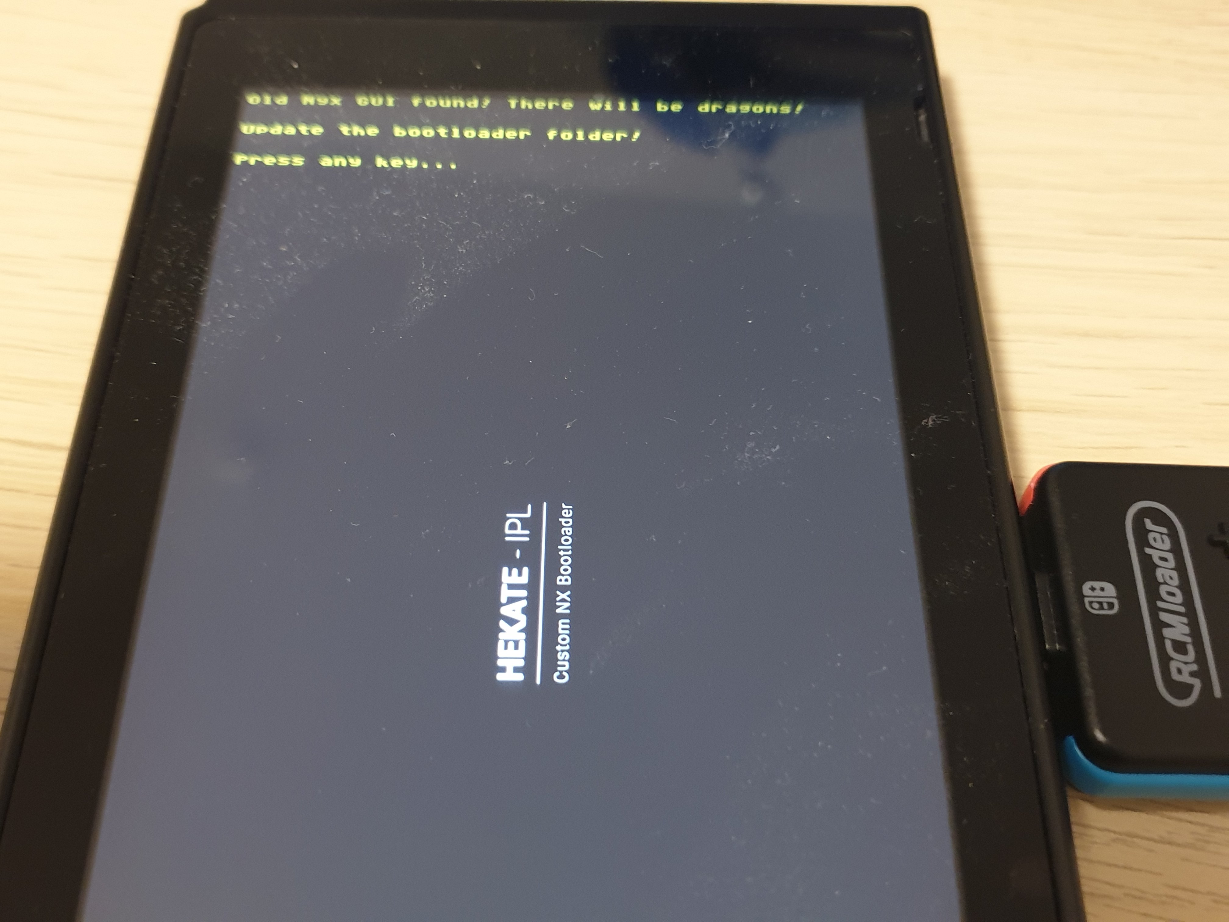

Now by longer pressing of the + button on the RCMloader I could change the color from green to red to blue. It starts Hekate with the message:
"Hekate - IPL
Custom NX Bootloader"
"Old Nyx GUI found! There will be dragons!
Uodate the bootloader folder!
Press any key..."

Ok, nice! Now you only need to update Hekate payload to the latest version. Update the files on the SD card also, and you'll be on your way.

By pressing on the On-/Off-button I finally arrived at the normal Hekate menu. Thank you both for everything. My problem is finally solved. You saved my Switch.

That’s fine…just means your loader version of Hekate is newer than the one on your SDCard …press any key and proceed.
The next steps will be to finalize your Atmosphere installation, and also to try to have your Switch recognized by the PC via USB cable. Important for installing games. :yayswitch:
