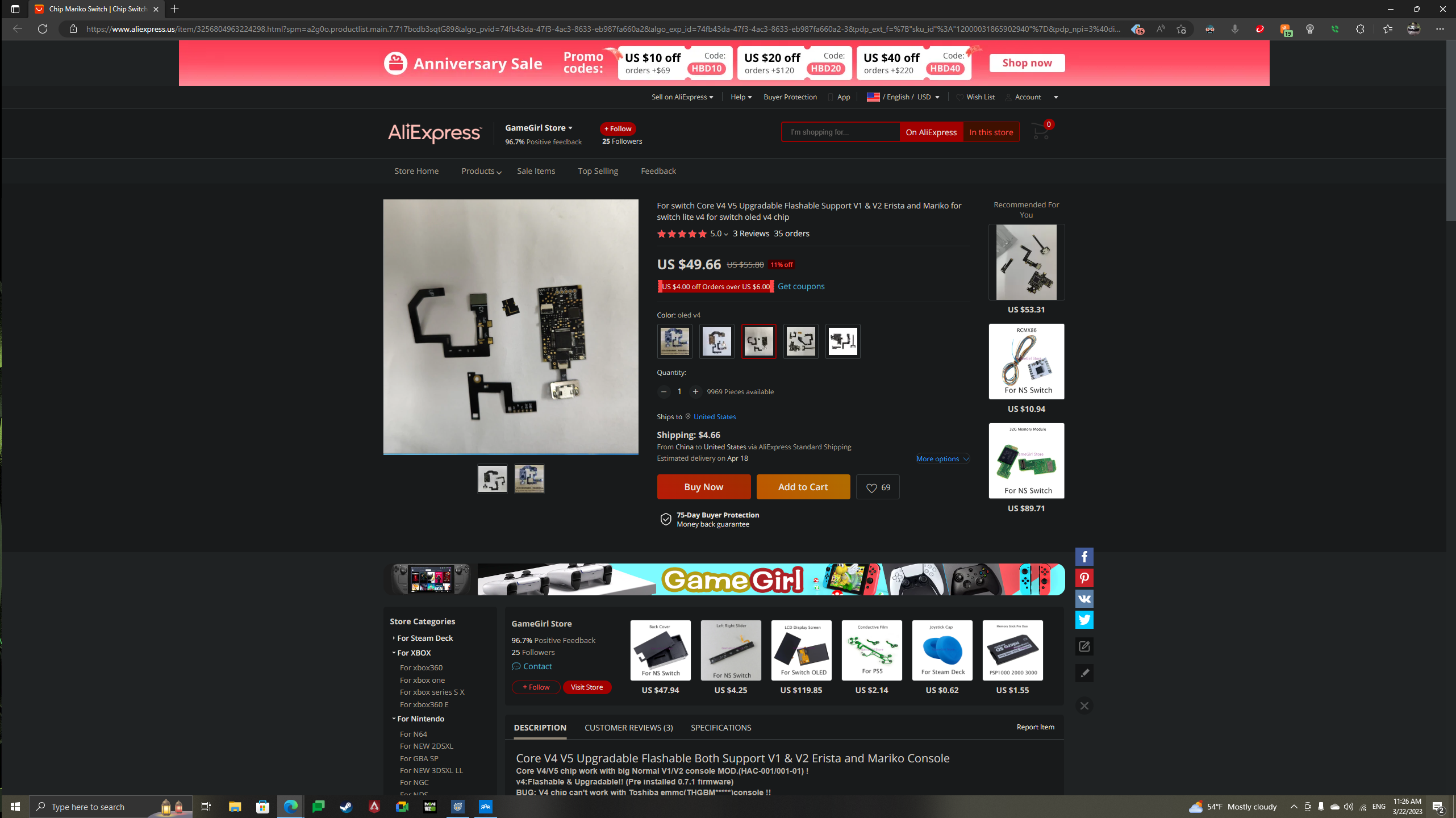

Also, would this be the correct HWFLY chip (see attached)? I'm having trouble finding an oled v4 on the official store. I found a v4 chip on the official store but it didn't have an oled connector. I did find an oled connector sold separately on the official store though. Could I combine the two and have a working chip?

The model you attached is hwfly oled. I live in a different city, so I think the sales policy is a little different. All the hwfly oled products that are shipped to the city where I live are sold out.
