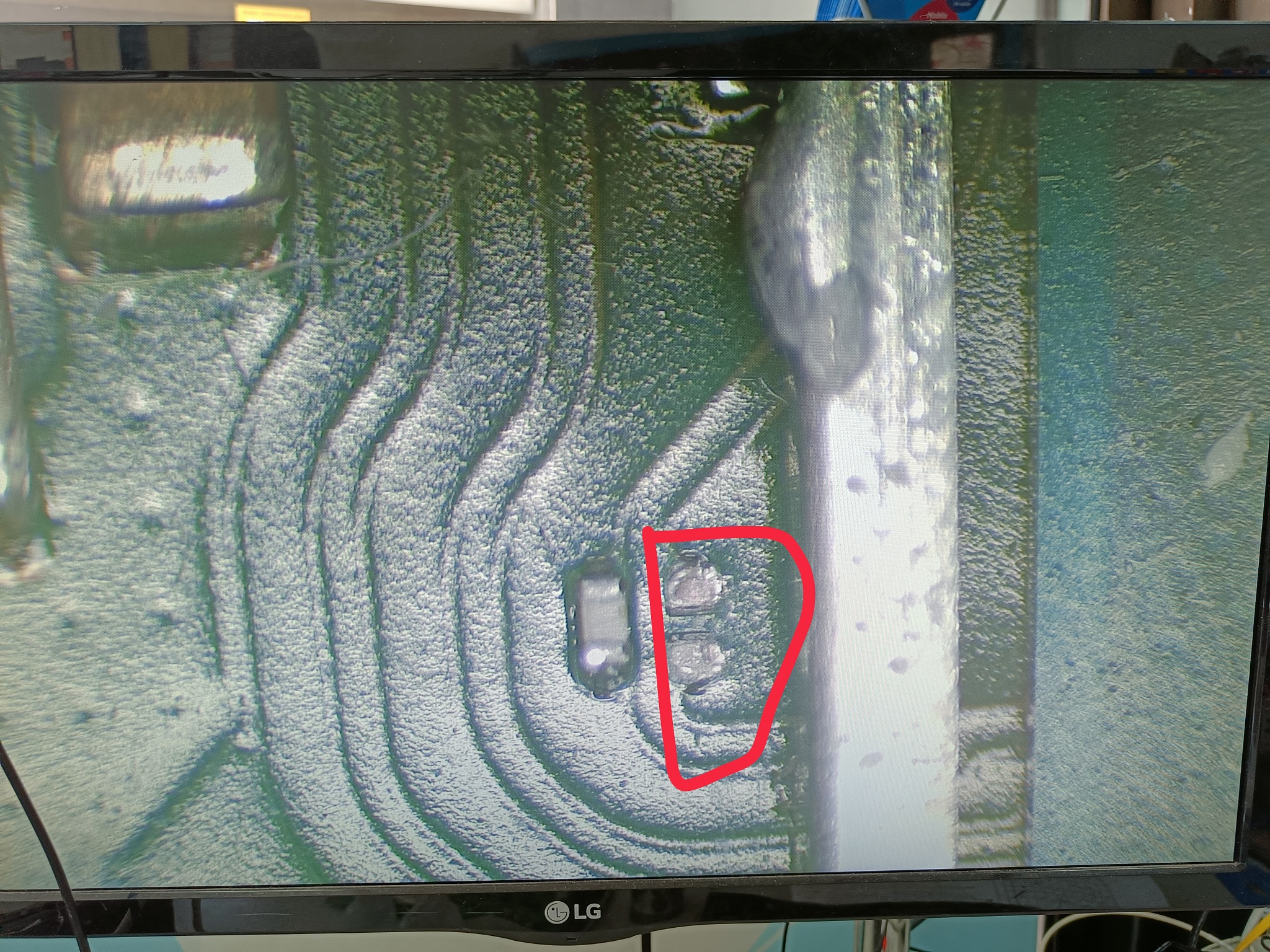

I commented checked the coaxial cables. Didn't unplugged by what I did, anyway I checked if unfortunately disconnected but wasn't. Anyway if were disconnected if palced close to the router, wi-fi signal shown but low, right? Is like not wi-fi at all, either the controllers. Something I'm thinking, can't remove a screw and polish it with my dremmel as gentle as possible, maybe by the vibration the broadcomm module any pad lost the connection with the board?. I was silly anyway, then realized didn't need remove that screws, just the middle one

I have the exact same issue. Been searching for a solution since some months ago, but no luck so far. Most threads I've seen suggest it's a hardware problem with BCM4356 chip.
The Wi-Fi was the missing resistor or capacitor, solved putting from a doner board. But controllers still not responsing at all. Is weird. If plugged the genuine joycons didn't work if not charged (so not charging). Charged in other switch then recognized (so BT is working). If plugged non official controllers side one, Hori in my case don't recognize it. Pro controller by BT do it.

Ah common issue when you take of the plate. That resister is like in the damage zone.

Hi ! I had the same problem before. In my case, the two resistors were missing according to the repair shop. The Wi-Fi worked after the repair.
