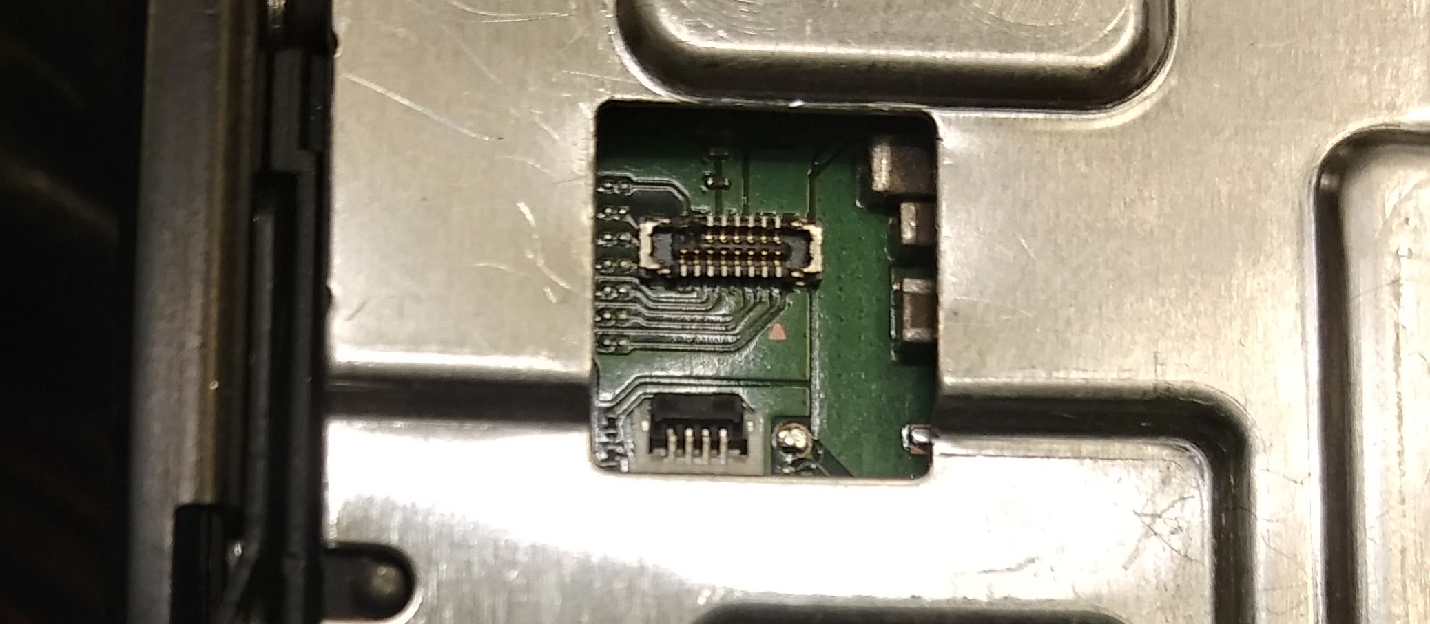

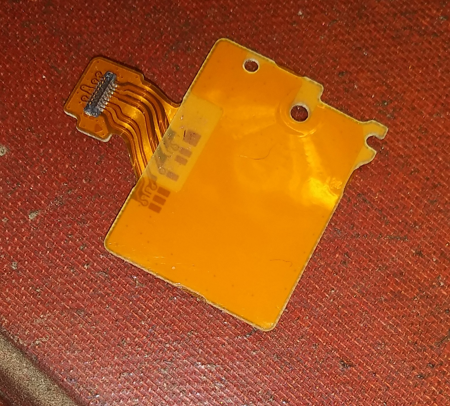

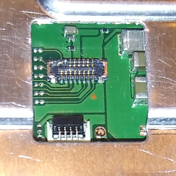

I recently started having problems with my Switch reading the SD card. Everything was fine but then the system kept telling me the card was removed when it wasn't. I ordered a replacement SD card reader from Amazon. (5 star rating $9.95) The problem is now it still won't read any micro SD card. I even put the old sd reader back in and nothing. Any suggestions would be greatly appreciated.

send a picture of the part on the board the sd card reader slots into
Reactions: Hayato213
Pictures of the back side of the sd card connector and the connector on the motherboard would help.
I can try to take better pics tomorrow if those aren't good enough. It's hard to take pics of that stuff because it's so tiny
Guess I'll have to buy a new switch. Thanks for the help
