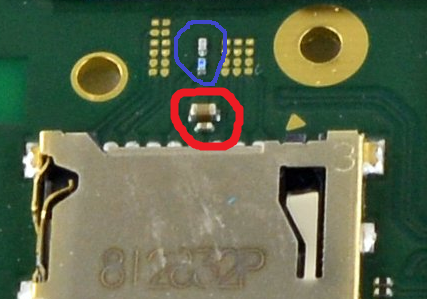

0201 cap rated at 4.7uf. What could be the voltage ? 6.3 v? Also are the caps above the sd card slot necessary for the device to boot?
About the voltage, I wouldn't know but maybe you could get these values from a microSD datasheet since these capacitors are in the vdd port for the microSD.
About the other question, some say that it should work and removing the components would only make the circuit more susceptible to failure due to the "noise" in the voltage, but, honestly, I don't know, @hiju123.
You could do a test and see if it turns on, since the caps which are missing in your board are those in the vdd. Mine are in the clock output as well, so a simple short will not work for me I guess.

Hello, i replace yesterday this capacitor.
The first post of the topic.
I take a donor to a switch FAT.
That fix the ploblem i see on this switch lite, ( Short capacitor )
The flex on the board SP1 SP2 seem moved, and i think that caused a short.
Someone have the right value, i am interested.
My english is not perfect, i think it s
0402 4.7UF 10V
Am i correct ?

So, yeah, the bigger one circled in red in the image below is a 0402 capacitor with 4.7µF. Don't know about the voltage though but, been a capacitor attached to the VDD in a microSD card, it seems more likely to be 10V.
Hope it helps!

So, considering the image mentioned before, if you mean the bigger cap in the red circle, then yes, this is probably the correct capacitor. I would try to use a X7R just to be safe, but the size and value are correct.

Hi. Anyone knows values of elements circled in blue? Its absent and switch lite wont see microsd.
Looks like its for CLK pin.

for me it's about resistance
Le petit composant en dessous du gros fait aussi 4.7 uf
for the capacitor/resistor I found this value :
( SD reader | d3 ) [201] unknown : ?~1.5kohm? ?~1.84mv?
( SD reader | blue ) [201] ?resistor? : ~0ohm ~0mv
( SD reader | d1 ) [402] capacitor : ~277 ohm ~681mv
( SD reader | d2 ) [201] capacitor : ~277 ohm ~681mv
( Tegra | SP1 ) [201] resistor : ~13.1ohm ~69.6mv
( Tegra | SP2 ) [201] resistor : ~22.6ohm ~0mv
d3 and blue I am not on the validity of the values/types it was complicated to measure I put the most persistent.
d1 and d2 are probably in derivation I find ~3uf but I am not sure either.
I hope to help you find it!
note: the values are not calibrated !
