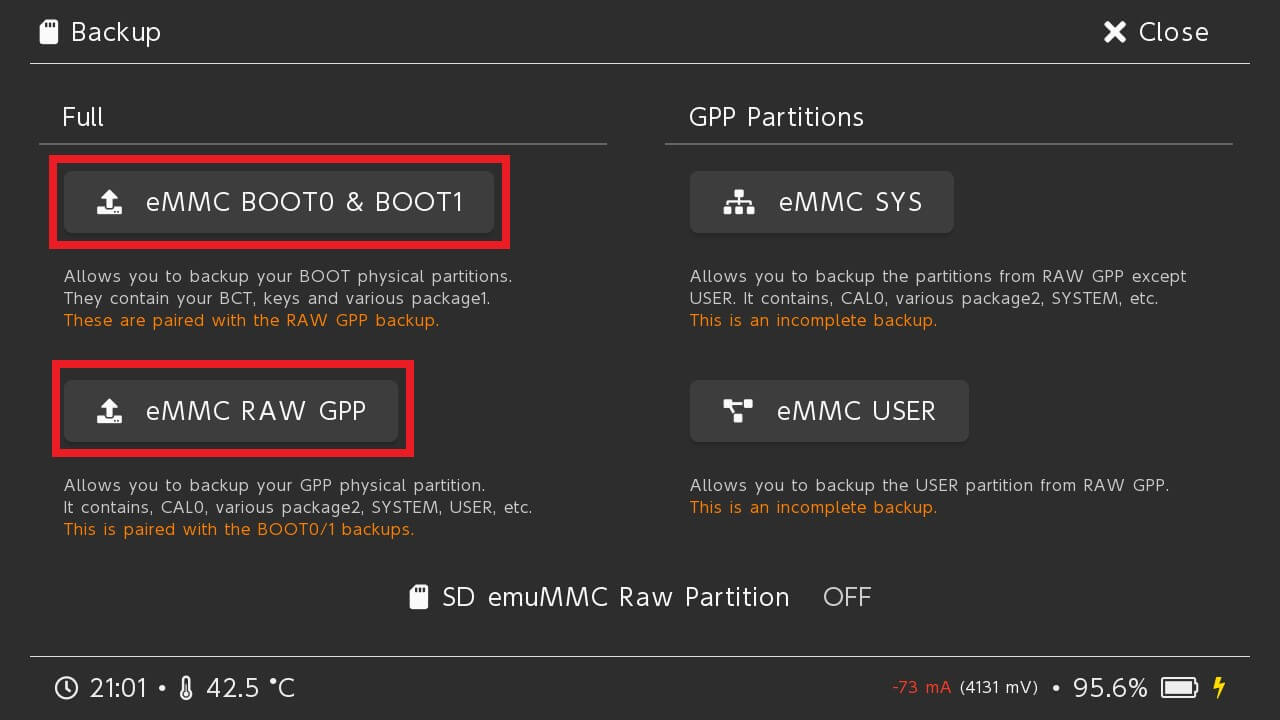

If you don't have a working original NAND to restore to, then you probably need to rebuild the NAND with EmmcHaccGen, if your emunand on your SD card as a hidden partition then you can enable SD emummc raw parittion you can probably make a NAND backup of that and restore it to your sysnand internal emmc.
I did that like 4 times already and thats how i originally unbricked it to what it is now.
i even did it today so i really dont see a point
Well if the emunand wasn't working then it is obvious no point using that as a backup, I mean it is bad that you don't keep a NAND backup, I guess your last resort is EmmcHaccGen
