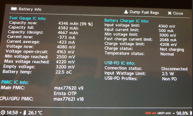

Hekate shows some battery statistics :
Capacity (design) is what a brand new battery would be.
Capacity full is the maximum capacity at the moment.
But it sounds like it is time to replace your battery.
What you describe are all symptoms of a lithium battery at the end of its lifetime.
Thanks for the reply. You must be right. I googled "hekate", then downloaded and injected the "hekate_ctcaer_6.2.2.bin" that came up. There was a battery option at the bottom, and it said the Capacity (full) was 990 mAh. Oof. All right, I'll get to replacing it with the new battery I bought.
