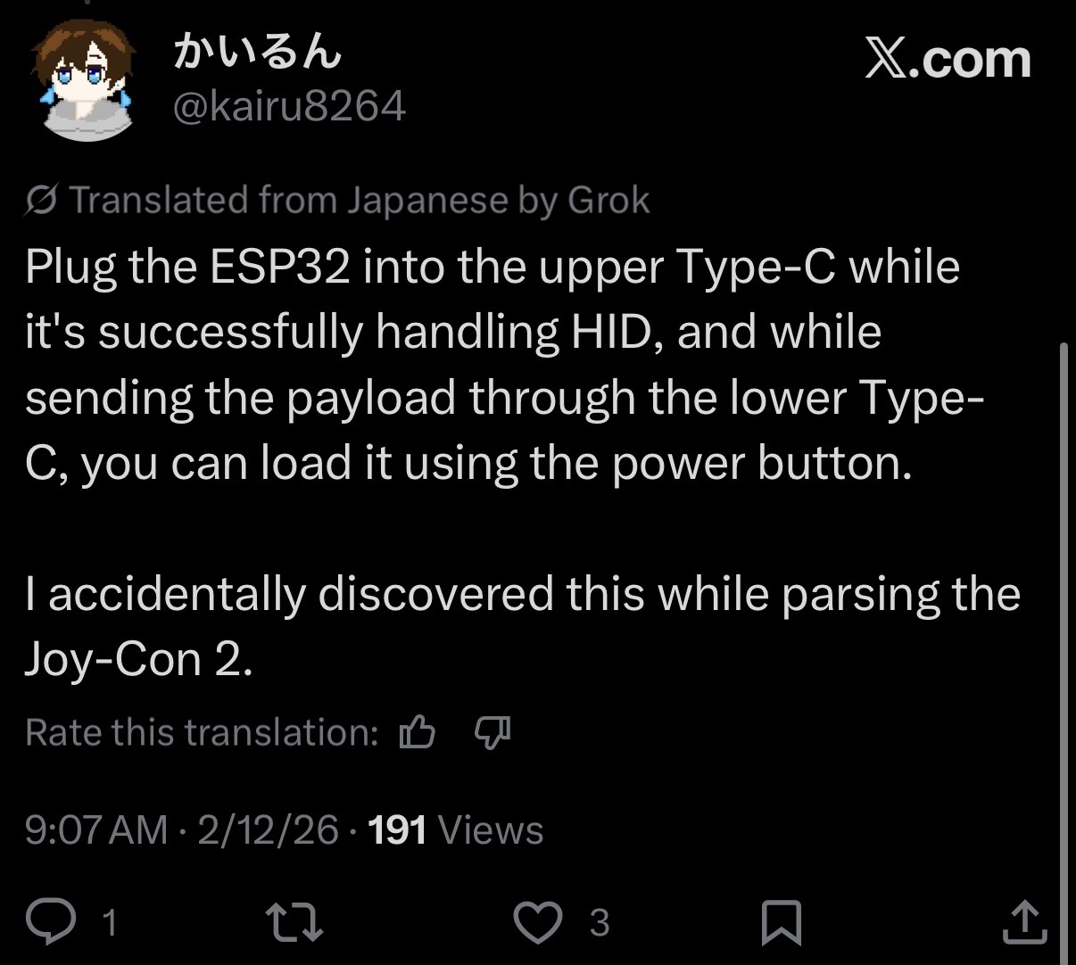

(Screenshots for those who can’t load or view Twitter)
Very likely fake but I would LOVE to be proven wrong

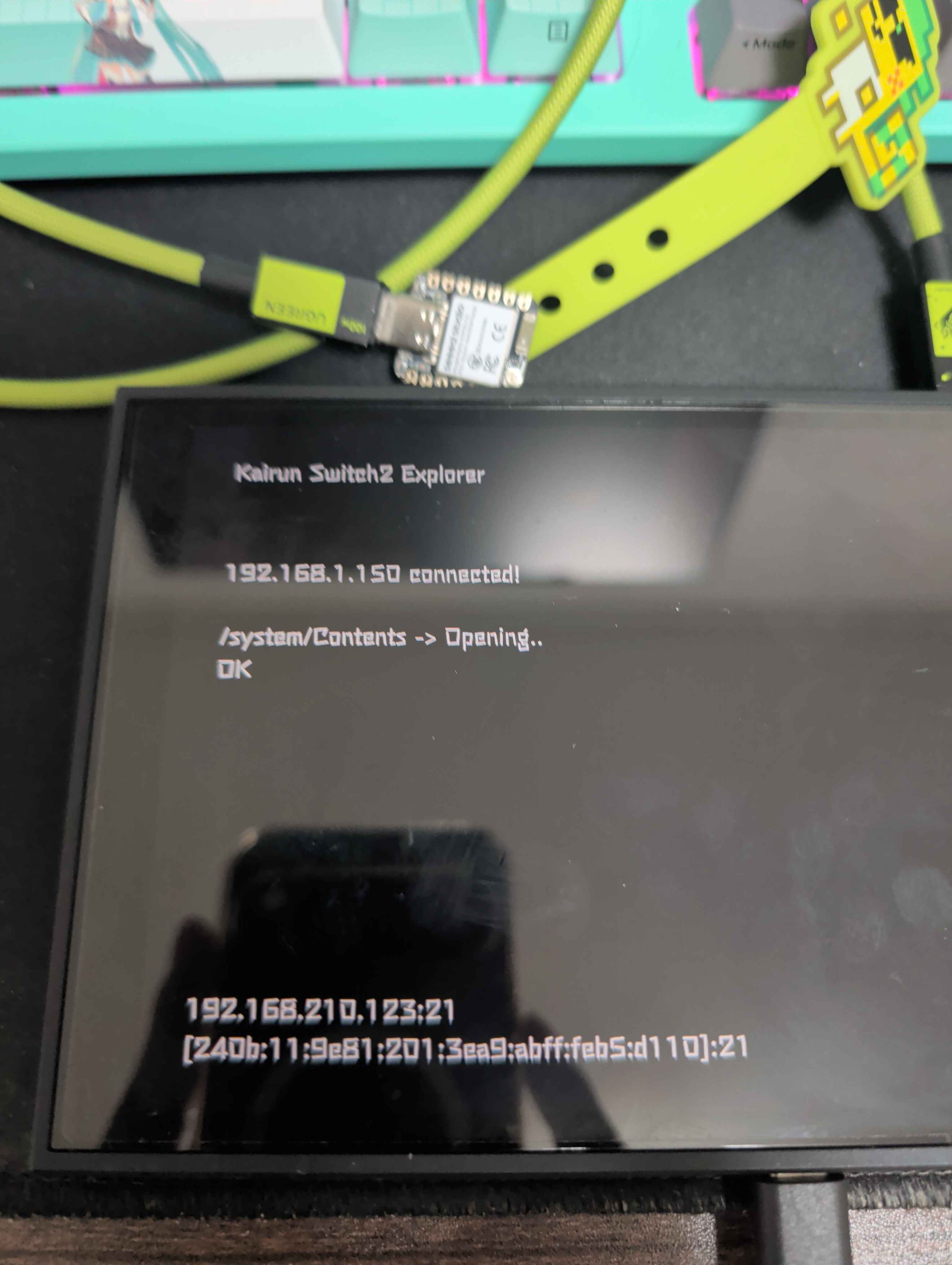

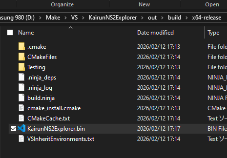

Actually, yeah, definitely fake. Allegedly they're writing the tool with VSCode and the binary gets written into the x64-release directory. So this is most likely a dummy x64 Windows application renamed from exe to bin. My best guess: this dummy application prints the text seen on the Switch 2 screen which they then made a screenshot and moved onto the Switch SD card to make it look like the program is running on the console
ALSO :D See how the bin was modified a few minutes after all the other files in that directory ? That's probably from the renaming
ALSO ALSO: (I'm having way too much fun) the two devices which are apparently connecting to each other are on different IPv4 subnets. Nice one. (except if their IP config is 192.168.0.0/16 which would be pretty insane)

I joined this guys discord and he had a channel called switch 2 exploit, which had this, tbh i dont know what the screenshots are supposed to prove

idk honestly it could be real, in the discord theyre saying how u can supposedly replicate this, idk if it works tho

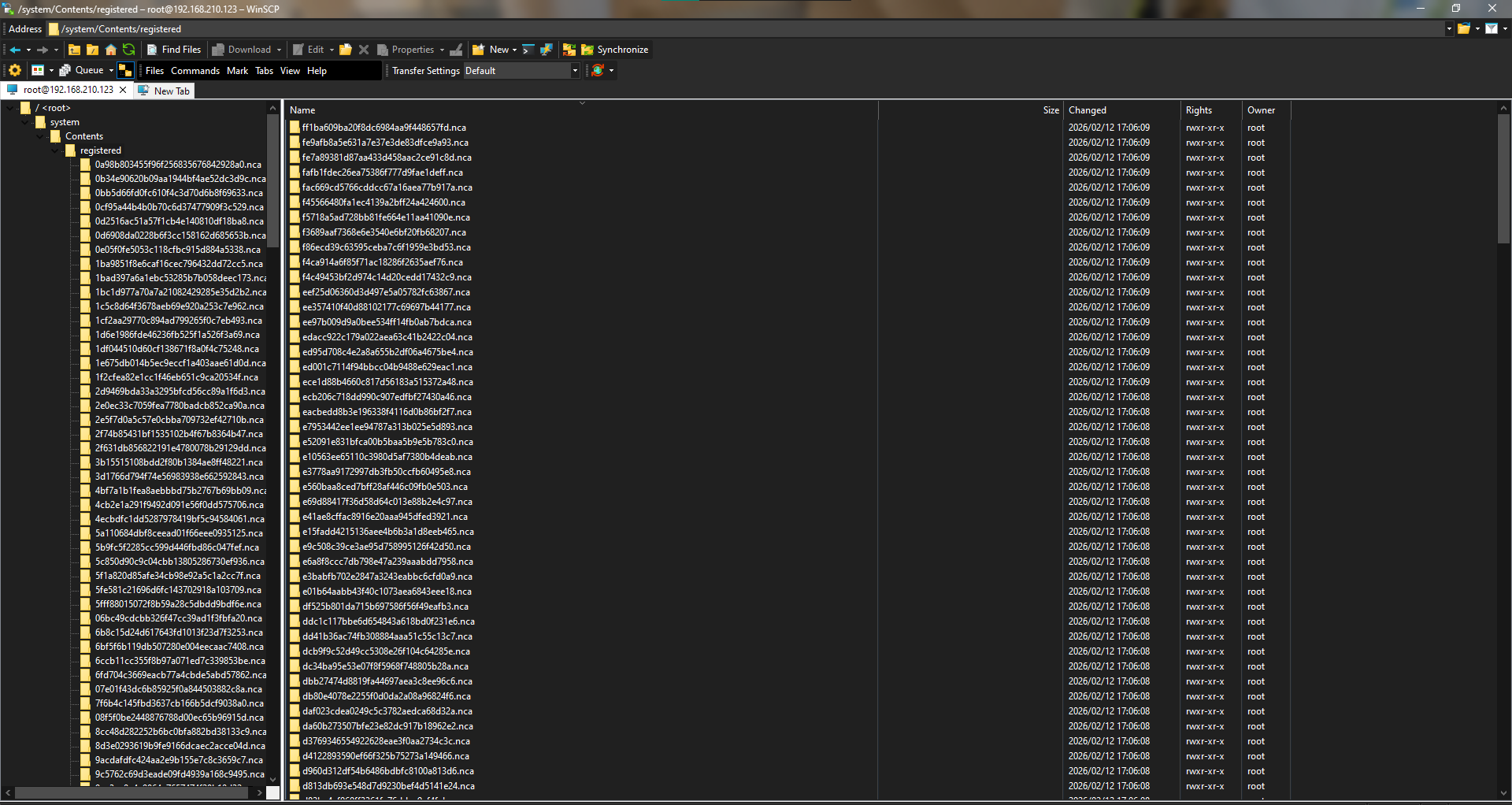

- exploit to to gain code execution with enough privilleges to dump the UFS
- develop an FTP client without any public SDK being available
apparently all on their own? All of this while actual security experts who have been very active in the scene for years have continued to state how secure the system is. I don't think this is very likely at all.
