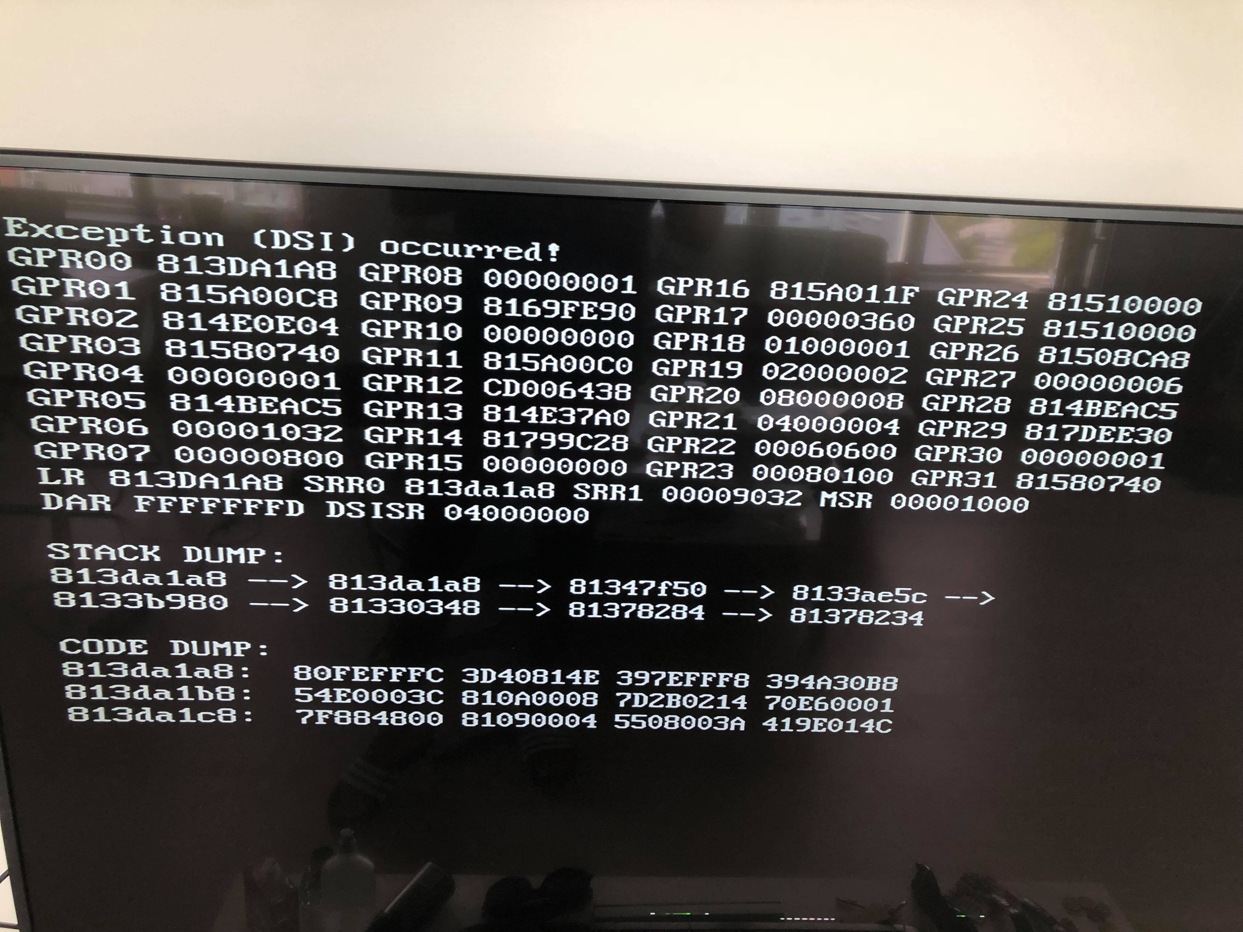

Hey guys,
Will try to keep it short, and hope i get short answers and not alot of links to other guides. I have googled and this is my last resort. So thanks in advance.
First is first, new to the wii softmod scene, so sorry bout that. And now here is my issue(s)
And a *... I tried a couple of independent modding tuts, for example installing HBC (that worked) and then the latest cIOS that didnt work, so I was recommended to go via the modmii tutorial and at the same time it would write over my previous installs with this solution, since it does replace all those things I had (tried to) install before (I guess).
So I didnt do any of the modmii install HBC solution because I already had that and letterbomb solution in place.
So...
The modmii installation worked, I guess. I had no trouble following the guide and everything shows up.
However, when I try to load my games via usb loader from the wii Main screen, it just asks me: Please connect a USB drive. Then I press start. Screen shows quick WII, goes black screen, and then just goes back to main menu, and no games shows up.
I installed the ios236
Installed priiloader
Installed the WAD
Partitioned my harddrive to FAT32
I used to wiibackup manager and transferred my backup games the proper way to my 2TB WD Elements.
"For playing your backups off a USB hard drive, run the USB-Loader Setup feature from ModMii's Main Menu."
(I dont really understand this perhaps? Is it on the wii main menu?)
Anyways, I also attached some images, if that can give a better understanding.
My version is 4.3 (Lastest)
My HBC
1.1.2
IOS 58 v.24.32
Any help will be much appreciated.
Thanks in advance.

Can you confirm all the wads installed successfully (if unsure, run a Syscheck and post results as instructed here: https://gbatemp.net/threads/posting-a-system-check.300279/ ) ?
Do you have the USB hard drive plugged into port 0 (USB port nearest the edge)? Is your hard drive properly formatted as fat32? Is the hard drive compatible with the wii? To check, open the HBC and go to the options menu (by pressing 1 or 2) and choose to view apps on the hard drive. If you can't, either you have an incompatible hard drive, or it isn't in the correct port, or it's not formatted correctly.
If you do manage to see the apps off the hard drive in the HBC, try launching the USB loader from there instead of the main menu forwarder channel.
Edit: some hard drives are slow to initialize, if that's the issue, you can try numerous times quickly to access the hard drive and it may work on the second attempt (first attempt will start to wake up the drive but will time out before initializing, second attempt may work if the HDD is already primed from the first attempt)
Edit2: there might be more things to try but I think let's start with what I've listed. Report back and if you still need help I will suggest other things to try, or I'm sure someone else will like @Cyan or @GreyWolf
  1. Do you have the USB hard drive plugged into port 0 (USB port nearest the edge)? I tried both usb ports to be sure.
  2. Is your hard drive properly formatted as fat32? It is. I followed the instructions as per se:

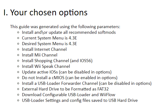

    • USB Loader and Hard Drive setup
    The rest of the guide is performed on your computer in order to set up your USB-Loader
      • Partition and Format the External Hard Drive for FAT32
      First check if your drive needs to be formatted by checking the current Format\File-System of the drive.
      Open "My Computer", right-click the external hard drive you want to use, then select "properties".
      Make note of the Drive Letter of the external hard drive as this will be important later.
      If the "File-System" is already FAT32, you can skip this step.
      If you have anything saved on the hard drive, you should back it up now as all the data will be lost once you format it.
      Launch FAT32_GUI_Formatter.exe saved here: COPY_TO_USB\FAT32_GUI_Formatter\FAT32_GUI_Formatter.exe
      Make sure you select the drive letter corresponding to your external hard drive.
      You may optionally uncheck the "Quick Format" box, then click start.
      • Copy Files to the Hard Drive
      Copy everything inside the COPY_TO_USB folder to the root of your FAT32 hard-drive\partition.
  • Is the hard drive compatible with the wii? It should be. I checked the compatible ones on GBAtemp list and 2TB WD should be a go!

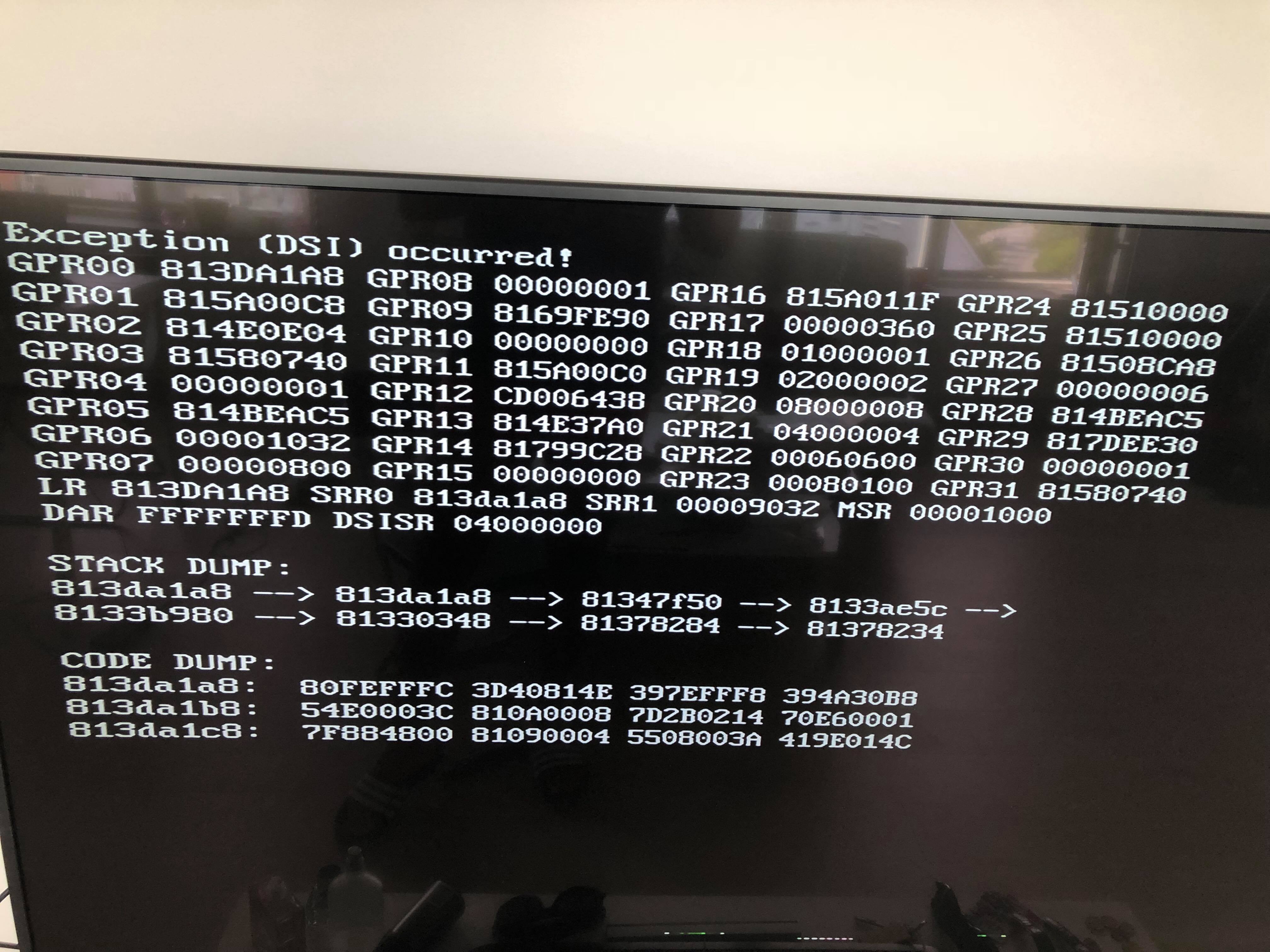

  • To check, open the HBC and go to the options menu (by pressing 1 or 2) and choose to view apps on the hard drive. If you can't, either you have an incompatible hard drive, or it isn't in the correct port, or it's not formatted correctly. (Please see image provided, I get Exception DSI when opening via HBC-->options-->usb device) EDIT: I get the same error when trying to open SD-Card slot.
(I cant see the apps here)

syscheck
your syscheck is good, which means all modmii guide has properly been followed and everything is installed correctly.
don't touch or edit the IOS or cIOS anymore.
youtube
You said you followed the video and install the games the "proper way" but then you said you "put them in the folder".
the video was almost good, until it told users to do things manually (like "split files don't work, do it yourself !" that's wrong. He probably used an old version of that program, and following old tutorial video is expecting to be based on outdated and bugged versions. Don't follow video tutorials). He also did strange things, like using "drive2" instead of "drive1" (nothing wrong, just odd to not mount the drives in tab's order), and he also created a wbfs folder on his C partition (why touch the system partition with hacks ? not safe...), he also didn't tell how to setup the program properly. well, a half badly done guide in my opinion.
But, it's not a problem here, your problem is the device detection.
You said it crashes on both listing USB or SD.
But, you could follow modmii tutorial up until now, so listing the SD card was not a problem. until AFTER you followed modmii, right?
Did you change the SD content after following modmii ? did you add or remove homebrew or any files?

can you launch HBC without any connected devices? do you see any flashing or highlighted logo (network is detected and highlighted?)
can you press Home menu, and verify it's detecting IOS58 v24.32 ?
can you press the option button (still without any SD or USB inserted) and exit that menu without crashes?
2)
Which size is your SD card?
are you sure the card is formatted to FAT32, not exFAT?
Do you have only one SD card, or more ?
did you try inserting other SD cards ? even ones without the "/apps/" folder ?
does it crashes only when you select the "SD card" option in the menu, or right when you insert the card?
maybe the crash is because one of the homebrew has an incorrect meta.xml file? so, first, try inserting the card without any homebrew in the /apps/ folder. just see if it crashes at device detection or at homebrew listing.
to know if the SD card is detected :
the bubble will (should) pop out when you insert/eject the SD. if not, press the option button and verify the "SD card" option can be selected/is highlighted.
what's strange is that you are the second user in one week with the HBC crash issue. the other user had this crash on both wii and vwii. there's something HBC doesn't like, and we have to find it. acting step by step, adding one homebrew at a time is the best thing.
But, you could follow modmii tutorial up until now, so listing the SD card was not a problem. until AFTER you followed modmii, right? It never was a problem? It worked properly? Since I could use it and install everything?
Did you change the SD content after following modmii ? NO! The after getting files from modmii I reformated with fat32 and put the files that was suggested in the guide. did you add or remove homebrew or any files? No more or less than the files that followed with the guide. Copy to sd was put on SD. Copy to USB was copied to USB. :)

let's try in order:
1)
So... Without SD card OR WD 2TB I can still go to HBC and select it. My wifi is connected.
YES I can.

does it crashes only when you select the "SD card" option in the menu, or right when you insert the card? It never crashes TBH. Files are there. However... When I add it to the slot, and go to SD menu via the Wii menu, nothing shows up. Is it the way its supposed to be? onyl greyed out wii background and 1/20 but no files.
I dont exactly know what you mean? "just see if it crashes at device detection or at homebrew listing"
I removed all files from the /app/folder and inserted into wii. Now what? (It gets detected on main wii menu)
Again, what is this option button? (Home? :) Either way, it pops in and out when using the sd slot.

when using modmii and copying there is already a folder with that name, I figured the correct way would be to transfer them via Wii backup manager.
I didn't understand what you mean by "when using modmii there is already a folder with that name" .. which name ? modmii ? wbfs? modmii generated a wbfs empty folder? I didn't know it did that.
a small guide to setup and use WiibackupManager : https://gbatemp.net/posts/7592791

Wait .... didn't you just told us this : EDIT: I get the same error when trying to open SD-Card slot.
soo, it crash or not with SD card ? please give proper info, because I started debugging the SD card and now you tell it works fine ?
Wait, yo talk about the official nintendo SD menu accessible from the Wii home menu ? I'm talking to you about HBC.
you never talked about SD menu in the wii home menu. is that another problem you have with that menu ? That's completely normal you don't see anything in the official games bought from nintendo, if you didn't bought any games from nintendo.

modmii added 2 USB Loader to your SD : USBLoader_CFG and Wiiflow.
the channel you launch from the wii menu is a shortcut to launch the loader you want based on the button you press when launching it. (if I remember correctly)
it's true modmii doesn't have USBLoaderGX, but it's not hard to add it yourself like you did.
