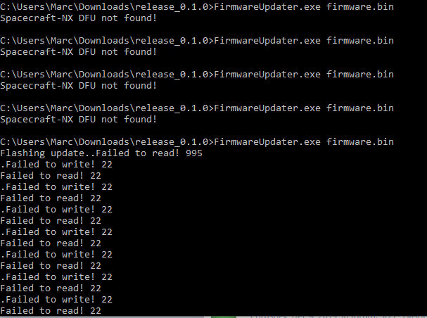

I did "brick" my chip with the cyan light going straight into OFW - first flashing the initial backups using the Spacecraft tool (so the PC recognised it as an SX chip again) then flashing the firmware using the official SX updater sorted it out.
Reflashed again bootloader and firmware through ST Link V2, but there is no way I can boot normaly into CFW, always starts in a white led and boots directly into OFW.
Any idea of how to proceed?
EDIT: At this point I would like to solve the problem by any means, even reflashing official sxcore firmware and using atmosphere, but I don't know which is the firmware address to flash to.
The problem now is I can't reflash the firmware by USB because soldering into the pads has caused them to wear out and cannot solder into them anymore. The only way I have now to flash is ST Link v2.
EDIT2: Flashed official sx bootloader and flashed official firmware into address 0x08003000, which leads to directly booting into OFW with a static green LED in the SXCore. Do you know if this is the correct firmware address to flash?.

the original firmware can't be flashed directly since its encrypted with a variant of TEA.
you need to decrypt it first by using gw_flash.py(https://gist.github.com/SciresM/cd40c3d1b5dfafbf1fe8f7e5cf13f91e).
it requires python version 2.7.11 and the usage of that python script is "python gw_flash.py -d encrypted_firmware_name.bin decrypted_firmware_name.bin".
afterwards you need to remove the first 16 bytes of the decrypted firmware with an hex editor and then you're able to flash it to 0x08003000 using the st-link flash tool.
other way is to flash the sx bootloader and use the sx core updater tool via the usb dongle. you need to update the serial number inside the bootloader though (since it contains your serial number of the chip) and for that you need the license-request.dat EXCEPT you still have the first backup bootloader file spacecraft-nx's flash tool created for you.

Does that 16 byte removal apply to the spacecraft-nx firmware too?
Do I need the serial number of the chip inside the official sx bootloader to flash through the USB dongle with the sx updater program
it does not apply for the spacecraft-nx firmware. if you don't plan to use sxos anymore, the serial number doesn't matter.

I have similar issues as CabroX - blue/whitish LED on SX-Core when it was on switch, no detect via USB in SX updater but detects DFU in spacecraft prompt but just gets stuck. Manually backed up the bootloader and firmware with a J-Link and then wrote the SX bootloader and decrypted SX firmware at the offsets you mentioned but i still have the same issue with the SX updater being unable to see the device following this etc.this is not a USB driver issue afaik (i tried all of them in Zadig)
Serial number wouldn't be playing a part in this would it?

can you try to a chip erase via an external flasher connected to the gd32 after a full backup and reflashing the bootloader/firmware? a full chip erase will delete the current glitch config which might be a cause of the glitching process to fail.
For whatever reason i"m unable to use conventional tools such as J-flash for some reason and have to use Keil uvision in order to do the programming in combination with my J-link, I'm pretty sure Keil has a full erase option (somewhere) so I'll give it a go.
Still don't understand why i can't flash the firmware via USB on windows though with either the SX tool or Spacecraft tool.
previous attempt writing the bootloader and firmware would suggest flash and ram are fine and it's showing as a DFU com device within Windows which seems to suggest modchip hardware is good afaict
flashing the firmware requires a working bootloader since otherwise the dfu won't get initialized. can you check the device/vendor id inside device manager? there are 3 vendor/device ids inside the spacecraft-nx flasher and just one inside the sx flasher, if the modchip shows up as anything but those ones, the flasher tools wont recognize it.

I did a full erase and wrote the Spacecraft NX bootloader on it's own and then also the Spacecraft NX firmware at 0x08003000 also but in both instances it's not picked up by the SX updater tool and trying to use the Spacecraft tools just results in it hanging at "flashing bootloader" .
I've attached a screencap of the VID/PID info from device manager.
