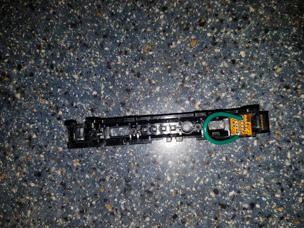

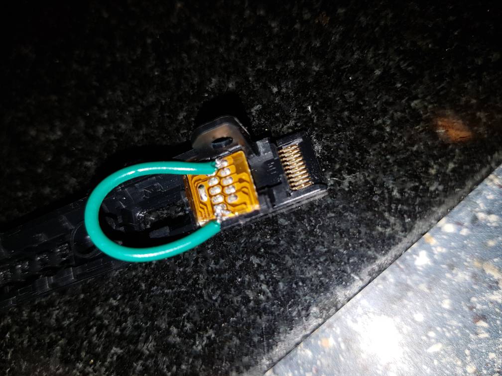

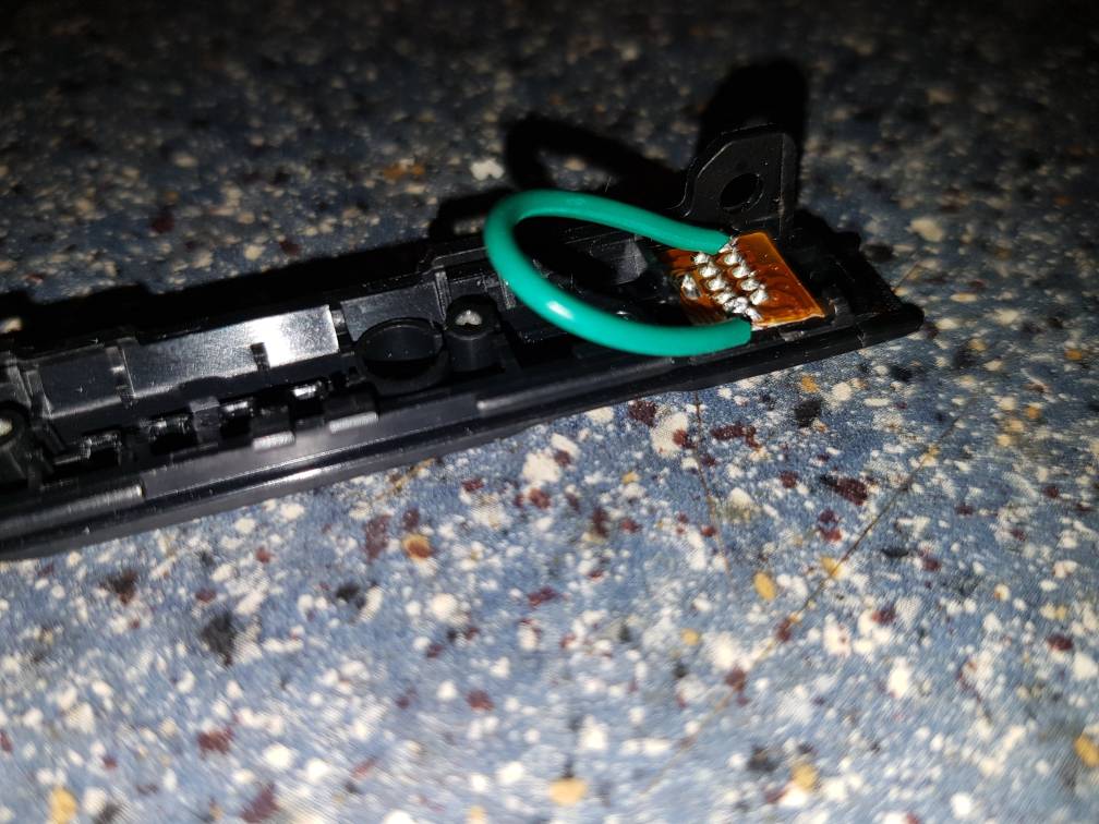

I bought a replacement joycon rail off eBay for £7 and soldered a wire from pin 1 to pin 10 (You can also bridge 9 and 10 with a blob of solder)
No extra stress on your switch rail 100% rcm triggers View attachment 134046View attachment 134047View attachment 134048

9 and 10 won't always work because pin 9 is not guaranteed to be GND.
