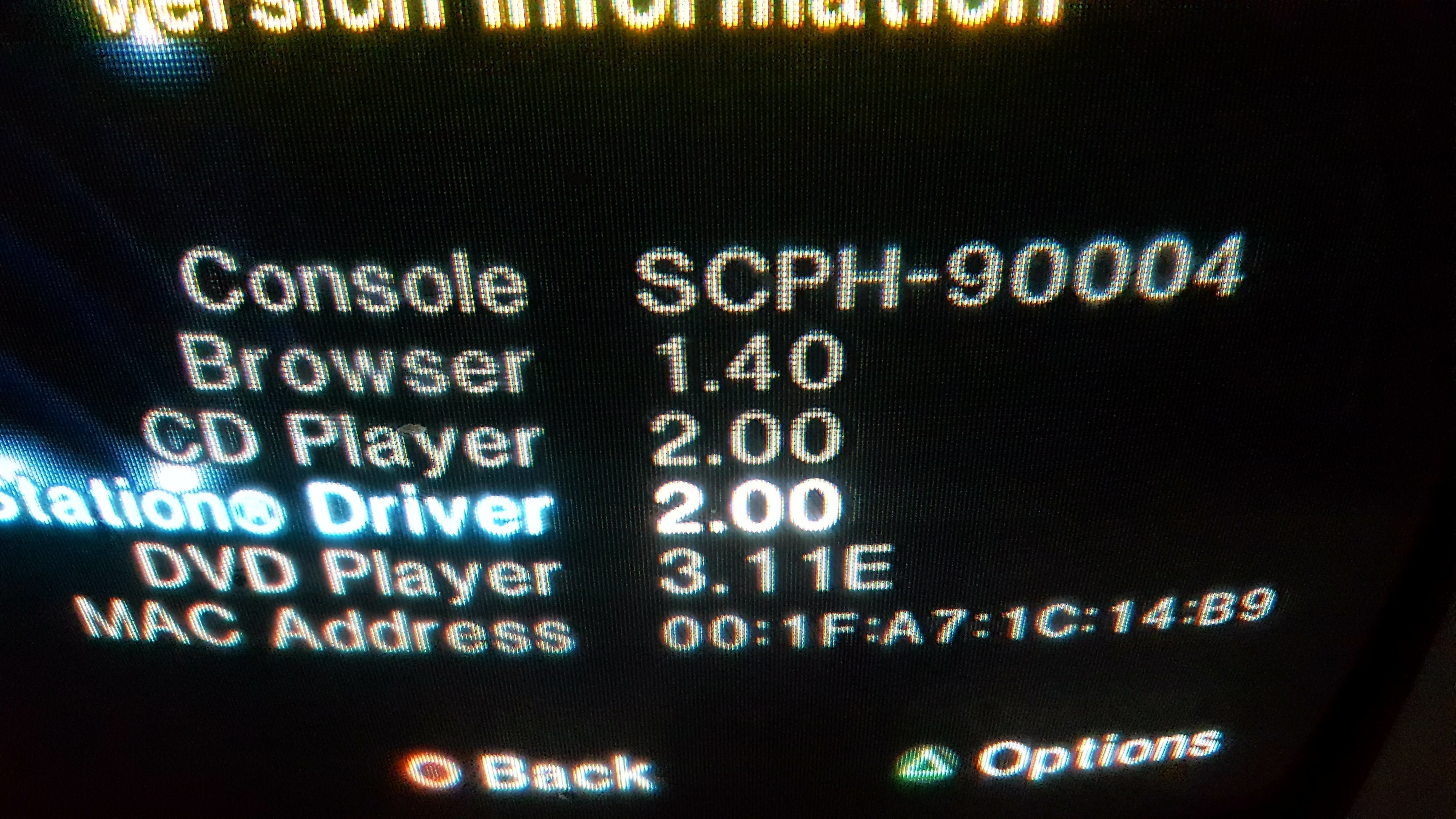

Is this version hackable
Unfortunately that doesnt seem to be a method to detect the rom version.
Only methods Ive seen involve either trying it, the date code or using homebrew through other means.
Correct, the rom version that disabled updates is 2.30, but you can't see that using official software
