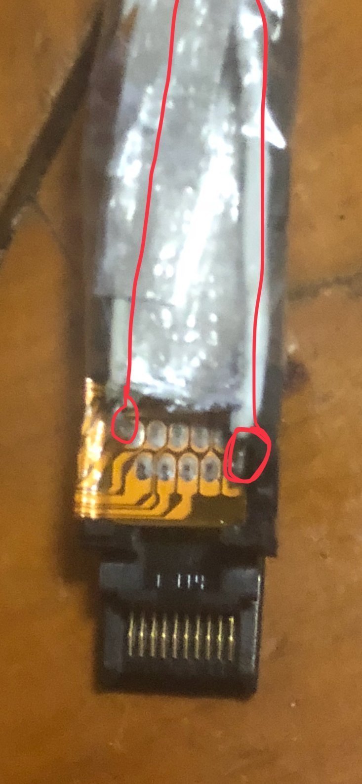

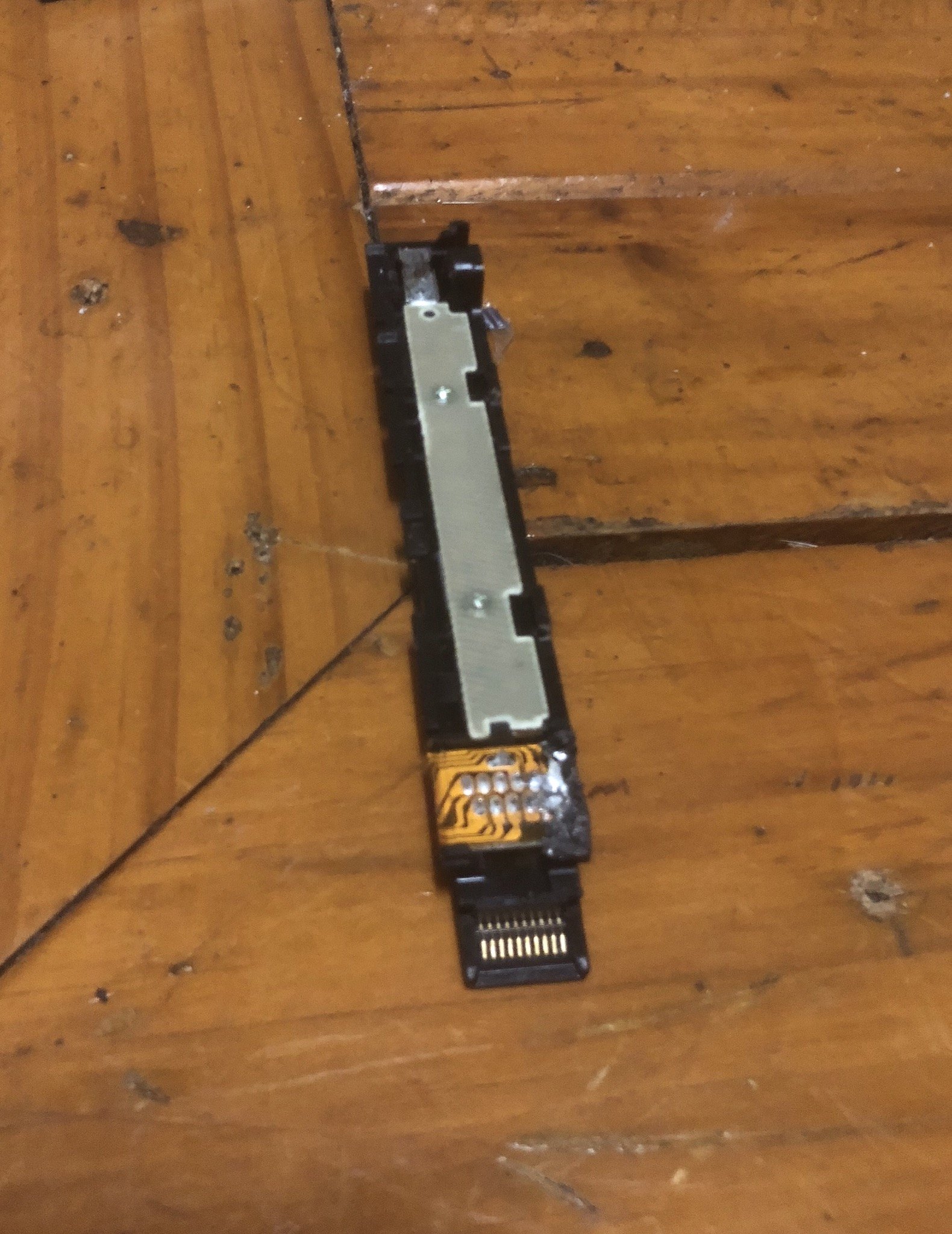

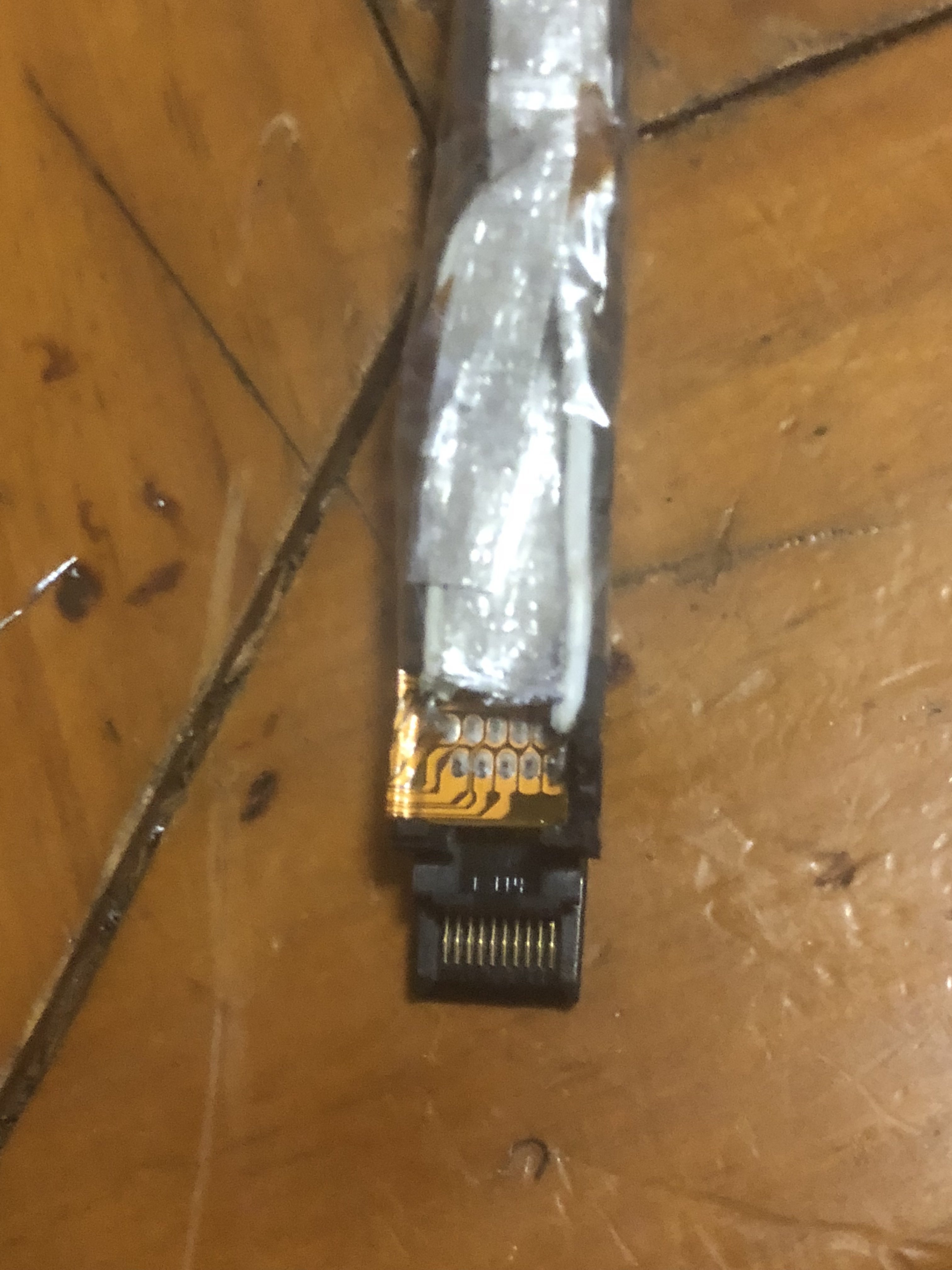

Sorry for Shit quality I used a joy con rail, just cut the ribbon cables off and soldered a piece of wire from the pin 1 to 10 points and than used industrial tape to keep the wire in place works 100% of the time

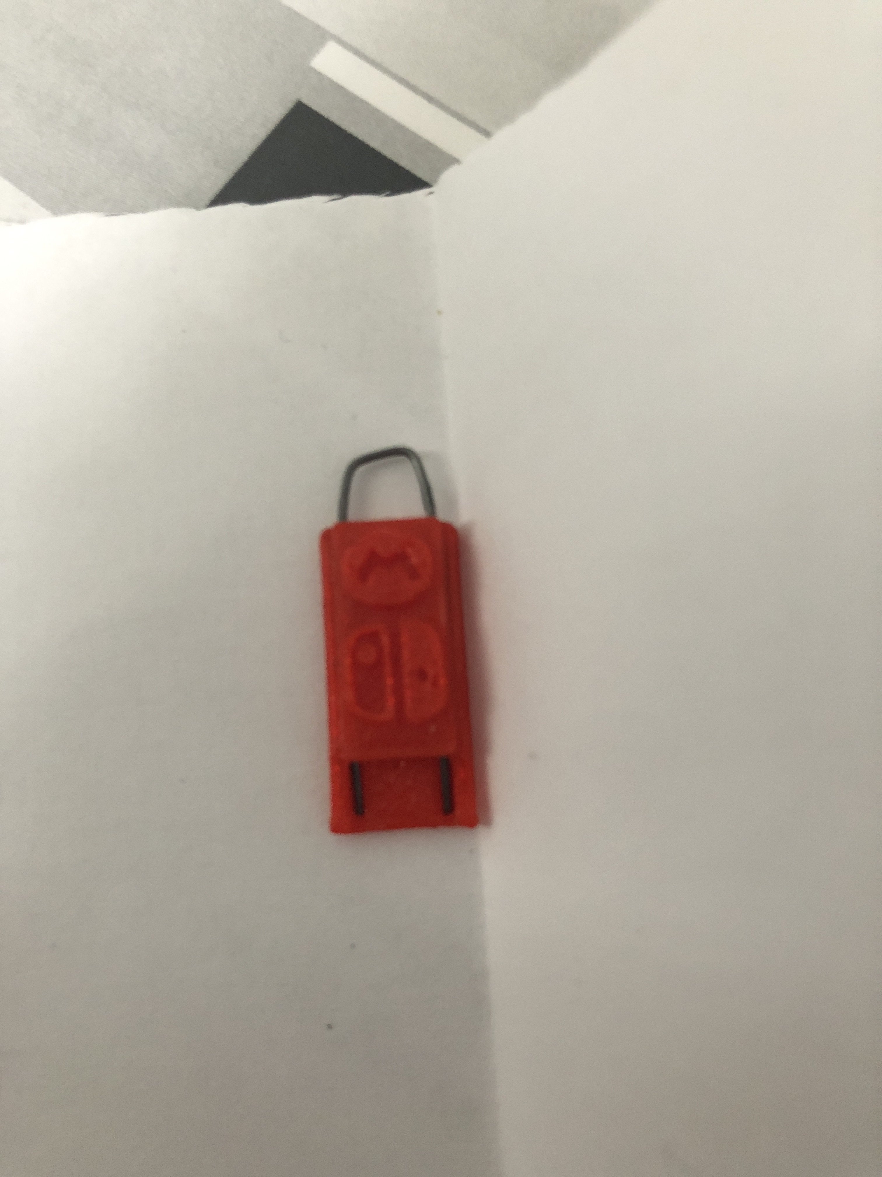

Got it off Ebay for just £3.50. I figured the keyring would make it easier to store.

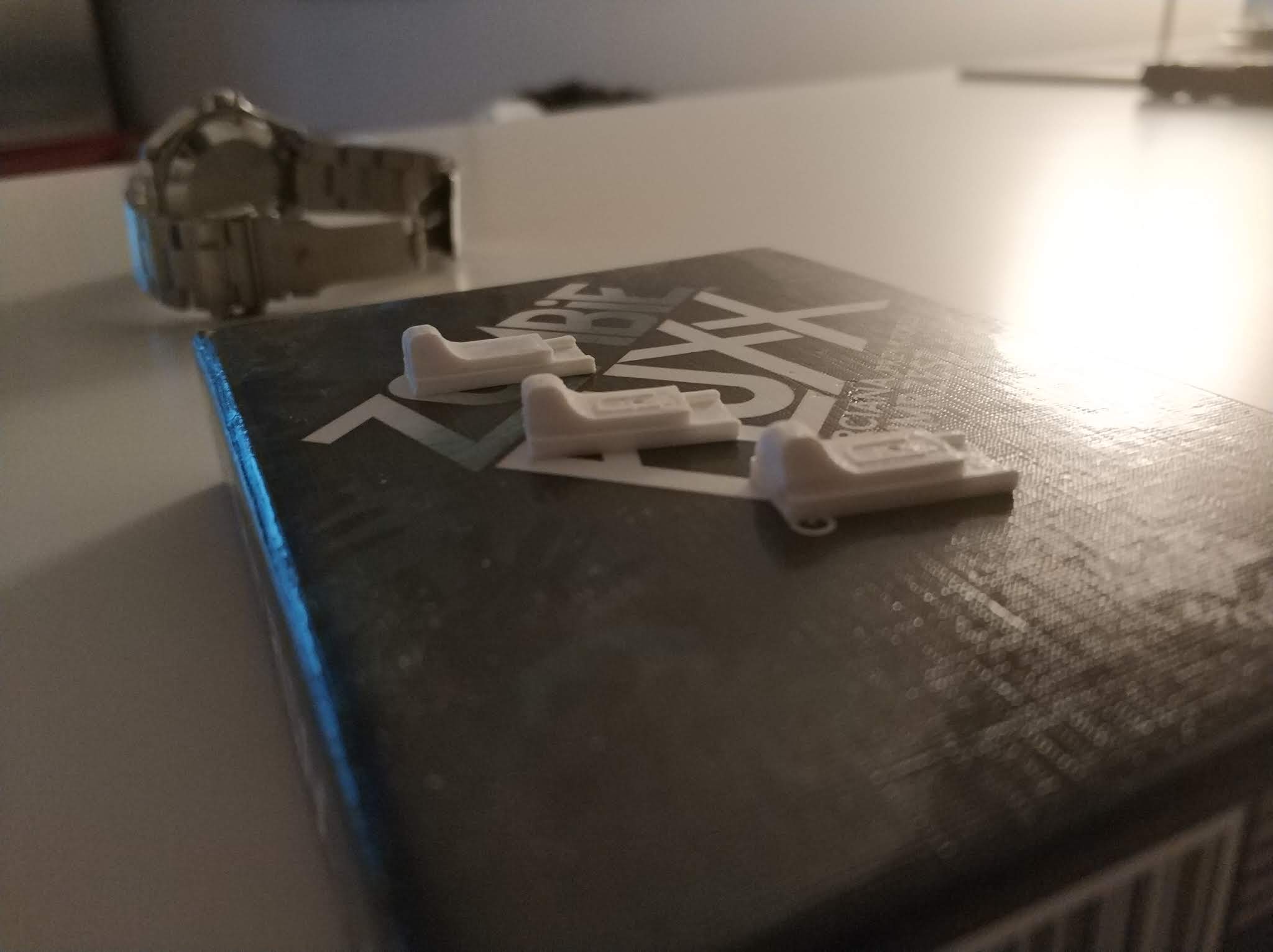

Also things like this is where I can see those little 3D printer things you get can be pretty lucrative. People are making a small fortune off these things.

I always thought a 3d printer would eventually pay for itself in the long term.......it did B-)
that said I think it was just a lucky run, I have had it for about a year and didn't really make anything from it (although I have made lots of little parts for myself)

Fuck! That would have been a lot easier lol, why also did you solder the pins than also
First I tried soldering the pins together which worked but I was worried that inserting the joycon over and over could damage the contacts on the switch itself as I felt it needed a bit more pressure to connect than when it was original.
So I just desoldered them with solder wick (which still left them shiny with solder but they are original now) and soldered the pins lile the picture.

I just took off everything and did your method works perfectly cheers bud

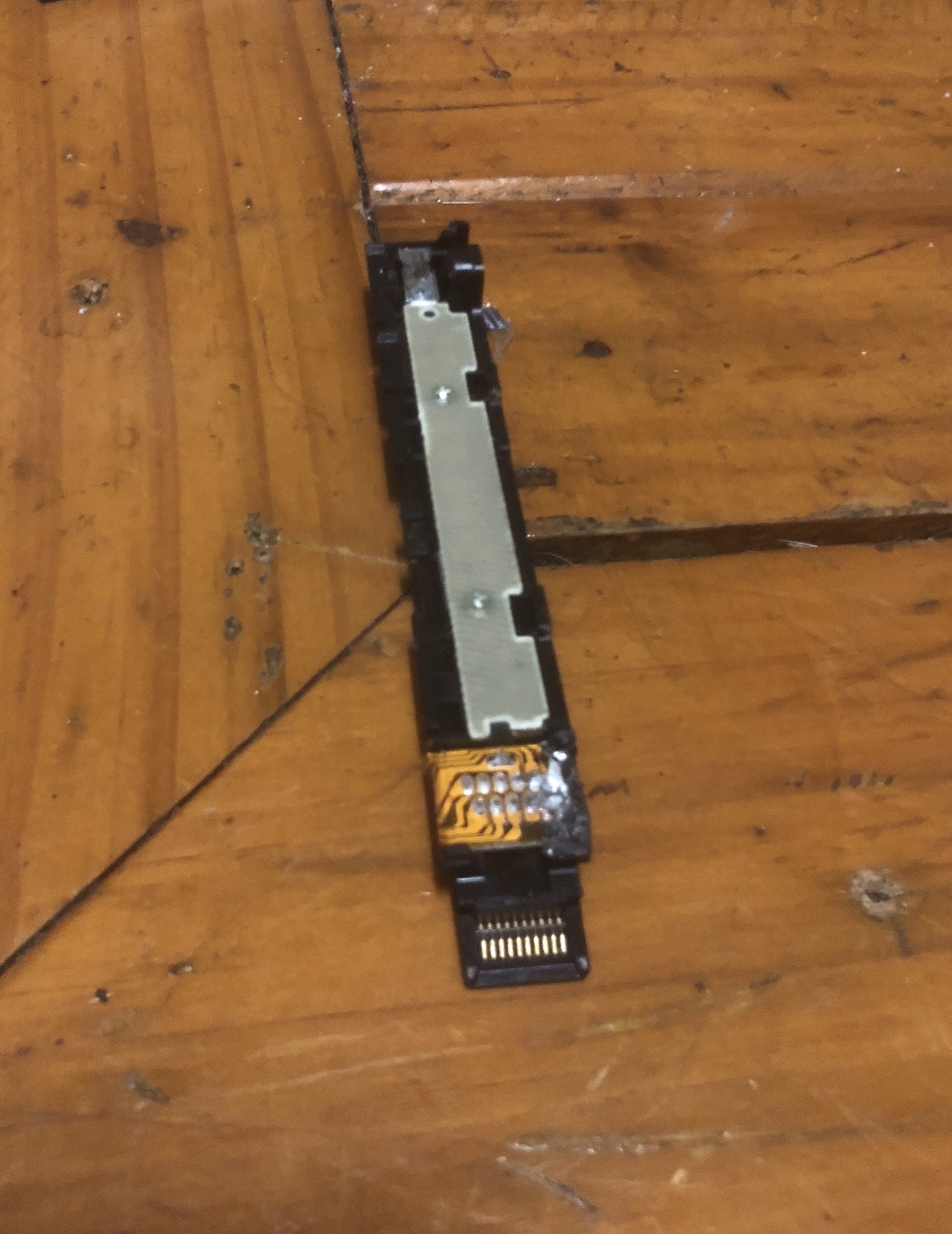

Nice, I like the idea of just the joycon rail, 100% safe on the pins in the console and easy as pie to do if you have a dead joycon or find a cheap pre owned one, I just use the rail because I’m keeping the carcus of the joycon for spare buttons, springs or screws all that type of shit if I ever need them
