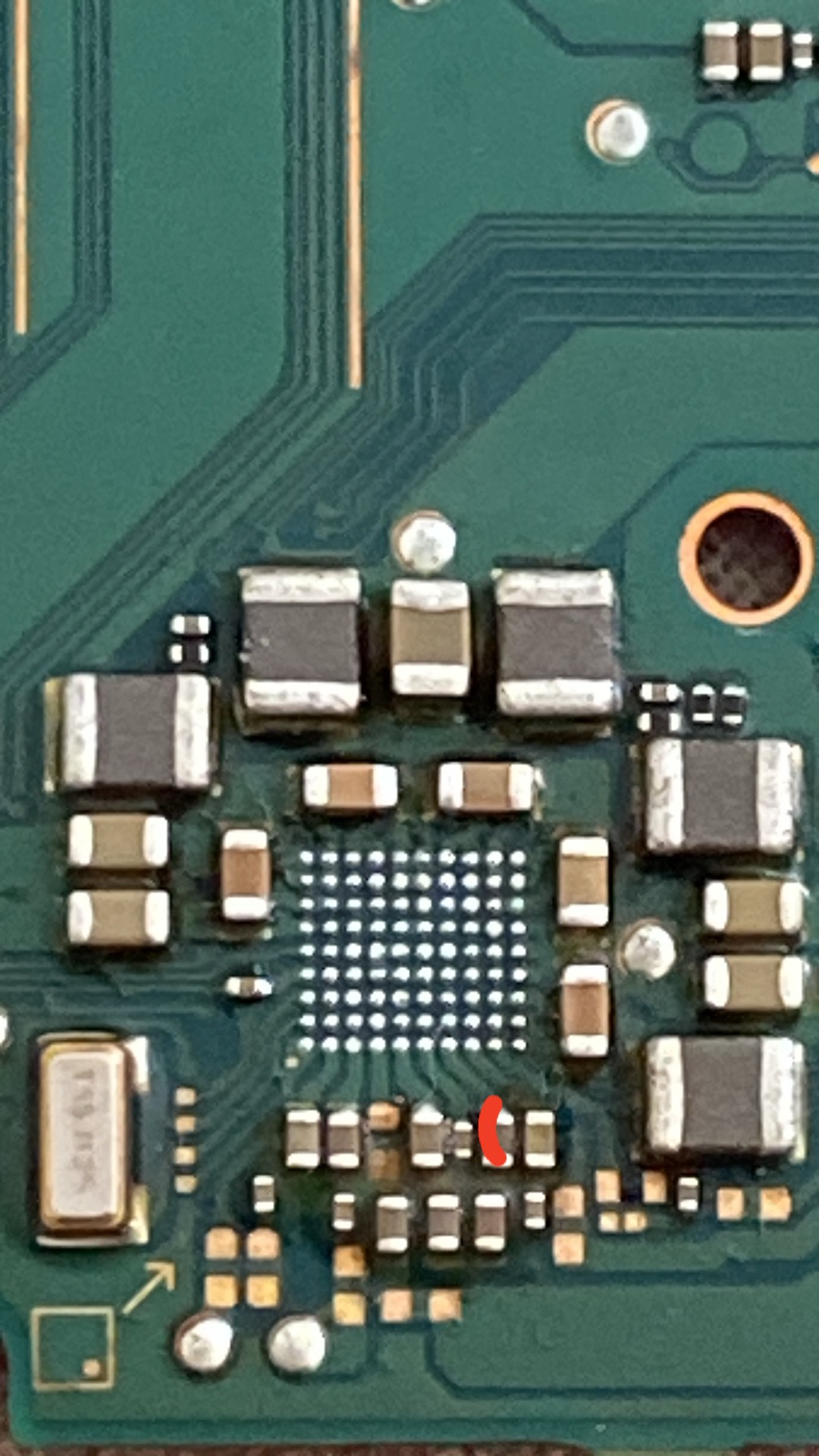

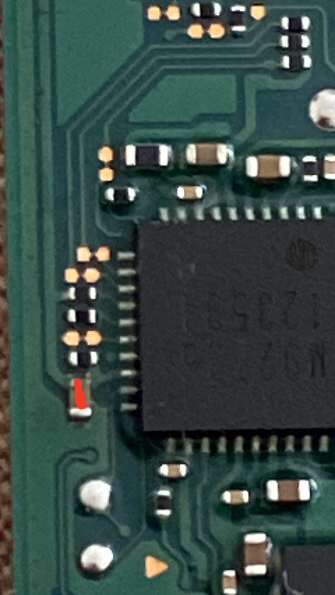

hello sorry to disturb your time, can i ask a question? I have an Oled Switch console whose there are a few short near M92 & Max77620H IC , and I have removed it from the console. I have tested to inject voltage from the cap on the shorted area, after that i feel the apu chip are heat up. Are those apu chip being broken so the switch cant be boot or turn on? Thank you for answering. Im really sorry if any word that i say is wrong, because i only use google translate for communication
On the right photo are max77620h ic which is have been removed it from board but the short is still there. And the doods i draw on the picture are the shorted caps
