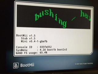

Bootmii as boot2v3.

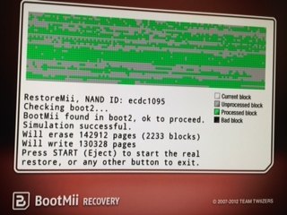

I have a nand backup from 06/25/2010, Wii still not working after a successful restore.

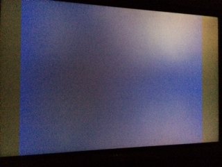

cfg_usbloader v70 loads and tries to load the game, but get black screen.

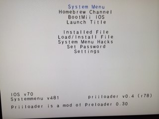

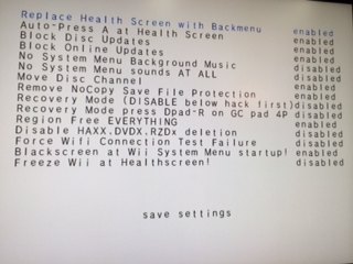

Does it boot to a black screen? or is the black screen happening when trying to run an app like cfg loader ext...?
If I remove the SD card, then it boots to the black screen. If I have SD card in the Wii then it books to bootmii or priiloader if I hold the reset button
cfg loader runs but when I try to play the game it black screens
All apps load

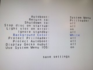

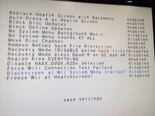

sorry I read your post wrong.
The boot to blackscreen was already turned off. I turned it on after reading your post wrong.
I've disabled it again but I still get the black screen
I would recommend turning off all your hacks right now and see what difference that makes.
I can remember modding wiis in the past and enabling some hacks and they actually turned on other hacks instead.
I have no idea then.

Removed modchip, but I still get a black screen. what do you suggest that I replace first the Bluetooth or wifi module?
Just got my Bluetooth Module in, replaced it, and it working now using the backup nand from 06/25/2010.

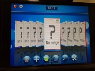

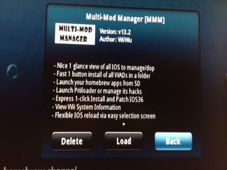

I spoke to soon. My disc drive is not working, it does not pull the disc in and when pushed in manually it does not spin. I think the disc drive was broken before it crashed but the Wii was working fine besides the fact that it could not play disc. Now the Wii boots up, but the shop, weather, news, mii, & internet channels don't work. The usb forwarder loads cfg, but when you try to start the game, I get a black screen and then the same error message. I formatted the Wii using the system format in the Wii settings, then rehacked. I've also formatted using the 4.1u-Nand_Formatter. I've also used ModMii to rehack it from 4.2u to 4.2u and reinstalled all the channels. I've also updated the Wii to 4.3u officially through the Wii rehacked it with ModMii. I'm still not able to play backed up games that I own. BootMii loads and works fine. The HomeBrew Channel loads and works fine. The MMM loads and works fine. Patching of ios 236 completes successfully. Prii loader also works fine. Since the disc drive isn't working, I'm going to install a 2TB 2.5" Hdd internally, if I can ever get it working.
