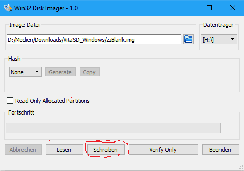

Your sd card will always be caught in a loop asking you to format it if you don't format it with Win32 Disk Imager and use the zzBlank.img. Also don't follow any guide that tells you to repeat the process with Yamt and changing ux0 to default again. You don't need that if you already have a backup of your files
To fix the issue you can follow this guide right here https://hackinformer.com/2017/07/29/properly-format-sd-sd2vita-adapter-set-vita/
Follow the steps. If you have a backup on your pc use that instead of using Vitashell and transferring the files via ftp because it's much slower than just directly copying the files you need
Also here's where you can download Win32 Disk Imager https://win32diskimager.org/ and here's where you can download zzBlank.img https://www.psx-place.com/resources/zzblank-img.941/
Also I will attach a screenshot to clarify which option you have to click on if your native language is neither German or English, since the screenshot is in German

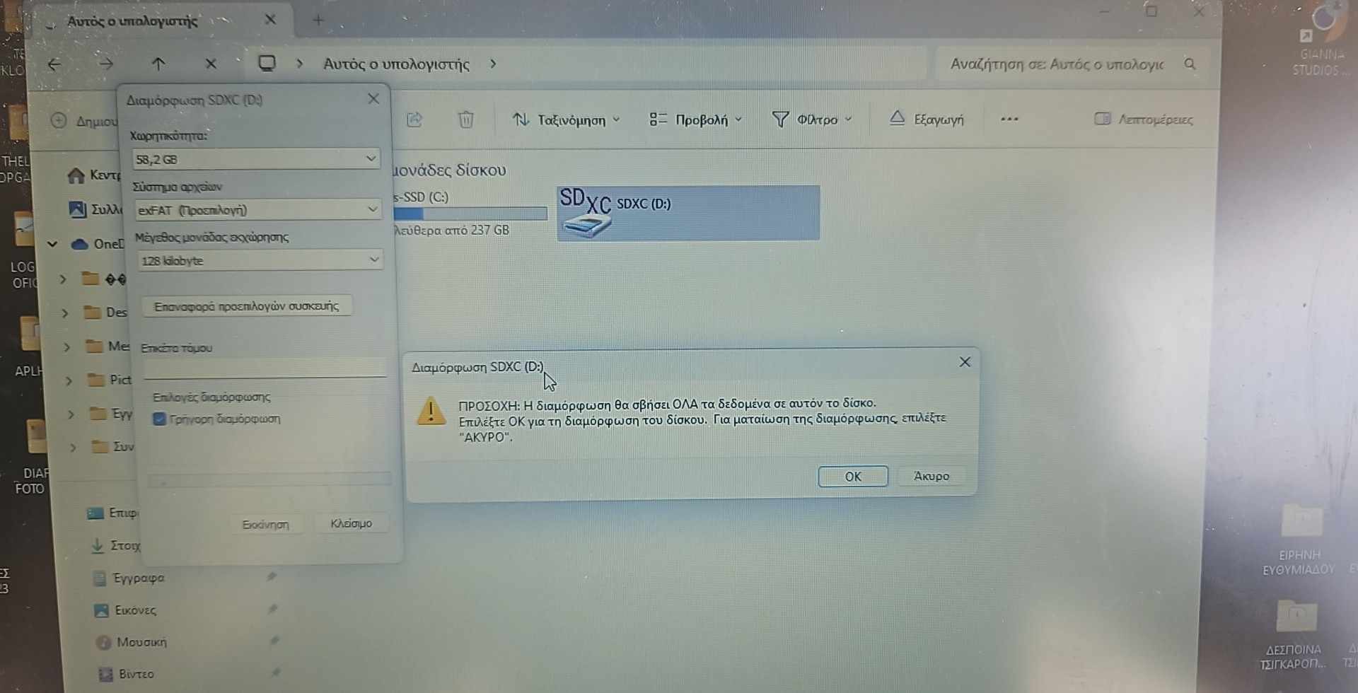

When I connect the sd card to the laptop it says that I need to set the sd card and that means a total format of the old one
It’s like when I plug the old sd card in the laptop, in order to open the files I need to set it and complete the top left box , then it says that if I do so , everything will be deleted . Should I just start the new card and download vitashell autoplugin and things ?
it would be better if you could copy the contents of the old one since some folders are ps vita specific. Can you use vitashell on the psvita? since you could set your ux0 to the vita memory card and copy the files from there using ftp.

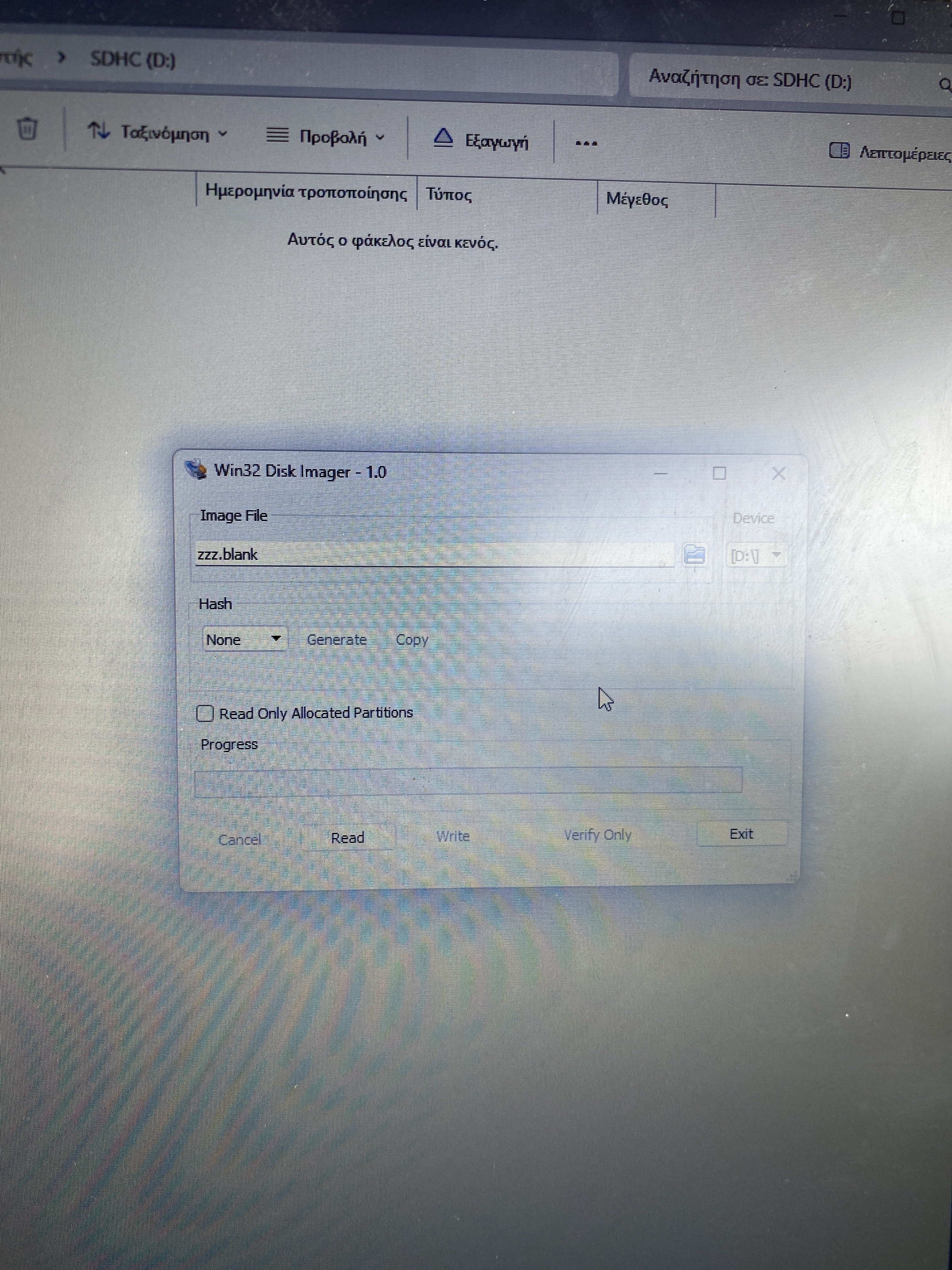

I have tried a brand new adapter and an older one of mine. Same thing happened with both . Now I am reading the zzz.blank in the new sd card and then I’ll format it. Then I suppose I have to install Vitashell, pkgj, autoplugin from scratch
