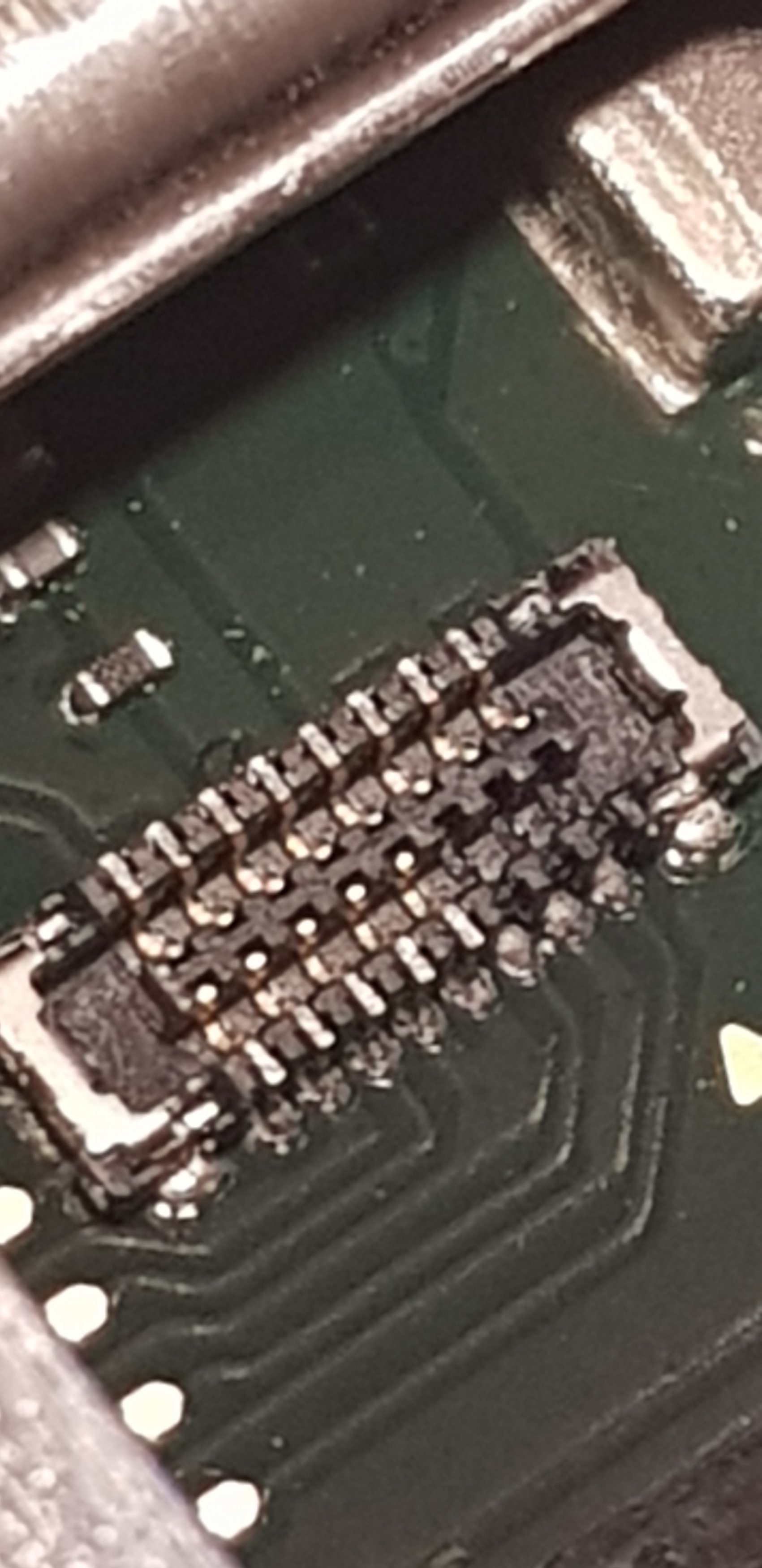

hi my sd reader no longer work, it's pins from the motherboard.

some pins are missing in the motherboard.
so it's over i can't fix that. too small to make something.

Sorry to hear yours died, it seems to be a design defect with the connector. Many, many people have had this happen. MOLEX 504208-1610 is the P/N, you can find at least one seller on Ali who did a listing for me if you want to try fixing it.
I'd talk with your local shops and see if they're set up for 0.4mm pitch SMD repair. It's not hard if you have the right tools - I've gotten the process down to about 15 minutes now thanks to a solder stencil I made.
I've uploaded pictures of the process, you can use them to get quotes from local shops if you like.
IMG_20200605_150945.jpg IMG_20200605_153725.jpg IMG_20200605_154507.jpg IMG_20200605_154956.jpg IMG_20200605_155306.jpg IMG_20200605_162835.jpg IMG_20200605_163004.jpg IMG_20200605_174652.jpg
