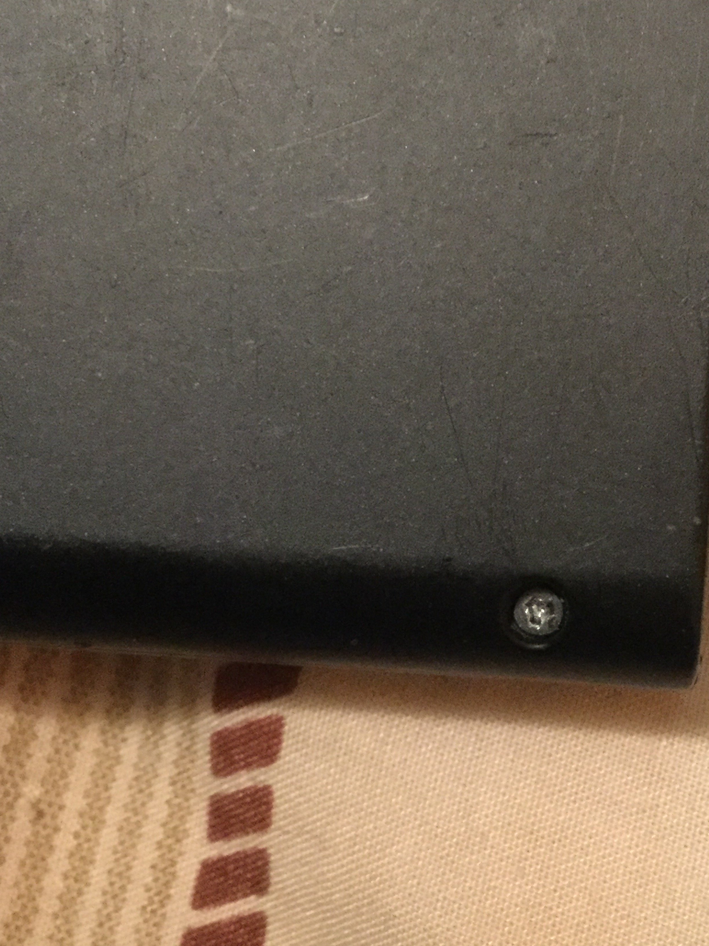

Any help for stripped screw?
Depending on how stripped they are, you needed high quality screw driver like the one I posted. If it is badly stripped you need an extractor bit in most case but Im not even sure if there one for these small screw. If it is heavy stripped you are probably screwed.
Uhh... From easiest to hardest, I'd try rubber band, superglue and soldering the screwdriver to the screw. If none of those work, then probably a tiny drill bit (never attempted this myself, take with a pinch of salt).
The last photo looks... screwed.
The Tri Wing one doesn't look that bad might need a Y0 probably not sure if Y00 would move it, the Philipp one probably not removable without extractor bit.
